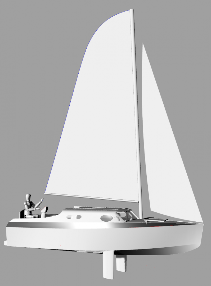

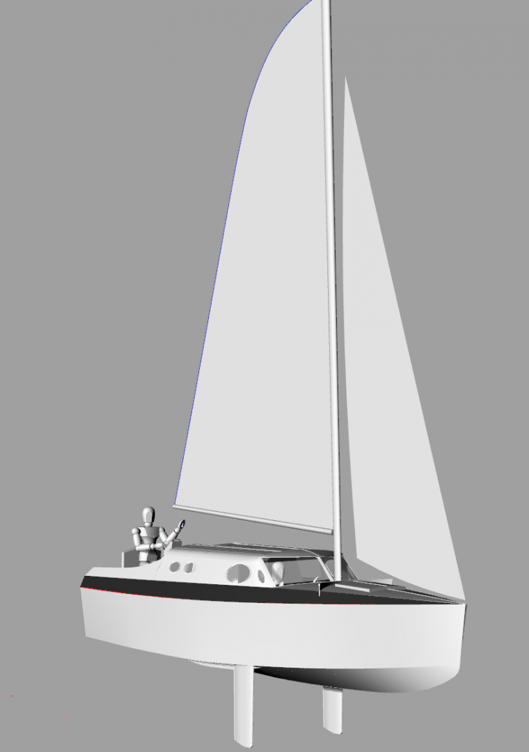

  7. rwatson
    Joined: Aug 2007
    Posts: 5,868
    Location: Tasmania,Australia
    rwatson Senior Member
    This is as far as I have gotten so far. My priorities were
    1) Self build - hard chine in ply
    2) Self tacking
    3) A true 20 knots under 70 hp OB, 28ft LOA
    4) Stern and Under cover nav station
    5) I went twin daggerboards to conserve interior room, but this is optional
    6) Water ballast and all the other features of the Mac 26

    Nice RW,it seems to be coming along pretty nicely, how did you model tests work out?
    How does that hard chine affect sailing performance?
