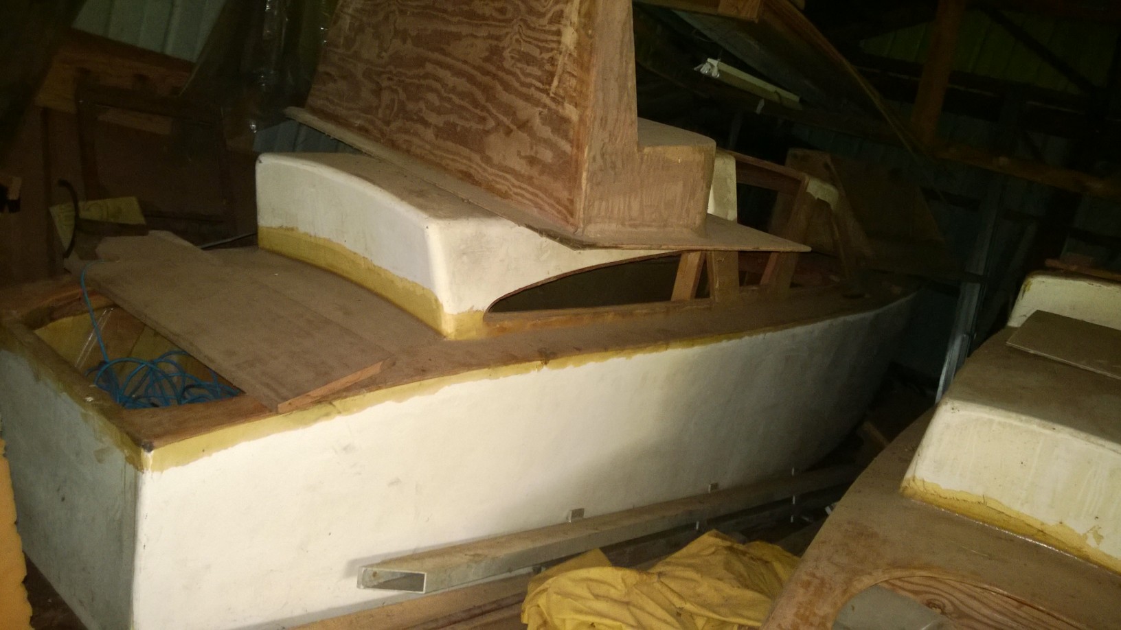

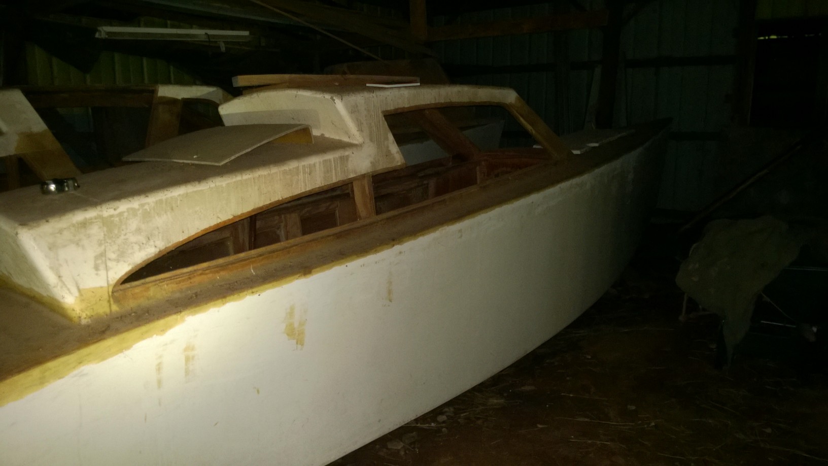

    I came across something rather interesting and I am trying to determine if I should look at this closer or not. I ran into the widow of a catamaran designer by the name of Richard Rogala. Has anyone ever heard of him or Richard's designs? Evidently his mark trademark designs were based around the idea of planing catamarans. It is an interesting concept, that his wife says he initially started designing while living out on the west coast, and continued to design after moving to the midwest. She showed be a few different catalogs from the 80's with his designs as well.
    Regardless, evidently her husband died about a year ago and she has one of his unfinished projects in her pole barn. It is a 24 footer, both hulls were done by some outfit in Canada, unfortunately I can't remember the name. They are glass over plywood construction. She also has the mast, and a ton of hardware, in fact much of the hardware needed to get it on the water. She also has plans for many of his different designs, from small 16 footers, to 40 footers and beyond.
    I think she would be willing to part with much of this stuff for a very reasonable price. I am trying to decide a few things:
    1) I have never seen a design like this on a cat. I feel like there is probably a reason why that is. Thoughts on this?
    2) It is worth me trying to acquire the designs for these boats? If I was able to acquire them reasonably enough, I would be willing to digitize them and make them freely available to others.
    This project is interesting to me because with minimal investment and time I could put this on the water. For playing with it, I don't really need to fit out the hulls, just join them, mount the mast and hardware already acquired by her husband, and get some sails for it.
    I have included an image of one of the articles on this boats, as well as some pictures of the hulls. I apologize for the poor images, the camera on my phone was being wonky when I went to take a look at this. Please let me know your thoughts!

    UpOnStands - Thanks for sharing those links, they confirm what I suspected of this sort of design. When I looked at it I immediately thought, well this could be fun, but it is definitely going to pound in a chop. The stability issues called out in the one article don't apply because no catamaran is coming back up from a capsize on its own anyway. It definitely seems to provide at least a few benefits namely roomier hulls, greater capacity, easy construction, and a potentially and exciting ride in some good wind. The question is how bad will it pound in a chop? It would be great to hear from someone who has built one of those flat bottomed Woods designs to get some real feedback.
    My understanding is that he was building this boat for himself and planed to use it for weekend sails on Lake Superior and Superior is fairly well known for having some fairly good chop. Although I don't know Mr. Rogala as a designer, you would think this would be something he would have considered especially if he was building this one for himself.
    I am tempted to just go for it and consider it a toy project, put to together without fitting out the hulls inside, and just sail it to see how the design performs. However at this point that would have to wait until spring, due to the fact that this far north sailing season is a few months off yet!

    There's a basic geometry issue with planing catamarans. The amount of planing lift that a hull creates is closely related to beam - the wider the hull, the greater the lift. A planing hull can be thought of as something akin to a wing (both create lift by directing flow downwards). When seen from the direction of flow, a 2' wide cat hull is similar to a rig that is only 2' high, so like a 2' high rig it's not very efficient. Because the cat hull is very long for its beam, it is also difficult to get it to take up the right angle of attack to the water to develop lift.
    Some of the modern small high performance cats have moved to semi-planing hulls, but they are still nothing like a flat-bottomed pure planing shape. The small boats also have the benefit of being affected by fore-and-aft movement of crew weight which is a significant factor in helping them semi-plane.
    Basically, this is an idea that has been tried and failing (in terms of being faster than a normal cat) for 50 years or more.

    I think the biggest issue with this design is going to be its performance in light winds. I took a look at some of the YouTube videos others posted, and this boat is so much different and so much more heavy, I think it is going to take a lot more to get it up to plane. There is just so much wetted area.
    If I remember correctly, the mast was 30', which is pretty stout for a 24' boat. I just wish I had been able to see the plans to see if it was supposed to have keels, dagger boards (didn't see slots for them), hydrofoils.
    With the hulls, mast, and miscellaneous hardware, what would something like this be worth? She didn't give me a price. It is worth considering?
