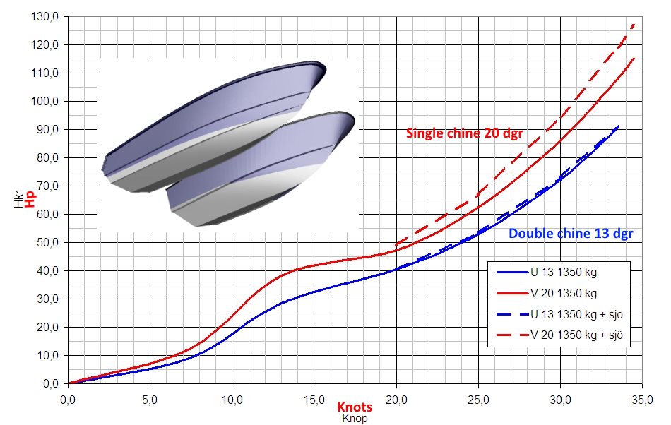

    Unfortunately I can't really understand most of the text. From the first graph, looks like the resistance curves intersect at about 27 knots, and from there the single chine has less resistance.

    Gonzo
    The attached file shows the required horsepower for the two boats compared.
    Both boats had the same weight and internal volume.
    This has been reported in detail in an earlier thread.

    HJS, that chart is quite interesting because even though it is a planing boat, but down at displacement speeds (say 5 knots or less) the double chine is indicating about 33% less power required.

    One is 13 degrees, the other 20. SO the difference is not just single vs double.

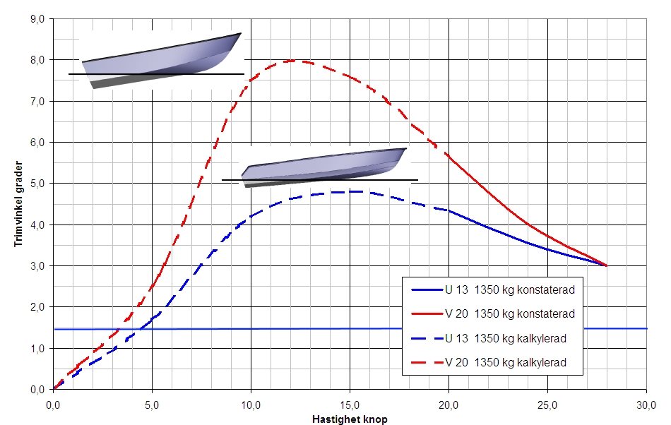

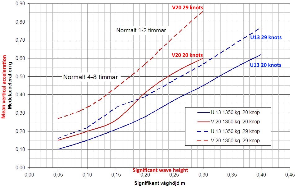

    The attached graphs show trim and the vertical acceleration in oncoming waves. The trim angle is measured in relation to the keel as both boats have 1.5 degrees inclination to be subtracted from the values shown. Both boats have the same internal volume, payload and the total weight.

    You have left out perhaps the most important parameters with your notes regarding these two hulls. Ie chine width and deadrise.
    The upper chine on the hull with the "twin" chines will probably not even be in contact with water as the water will leave the hull off the lower chine.
    You could add a couple of more chines above the lower chine and not see any change in drag
    What this graph clearly shows and is not relevant to this thread, is that with higher deadrise you get higher drag at planing speeds.
    Any drags differences due to the differences in deadrise at displacement speeds should also be ignored as the OP was asking a question about a displacement hull. Not a planing hull operating at displacement speeds
