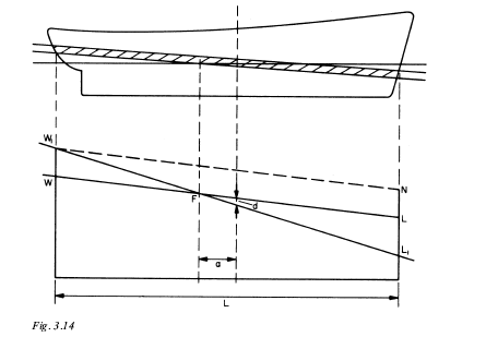

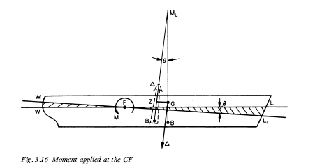

    It is important to note here that a boat that is highly 'stiff' in pitching will have a fast and large response to pitching in waves. This is the same as a boat with high initial stability (in roll) having a fast, uncomfortable roll speed.
    The reverse bow that you see in fast catamarans aims to reduce pitch stiffness, likely because it is high as a result of high prismatic coefficient*. Thus pitch response to waves is reduced which gives a smoother, faster ride in waves at the cost of increased risk of pitchpoling. Note that response to waves/external forces depends on the entire submerged shape, so both bow and stern (and everything in between) are relevant. The reverse bow still results in more submerged volume forward as the bow pitches down, just less than a flared bow.
    LCB can be used to find equilibrium pitch angle for a given pitching moment (forward force at some height) and LCG. LCF (for inclined waterplanes) can then be used to find change of angle for a given change of pitching moment.
    *I appreciate that this is a simplification

    I appreciate you are stating a simplification. However, it is overly simplified.
    You correctly state:
    So, where does a vessel get its high stiffness from??...its waterplane area.
    In a reverse bow, or dreadnought type bow, the waterline length of the floating DWL remains the same. Which mnas the waterplane inertia remains the same, which means the pitch stiffness remains the same; everything else remaining the same
    The only benefit, is the slight increase in waterline length.
    In addition, the dreadnought type bow is much finer at the extreme of the bow, which means it is relatively unaffected by a passing wave much more so than a conventional bow - assuming a minor wave amplitude and wave length less than vessel length. Only once the passing wave is in a region of higher reserve bouncy will the vessel start to respond. So it has the "appearance" of slicing or cutting through a wave, this is merely a result of minimal to zero buoyancy at the bow, that's all. It does not change the pitch stiffness, as the waterplane area remains unchanged - with all other factors remaining the same.
    The amount of added damping, when you calculate it and actually test it, is again, minimal to negligible.

    I disagree that the pitch stiffness remains the same. Waterplane inertia is a simplification that assumes the shape of the waterplane stays constant for small changes in (pitch) angle. Given that the effect of a reverse or raked bow is to change the shape of the waterplane as angle changes we need a more nuanced approach. Consider the shape of the newly immersed wedge as the bow tilts down (or a wave impinges on the bow):
    Thus for a given change in angle the raked bow will shift the LCB & LCF forwards more than the reverse bow, resulting in a greater restoring moment which we call stiffness.

    Not saying (theoretically) there is none. However, have you actually gone through the exercise of calculating the pitch-stiffness of the before and after hull forms in the conditions you cite?
    When you do, you'll realise, there is next to zero difference. This is also supported by endless tank testing.
    What we "feel" and "think", from what we understand about the theory side, is reduced to just that a nice elegant theory of the mechanics, but in reality, plays no part.
    Since the amount of actual buoyancy change in the fwd part of the bow is very small because the angle of entry is fine, hence how much actual real change in the WPA and ipso facto change in pitch stiffness is there, in terms of factual metrics.
    So when you do go through this exercise (as I have many teams in the past) you'll see the movement of the LCB/LCF in, situations like that which you post is .....yup very small indeed....so minor its contribution/change to the pitch stiffness is negligible. But please, for your own education, prove this to yourself.
    So, theoretically, yes one can argue there must be a change in the LCB/LCF owing to the change in shape, as there is, but this is not supported by the actual numbers of actual hull forms that adopt a change from normal to dreadnaught bow, noted above, under the same conditions, in percentage terms of a real cause and effect.
