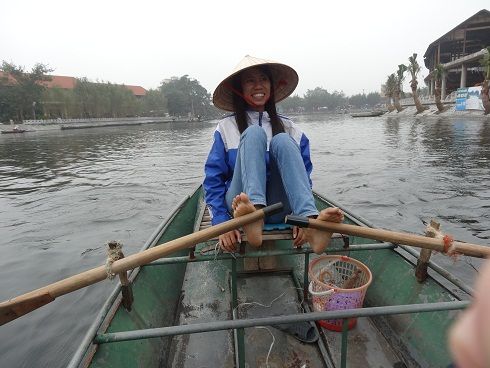

    Back to basic….
    Here comes another way for "pedal" power.
    At first glance, it looks to be very convenient and effective.
    Is there anyone here who has more technical data on what is most convenient, and how effective this option can be? Could it be developed further?
    Note that the oars settles automatically horizontally to reduce air resistance.
    https://www.youtube.com/watch?v=uyMMgOTc4wQ
    https://www.youtube.com/watch?v=uvU2f-t612o
