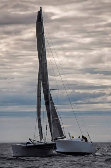

    A number of boats in the Race to Alaska had pedal drives, some attached to the Hobie fins, some to props. Other boats (like ours, see photo) had oars.
    There didn't seem to be any real advantage to any type, everyone moved at about 3 knots - 3.5mph for boats between 20 -38ft (I'm ignoring the small boats and Soggy Beavers). Our two rowers, on a 38ft 5000lb catamaran, overtook a Mirror 16, and rowed for over 6 miles nonstop. See here
    https://www.youtube.com/watch?v=_wzBkGRgn50
    But I believe the to-fro system is not as kind to the body as the cyclical system for long distances.

    This is an interesting use of oars. I enjoyed the youTube video.
    Thanks for posting.
