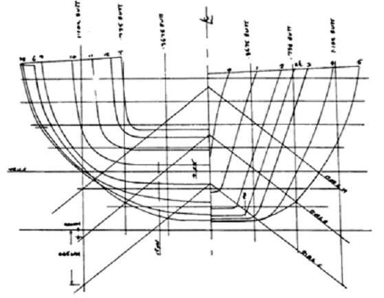

    The underbody looks more like a reactor or whiting 29. Paul did a lot of other designs apart from rating ton designs.

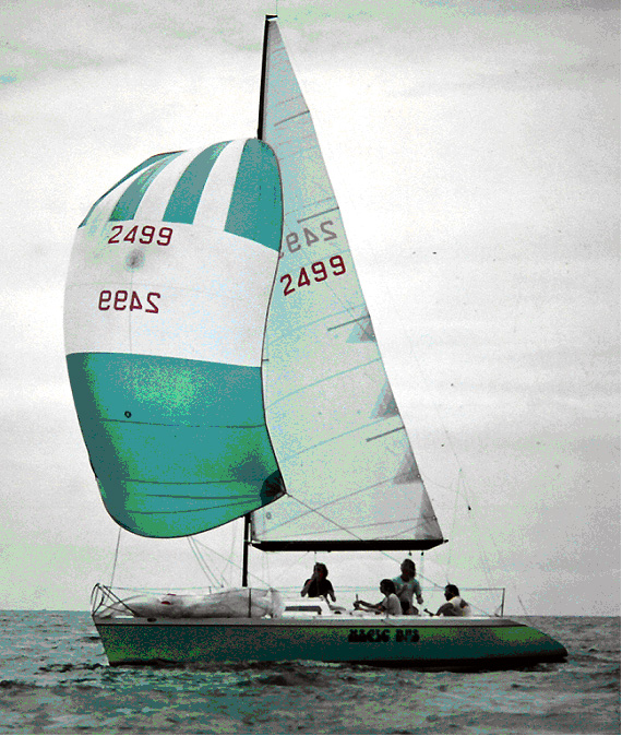

    Here's Magic Bus and then Newspaper Taxi - with typical Whiting distortions; don't think Dire Straights is a Whiting.
