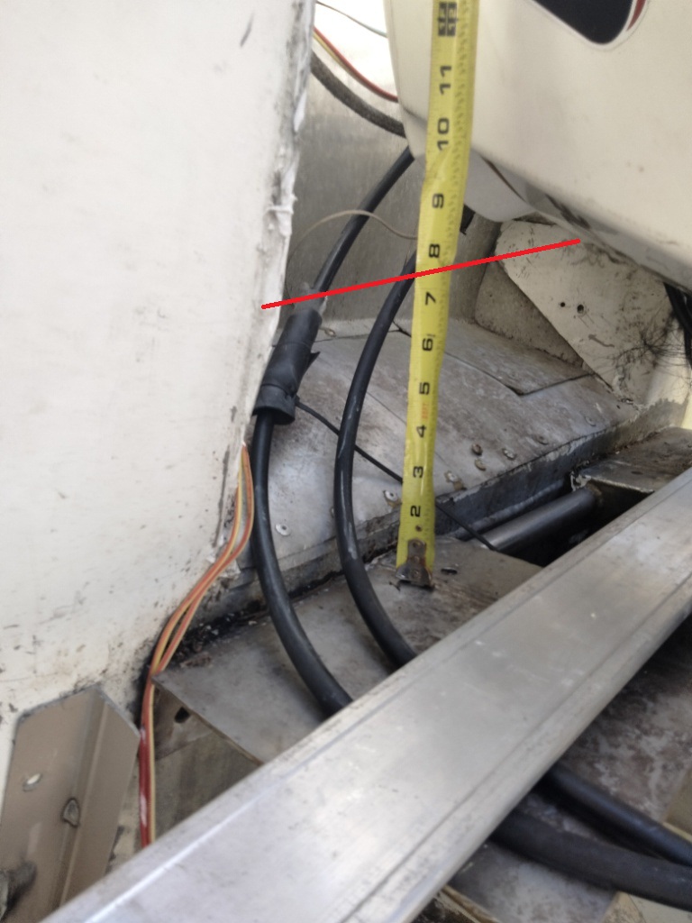

    heres all the Rot areas,would prefer to repair an procrastinate replacement
    1. all of perimeter couple inches inward except for under engine pod.
    Remember I had to reduce the thickness so the plywood would fit inside the flange, then just didn’t seal so this cut wood was exposed to moisture. Rot started at the ½” regular wood then spread to the marine. deterated around perimeter.jpg maybe I can drill small holes all around the perimitor an inject the penetrating epoxy? then extend the flange on both sides? extend the flange.jpg
    the original flange is just rivitoed to freeboard the bolted w/ 1/4" x2.25" stainless bolts I could add about 8" of flange then use 1/4" X3" stainless bolts.
    2.at each corner of splashwell what I did was cut stripes of orginal aluminim an bend into a bottom part of splaswell then cover w/ 5200 then fabbed some aluminin.
    This splashwell rot which is mainly the ½” of regular plywood outward.
    I’m considering drilling w/ a 3/8”X 18” wood bite outward to remove as much rot as I can reach.
    Then pour liquid transom Arjay 6011-Ceramic Pourable Compound Transom Putty-Cruise.
    Mite be a good idea to even drill out the not rotted ½” regular wood, would probably make the pour easier. Kindof like pouring inside the transom.
    inbetween the whats still good marine plywood. Then seal the wood w/ epoxy an seal the splashweel better I was actuely planning to have the splashwell welded but was concerned bc I used very thin 1/16” aluminum.orginal aluminum is 1/8”.
    Thanks for advising.

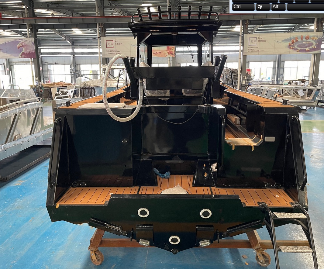

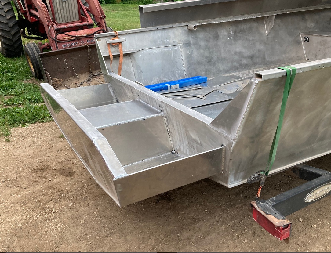

    the Starcraft is an economcal vessel not top of the line. the older Starcafts IMO are better than new aluminum pilot house types including Starcraft bc of the thin aluminum used most 22' hulls nowadays don't weight 1900LB they weight twice that BC the thin aluminum can't be welded. here's what I desire but mite be way more fabbing that I can handle bc I don't know how it is structurally made.I believe this is acutely a hull extension. talk me into fabbing this, if I only knew how there made the sides look easy. who knows this whole thing mite be easier than my new planned pod.
    home made version View attachment 201459 View attachment 201459 pod hull extension.jpg 1f746ab3af30a07314d41b04be77d456.jpg

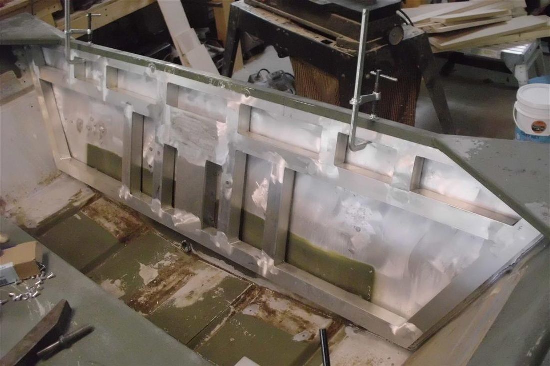

    I bet the transom is build like this under the skin

    Picture 1 : it could be done easy but with welded hull.
    Picture 2 : welded hull , as above.
    Picture 3 : transom reinforcement and specific starcraft build.
    alu transom reinforcement looking nice but your Starcraft as you said wasn't designed as a outboard boat setup.
    You need engine bracket and transom knee brace. My idea was to create all alu kneebrace-transom-outboardbracket in one piece.Most challenging part is matching the exact dimensions and shapes to existing flanges.First of all try to keep bottom shape straight.Hull extension is tempting riveting a new piece of hull, sounds simple.
