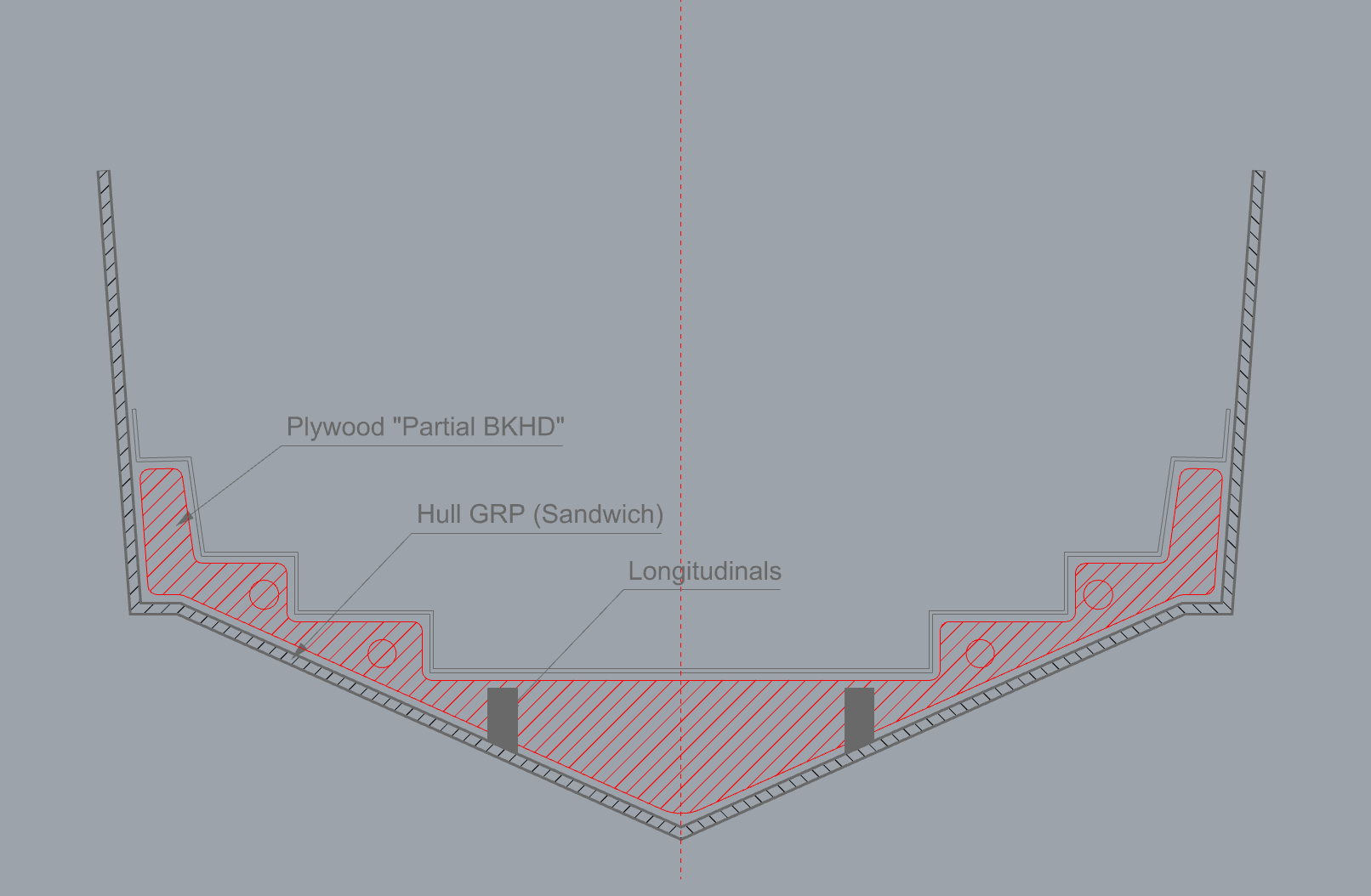

    Dear Boatdesigners,
    I am kindly asking for an advice someone experienced with ISO 12215-5.
    In the project I am working on at the moment it was decided to use plywood partial bulkheads as stffeners for Hull bottom and at the same time suport for Module line (as can be seen in the picture)
    Plywood partial bulkheads will be glued to the hull and overlaminated, then Hull liner will be glued to the patial bulkhead.
    My question is, how to calculate those partial bulkheads according to ISO 12215-5?
    I have seen some recommendations to calculate them as stiffeners, but since they are not consistent in height over some logical length (l/b > 5) I am not sure whether this is correct.
    Another suggestion was to caluclate it as watertight bulkhead, but it is not watertight.
    Finally I came across Caluse 9.3.4. Non- watertight or partial bulkheads; referring to anex A.13. It says that solid plywood partial bulkhead can be calculated using formula tb = 7,0 * Db.
    Could this be the best way to calculate it? In my case local heights from keel to sheer are about 2m giving bulkhead thickness around tb = 15mm; which seems not very strong to cope with slamming loadings on the bottom.
    Can anyone please comment on this.
    Sketch of typical "Partial bulkhead" is attached.
    Many thanks,
    Kind regards,
    Tom

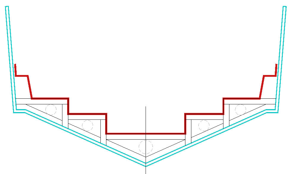

    In some section partial Bkhd looks like this

    The model in the attached figure is intended to suggest that these "bulkheads" (floors) could be calculated as if they were stiffeners subjected to the loads on the bottom or on the liner.

    Exactly, but then the positive influence of liner giving support to stiffener (and hull as a consequence) is left out.

    No, because you consider the floor as two independent stiffeners (two flat bars), the upper one with the corresponding attached liner plate and the lower one with the bottom attached plate. They are calculated as a normal deck cross beam and as a normal bottom frame. The width of the attached plates will be given by ISO 12215-5.

    I agree with that, but what about the beam rule that l/h must be bigger then 5?

    Sure, any reinforcement, real or simulated, should comply with the rules regarding reinforcement. But I think l/h> 5 cannot be correct.
    It is very important to take into account the position of the plywood layers in relation to the loads that it will bear. You must calculate them as edge plywood.

    Thank you for your very long and detailed answer. My mistake is that I haven't drawn in longitudinal structure. Of course, hierarchy exists. Boat is transversally framed with longitudinals being secondary. Some frames are GRP, some are overlaminated plywood (like the first sketch). But in some places, where frames were spaced to far away and where slamming loads occur, intercostal stiffeners are added transversaly (second sketch).
    I am not quite sure whether module liner sides in longitudinal direction can be assumed as higher order structure because the are not continuous. They appear only locally and cannot be assumed to be supported by other liner surfaces.
    My question is more in direction to find out what "partial bulkhead" in ISO 12215 means and where can this formula of tb=7*Db be applied. I have also tried using other methods like Gerrs Sn method, and according to his calculation plywood bulkhead thickness comes up similar to this equasion.
  12. ToMeK
    Joined: Nov 2006
    Posts: 43
    Likes: 3, Points: 8, Legacy Rep: 10
    Location: Zagreb, Croatia, Europe
    ToMeK Young naval architect
    Mixed type of framing has been employed here. Longitudinals are strong, but they span in between four strong frames or bkhds: Collison Bkhd, ER Bkhd, strong GRP frame thats in the middle and one plywood bkhd infront. Other structural members are transverse plywood and are intercostal.
    I know it is a bit confusing concept, but I joined the project in quite late stage where all other space reservations were made already but structure, so we were looking for solution that demands least changes in other arrangement.
    Attached is better sketched forward plywood bkhd that is supporting GRP longs

    What appears to be inferred from ISO Chapter 9.3.4 is that a partial bulkhead is a structural but not watertight bulkhead. Accordingly, the bulkhead should be calculated as a reinforcement. Therefore, the formula tb = 7.0 * Db cannot be applied to it, nor can any of the formulas in Table A.13.
    By the way Db is :
    Regarding what is said in 11.8.1, I cannot comment because in my copy of ISO 12215-5 I have not found that chapter. Sorry.
    Another very important thing to consider when calculating any element of a structure is how that element is working, and what loads and how loads are applied to it. Put simply, a bulkhead has loads perpendicular to its plane with a trapezoidal distribution, as a function of the height to the top of the bulkhead. A panel also works in a similar way, except for roof panels which have a more uniform load distribution. Both are calculated according to the thin plate theory, for a plate with its four recessed sides. A stiffener is calculated according to the theory of beams, with loads perpendicular to its longest dimension, subjected to bending and with both ends embedded. A pillar is calculated in compression, for example according to the Euler formula. Therefore, whatever the name we give to an element, its calculation will be made according to how it is working to help the resistance of the structure.
    After analyzing all the above, in my opinion, the partial, non-structural bulkhead that the OP shows us should be calculated as a stiffener.
