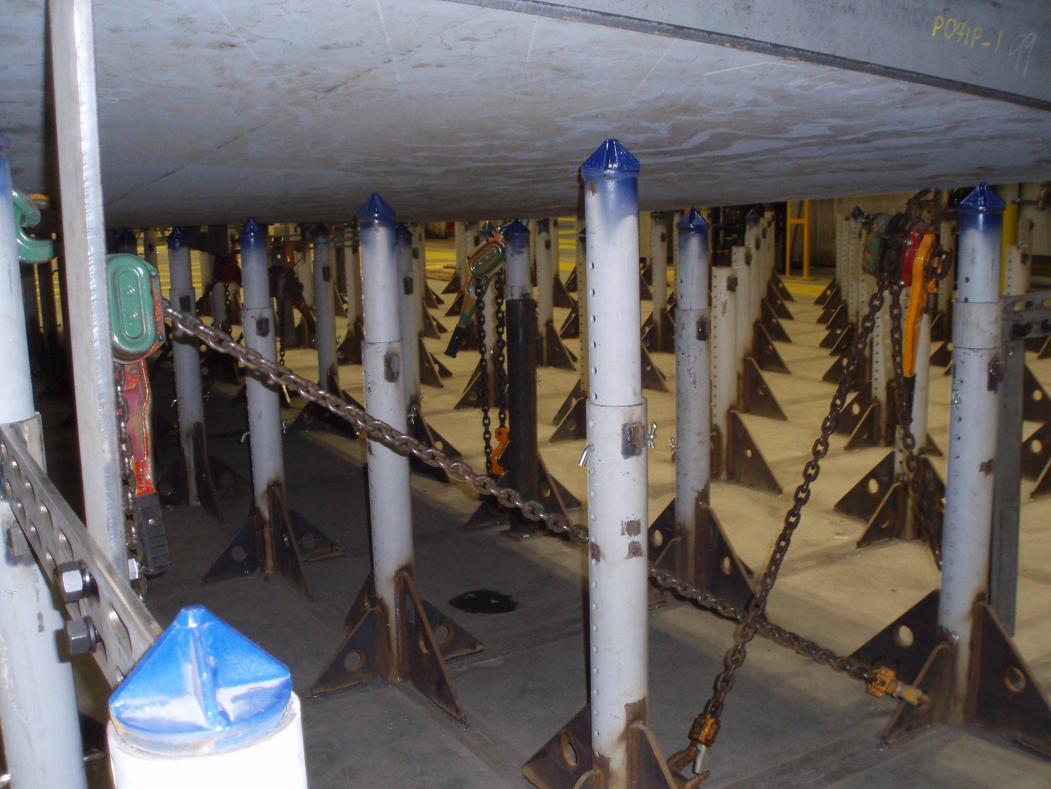

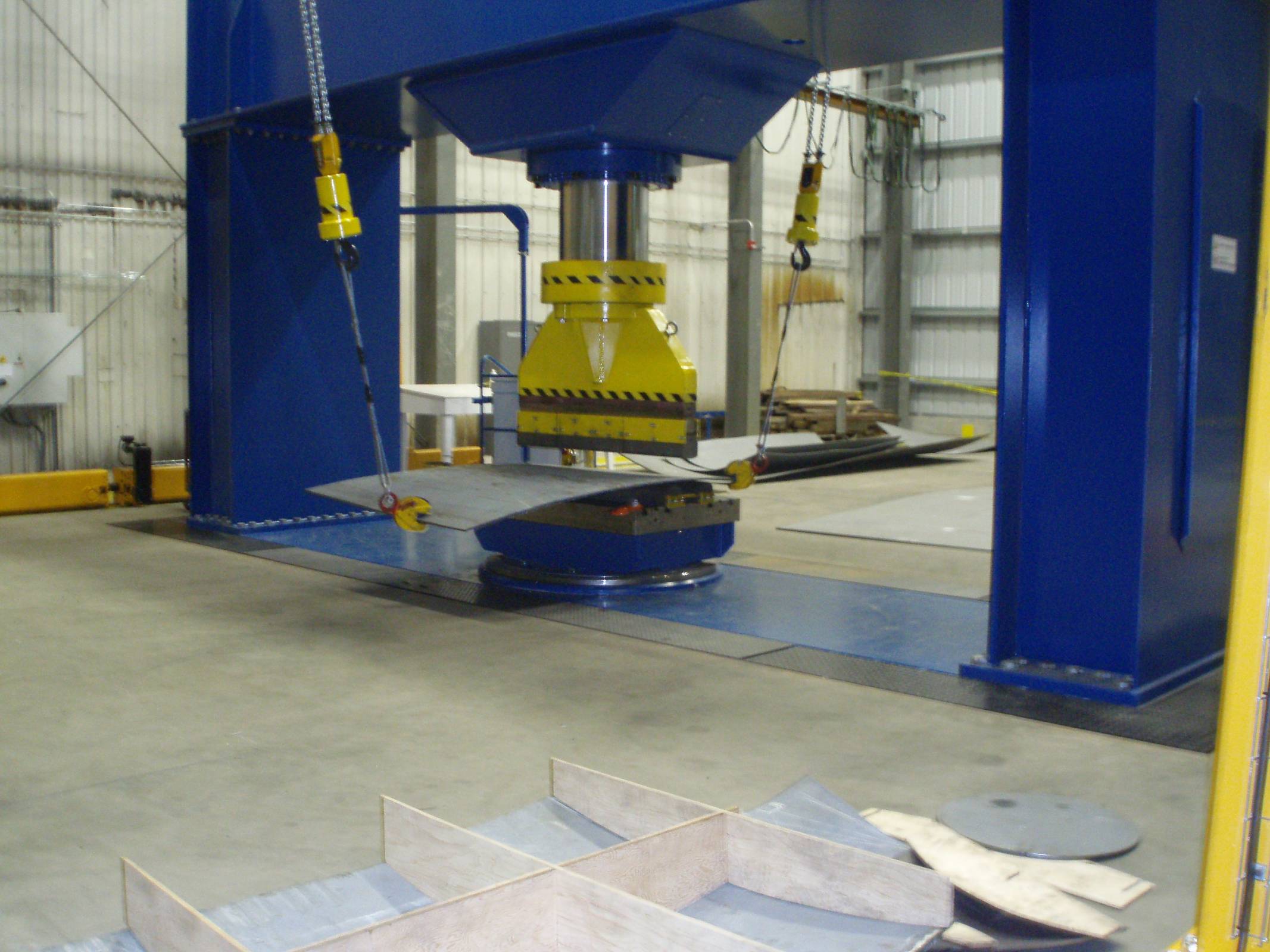

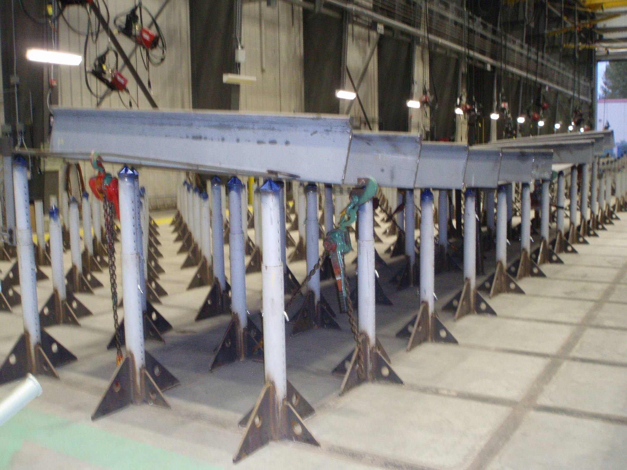

I was an apprentice SHIP,S Plater and was given time and experience in drawing office and loft. I was slow to catch on with shell development, but did end up as foreman in loft. the old-timers from world war taught me. i did Ms dos quick part , others abandoned my union for drawing office CAD training so loft was absorbed. we used to do all panel/bulkheads with length and height stick method my foreman finally changed to detailed sketches ,so fitters did layout with tape measure , we showed him what small ship shops were doing. i did one offshore supply vessel from offsets and design drawings . i did a large ice knife 3 part casting for ice breaker ,just from side profile and some section/waterline/buttock sketches no offsets for last 10 or 20 feet of hull at bow put out 3 views full-size and faired it in. see photos of VAN SHIP pin jigs I did pin heights off 10th scale loft scrieve years ago see new English wheel press for plate forming
