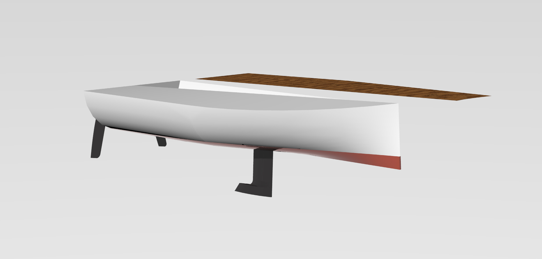

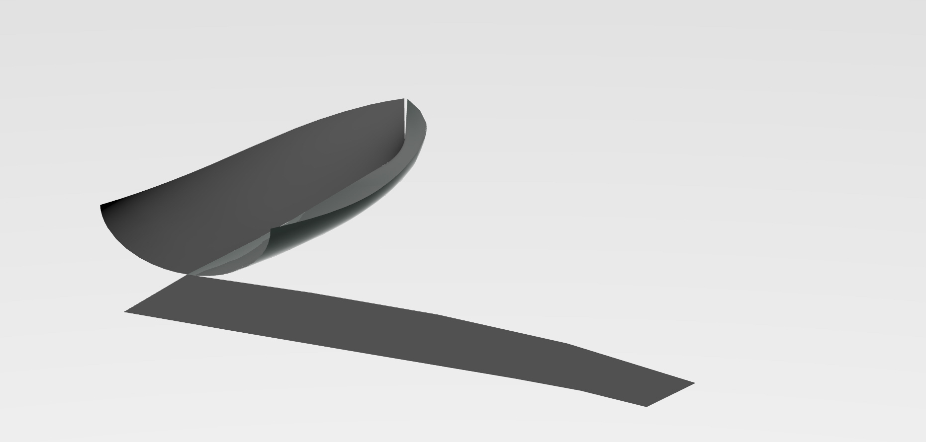

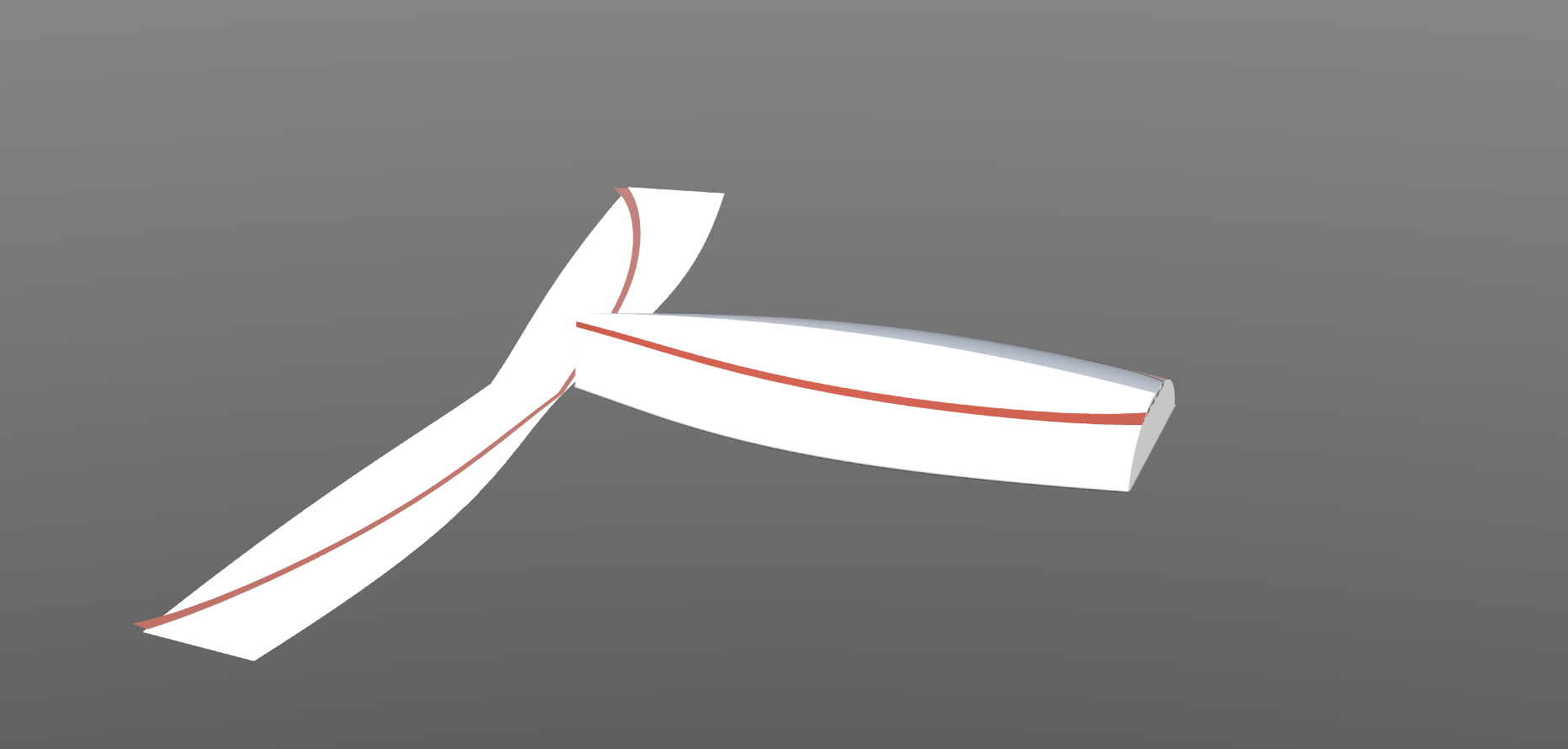

Unfolding panels.
Get Rhino.

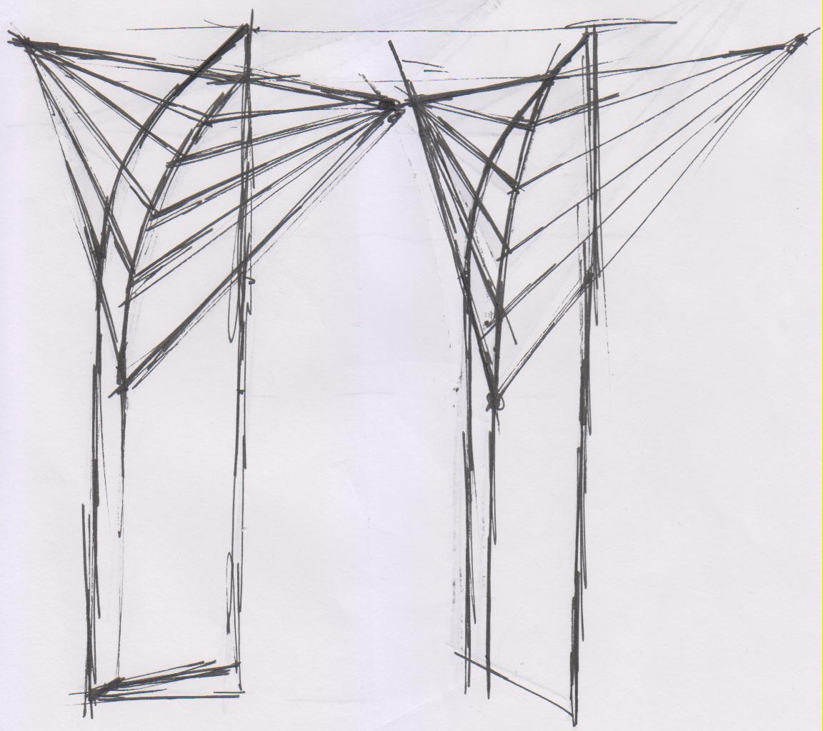

For "practical purposes" on a simple planing hull, you can easily go about your task once you have the chine more or less decided. You simply use that as the base to draw your generating lines to a point, one "cone" ( an oblique, non-circular one usually) for the bow topsides and one for the forefoot, with a common generator passing through the chine peak, can be sufficient. You just change the apex points of the cones to change, e.g., the shape of the forefoot, or the rake of the bow, till you get something you like. The very rough attached drawing should illustrate the general idea.

Good illustration Mr E. In practice it is the forefoot and lower bow area that is the hardest to resolve to get a good hydrodynamic form. A small amount of panel bow (transversly) may help and also in practice you can get a small bit of 3 D curve. Don't push the 3D though or the ply will split.
This is the simplest approach to a conic loft and may well work (I need to send some time in AutoCAD to know for sure). Teale, Kinney and Lord, to name a few, detail this approach in their books. This approach requires some trial and error to locate the apex (or in some cases multiple apexes). Also, it can only fit one of the lines exactly and you need to fiddle with the apex location to get the best match to the other line that you can. So the development drives the shape of one of the lines to make sure it lies on the conic surface. Having said that some nice shapes can be developed with this approach (see Kinney for example). Whether it will work for me, time will tell.
