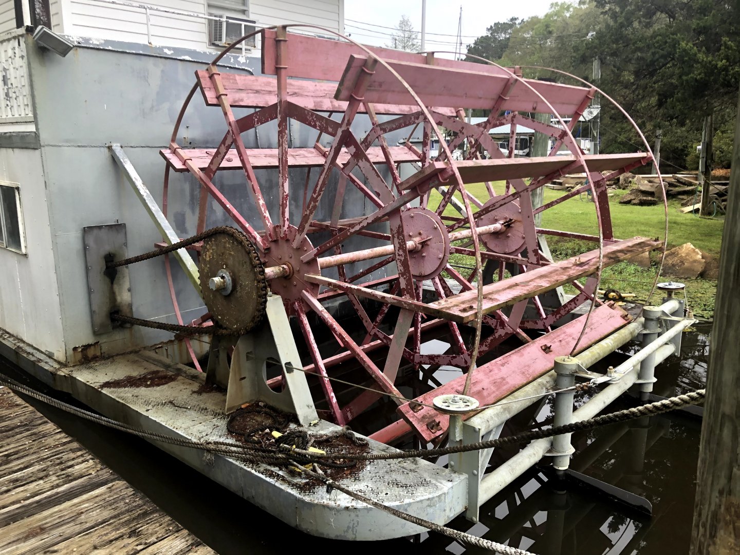

    I'm looking at purchasing a 1991 built paddlewheeler for restoration. There is a small but active group of enthusiasts who run these, but they don't have a forum and a lot of the knowledge is getting lost, so I'm casting a wide net.
    Typically these are built by first constructing a barge; typically 1/4" steel, then dropping an engine right on the stern. That goes to some kind of gearbox and final drive to the wheel, which is supported on outriggers. The machinery space is walled in using light gauge steel.

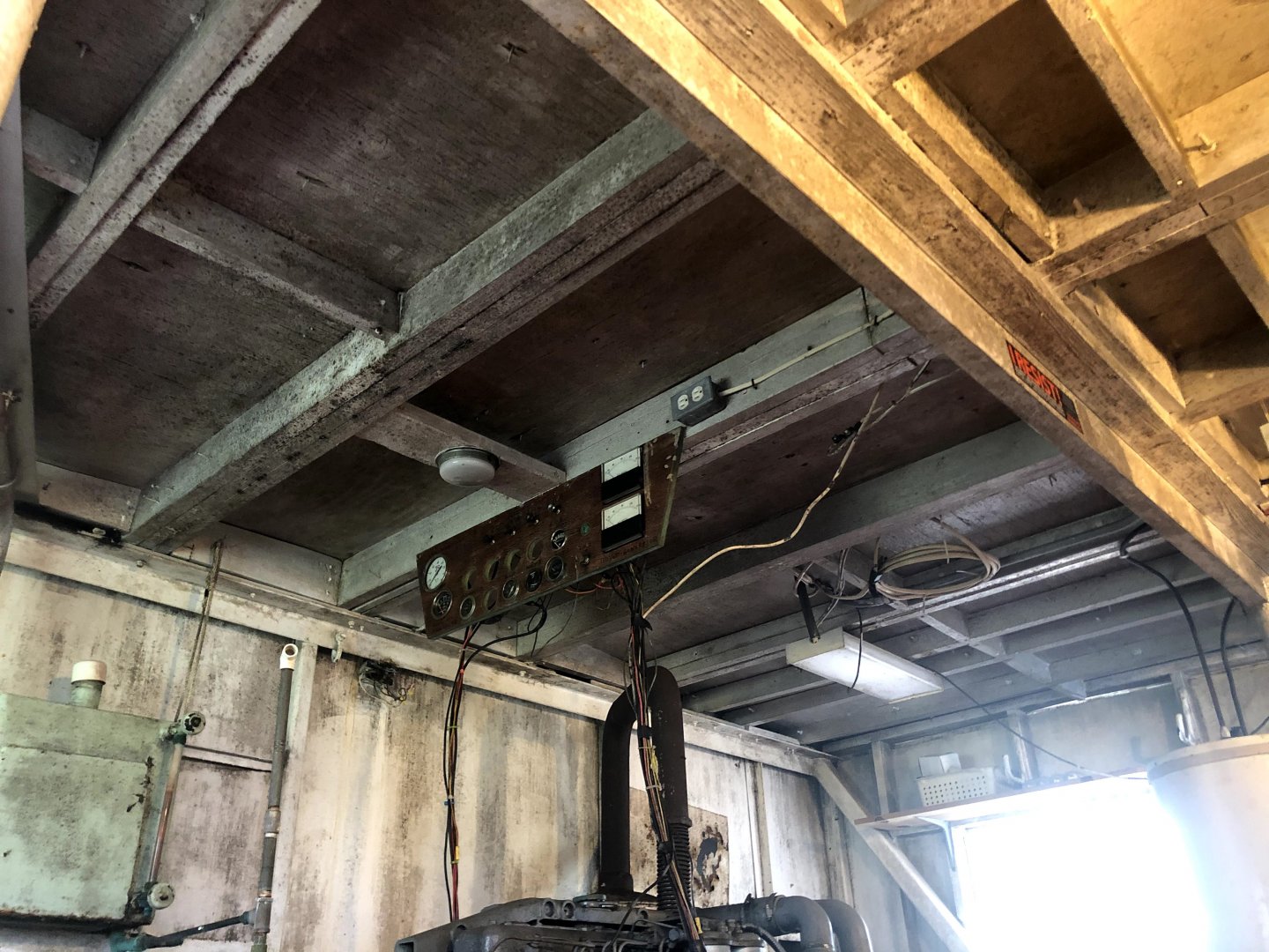

    Next the house is built using straight up 2x4 construction. This one is residential wiring but others use proper marine grade. The connection to the deck is bolted, then the frame is built. The deck 1 ceiling (which is deck 2's, er, deck) is fiberglassed plywood. The second deck exterior walkway is a single sheet of 3/4" that is glassed and supported with the metal uprights. The ceiling joists are 3 x 2x4's bolted together. Then the second story roof is another sheet of glassed ply.

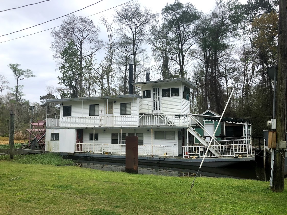

    I've attached some pictures for reference; primarily of the house and anywhere I could see how it was constructed. There is an example of the joists and of the fiberglass deck connection. I have a bunch of the engine room as well if anyone is interested.

    The framing details are confusing, why would the floor joists be grouped together in threes instead of evenly spaced?
    Then the supporting beam is less robust than the joists it supports?
    That exposed exhaust riser must make a wonderful wintertime engine room heater, but what about summertime?
    The gauge panel needs to be located in the pilothouse where it can be monitored.

    The beams are also grouped 2x4's. The idea I think was to keep the height down, so there are no 2x10's used.
    There are gauges on the bridge, and I agree it would get hot in the engine room but I don't think you'd be there much when steaming. And she'd be tied up on shore power a lot of the time.

    You don't show any photos of the layout or construction of the second deck, if you were to load up the roof, you'd want some roof support and lateral support to keep that structure from racking and collapsing.
    Stability would be a big question, having a big dynamic load up that high would be a wonder. You might want to go here to ask about stability Stability https://www.boatdesign.net/forums/stability/ . Having the whole pilot house on that deck would look bad to me, kind of like a backyard shed for the mower and stuff tacked on the top deck.

    I've attached a picture of a triple-decker to give an idea of how it would look.
    I don't have any pics of the second deck construction, as it was all buttoned up. I would definitely shore everything up; just looking for some input here as to how to go about it and things to consider.
    Regarding stability, the wheelhouse would only be elevated about 4 feet. The greater concern would be variable load on the top deck running back and forth. I need to get some further dimensional details then will run the numbers. I'm a Master Mariner so am well versed in stability calculations.

    Thanks! That's the Princess Margy, but is just an example. The boat I'm looking at is the Pelican, pictured in the top post. As I'd be taking it back to stud (or further) I'm looking at potentially raising the wheelhouse all the way up to the third level.
