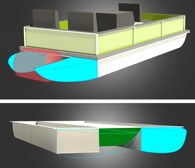

    Looks like the original doesn't have enough Water Plane Area (WPA) for its intended load. What this means is that the hulls sink too much with added weight, which can be a simple weight shift, from one hull to the other. This is what's causing your stability problem.
    Two possible remedies:
    1.) make the two hulls a little wider, leaving one propeller diameter distance between the hulls, and tapering the inner side of each hull outward about 3 in(7.6 cm) (this tapered protion would be about 1 ft (31 cm long)), or
    2.) make the center hull nothing more than an enclosing of the space between the two hulls, but with the stern end of this enclosing rising up to the Waterline (WL) height, at a 1:4 (rise over run) taper. This will leave a short tunnel at the rear of the boat only, so water can get to the propeller.
    In your original post, you said this boat was to be 6 ft wide. How wide are the hulls? It looks to me that they are only about 2 ft wide (61 cm), if even that. What's the propeller diameter?
    Both solutions would allow water to get to the propeller, while increasing the WPA, which will make the boat much more stable. The 2nd solution would add more buoyancy to the bow than the stern, so might the boat to trim bow up, more than originally.

  5. daiquiri
    Joined: May 2004
    Posts: 5,373
    Since the overall length of the boat is going to increase anyways with that drive, you might make the whole boat more performant by streamlining the aft part of pontoons, like this:
    The aft pontoon tails (blue) would serve as structural support for the wheel, while the central hull addition (green) would be shaped in order to give the required missing buoyancy and minimize the turbulence of the inflow to the wheel.
    Just my thought, of course.
    Cheers
