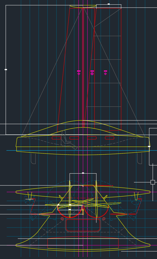

    It has come to my attention that as the aspect ratio of a foil is reduced the center of pressure moves forward relative to the 25% chord for a high aspect foil. Here is one of the papers that led me to this conclusion: https://eprints.soton.ac.uk/43260/1/001-78new.pdf
    I'm really not sure what exactly is considered a low aspect ratio. My planned single element wing sails will have an ar of 2.5, rudders and keels an ar 0f 2; all will be naca 0018. The plan was to have the pivot point at 18% of chord, but after reading up more my decision on balance point is being called into question. I'd like to achieve as close to fully balanced as possible with zero risk of overbalancing in any circumstance(high speed, various angles of attack), and maintain a self-feathering characteristic.
    Am I safe sticking to the 18% pivot point?

    So the rudders and keels on my design are surface piercing, for both simplicity and so they can kick up, as I will be doing much of my sailing in very shallow water. They will be rectangular, no sweep or taper.
    The more I look into this the more complicated it seems. Here is what I have learned from further research since I posted this thread and read your replies. Amazing how much of a difference search terms can make in finding relevant material.
    The aspect ratio has a profound effect on the angle at which a given amount of lift is developed. I knew this before but did not know just how great the difference was. It seems that above ar 4 the difference is minimal as ar increases, 3 is modest but below that the angles get pretty extreme. I imagine this plays a big role in how much drag is created for a given amount of lift. But is more gradual development of lift with rudder angle a good thing? Would a high ar rudder be twitchy? Is lower susceptibility to stall with low ar that important?
    One paper states: Naca oo12-0015 cp location; ar 1-2 = 12%, ar 2-3 = 18%, ar 3+ = 22%. Recommends balance points of 11%, 17%, 21% respectively. I imagine this is more of a spectrum in reality.
    Effective aspect ratio for surface piercing rudders? A couple papers indicate that the free surface acts to "mirror" thus double the effective aspect ratio at low speeds, but at higher speeds it acts as true to its geometric aspect ratio. I believe the froude numbers referenced were .3 and .8. Because of this it seems prudent to plan for using the geometric aspect ratio as the design criteria for choosing the balance point to avoid loss of control at high speeds, such as when surfing down the face of a wave.
    It seems that higher ar foil would be less susceptible to ventilation. This begs the question: How much of a problem is ventilation with surface piercing foils?
    Am I interpreting all this correctly? What else should i be considering?

    It seems that my original plan is tenable and prudent based on the information and opinions you have provided, and other research. I think I'll stick with the plan for the 2 ar, 18%. I think adding the fences would be a good idea, would only be a minor increase in drag.
    Yes, in all my research it seems that the rectangular foils are not far off in efficiency from other forms, and have better stall characteristics.
