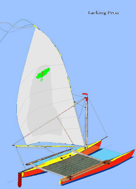

    Well, the project is nigh finished, if a sailboat is ever finished. This is sort of an update, but fresh, as the other threads have gone too long to continue.
    Refresh...boat is sort of a mix of White's Dragonfly, and Willison's once popular Malibu Outrigger, using recycled Hobie Cat 18 port hull and Hobie Cat 16 Starboard hull.

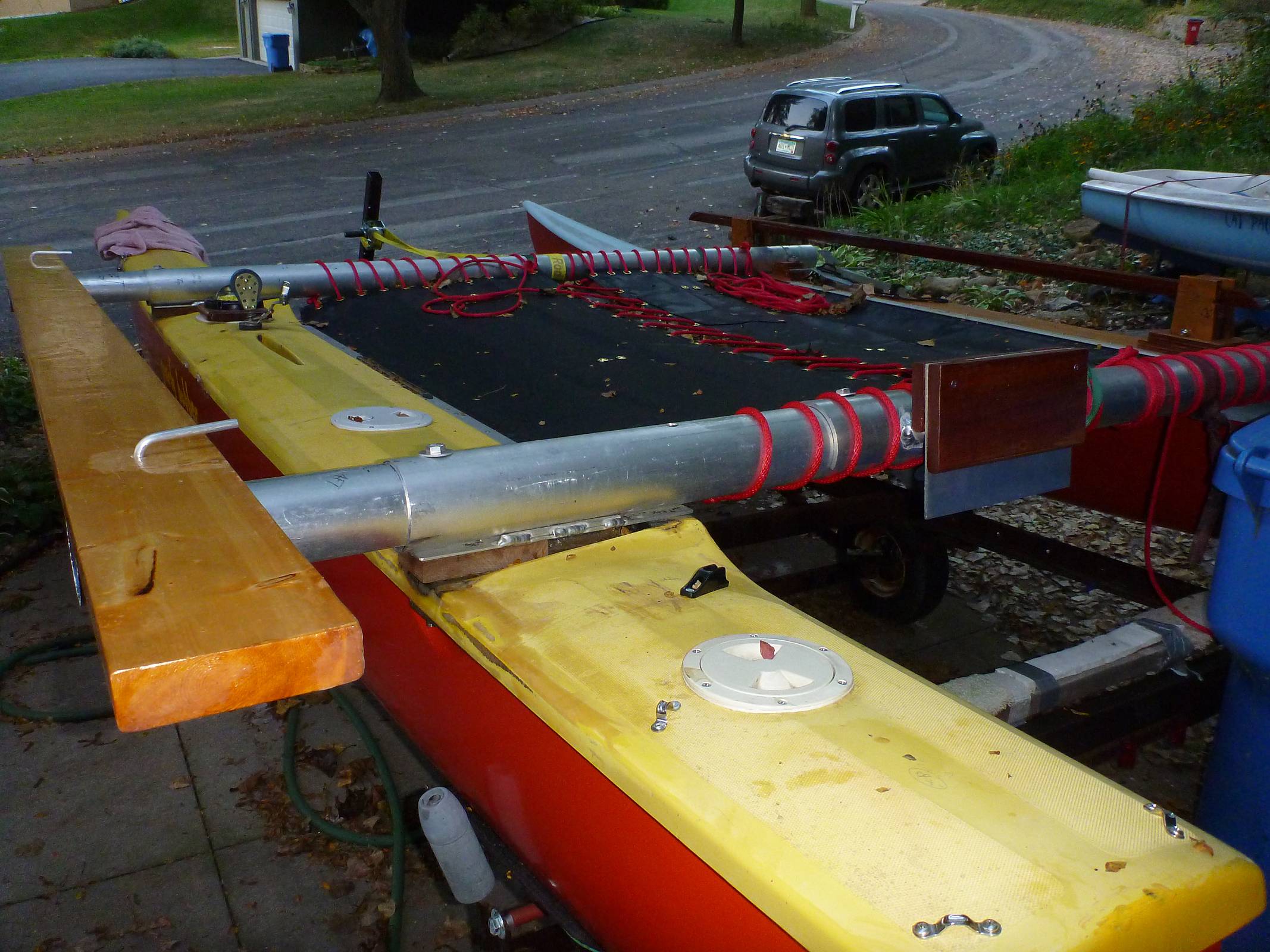

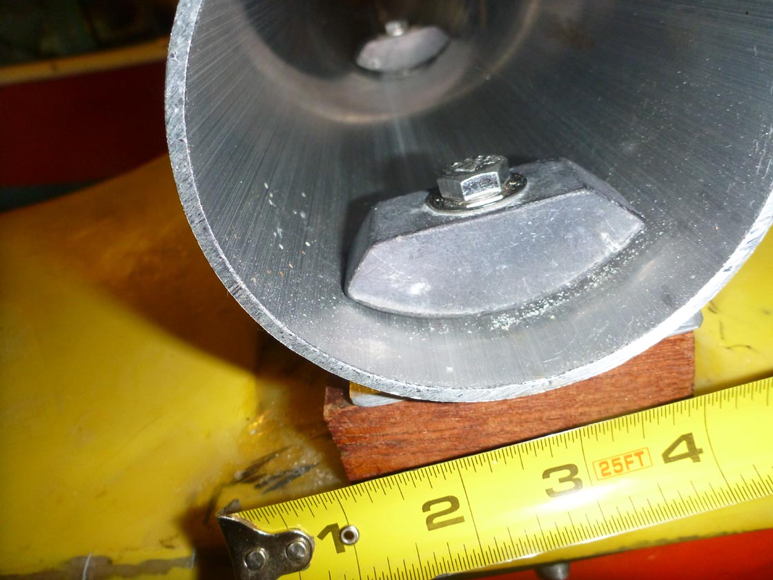

    The akas or beams are 4-inch 6061 T6 AL tube, as is the stubby mast.

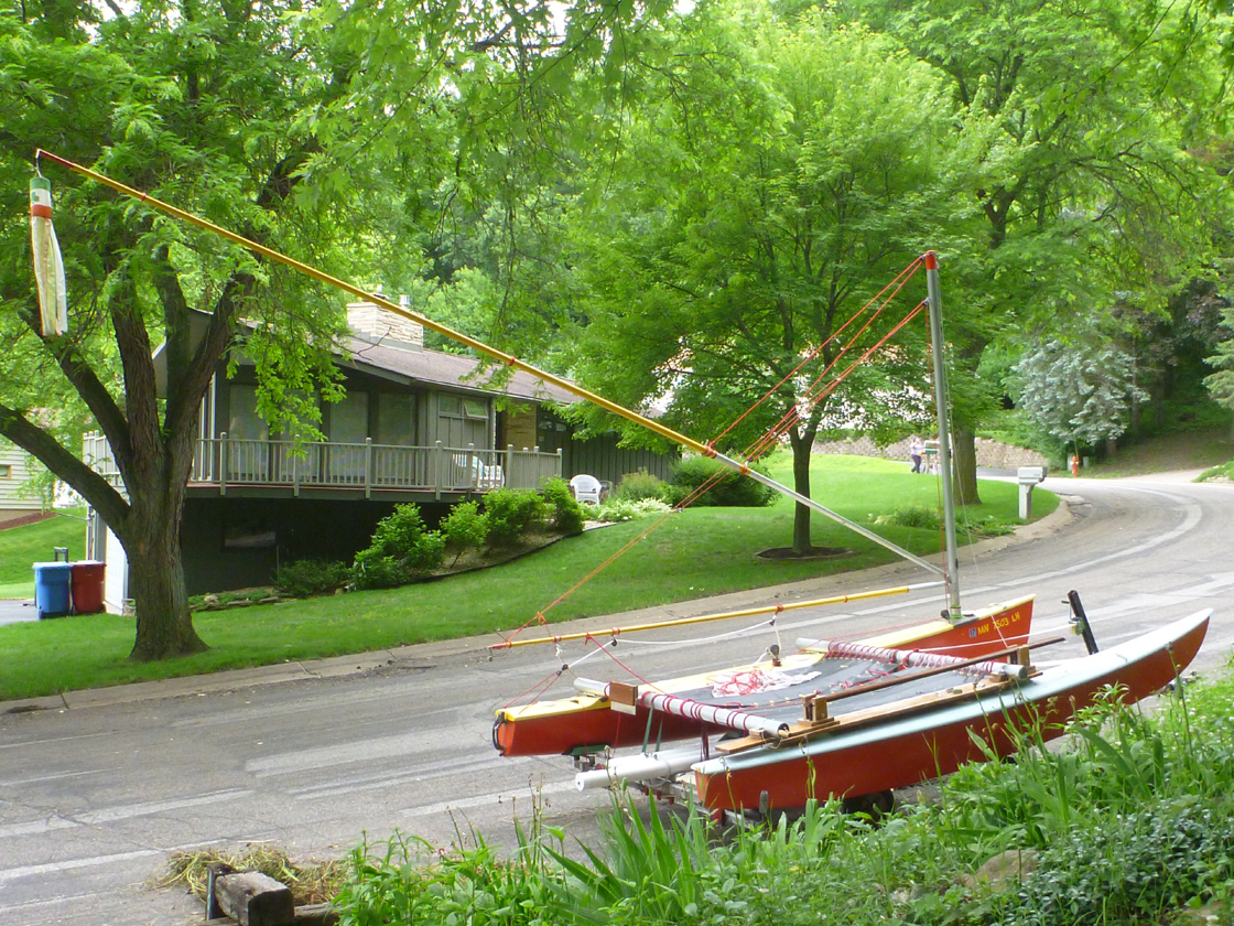

    The yard is both carbon and light AL, with 6061 T6 lower section and recycled surfer carbon top end, sleeved with carbon and glass. 26 feet OA.
    The boom is short 24 inche, T6 section plus recycled two section wind surfer carbon spar. 17 feet OA.
    Single rudder on main port hull (vaca).
    New 220 square foot loose-footed sail. Hook and loop luff to hang on spar.
    The pics show rig on street. This boat is seventh or eighth I have rebuilt, but first where most rigging etc had to be designed and installed, as opposed to established one design refit. I must admit, rigging is painstakingly tricky and requires constant redoing...and one reason why project has taken longer than expected.

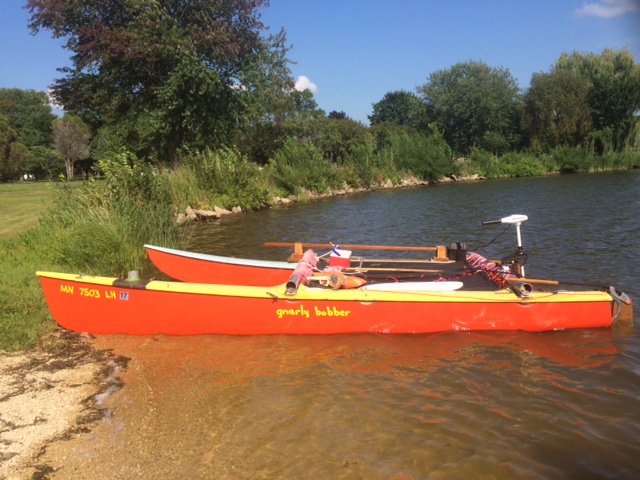

    As you may note, there is a motor mount, for electric trolling motor to move in restricted harbor area and channels. (Have yet to use harbor, just beach.)

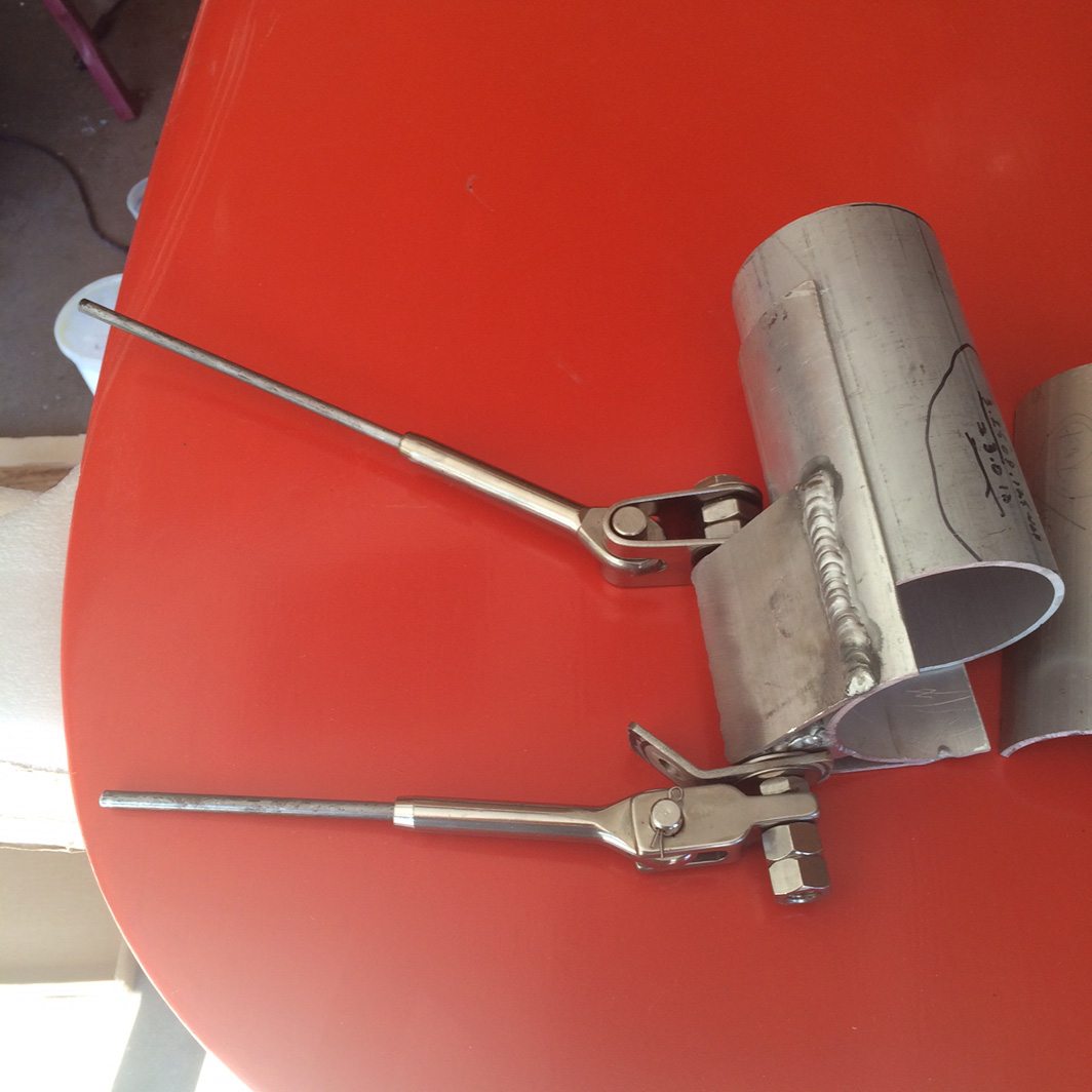

    One pic second and top shows intricate goose neck and one the eye on lower boom piece failed and caused two/three week delay.
    The eye was supposed to be rated 3000 lb fitting which failed, so I reverted to original design for the MO's two-part goose neck, below, to maintain strength...two part as yard and boom are set to function separately as sail is a semi-crab claw used by original Malibu Outrigger from original plans, which I acquired and used.
    The delay included refining order for SS components, having welded locally...I live in small community...

    The upper pic is goose neck my version and lower the round item is section equal to stubby mast of T6, with OD 3.25 and .125 wall (1/8-inch) wall. Revamp is below...all SS at spars. The SS band is just anal me, in case the monel rivets began to loosen...
    As noted, all experimental fly by seat of pants rigging. The SS gooseneck is formidable, indeed.

    First day out on small lake (intentional location) the plug material I used to fill H-16 rudder fitting holes in stern must have come out, and outrigger hull took on 50% water...so had to quit early...part of the busy stuff. Boat sailed with drag, but slower.

    BTW. First pic is boat without aka extensions in place. Last pic shows the extension inserted into akas with back rest beam also. The extension are removed to keep within road width restrictions.
