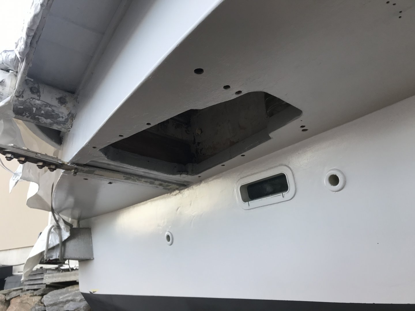

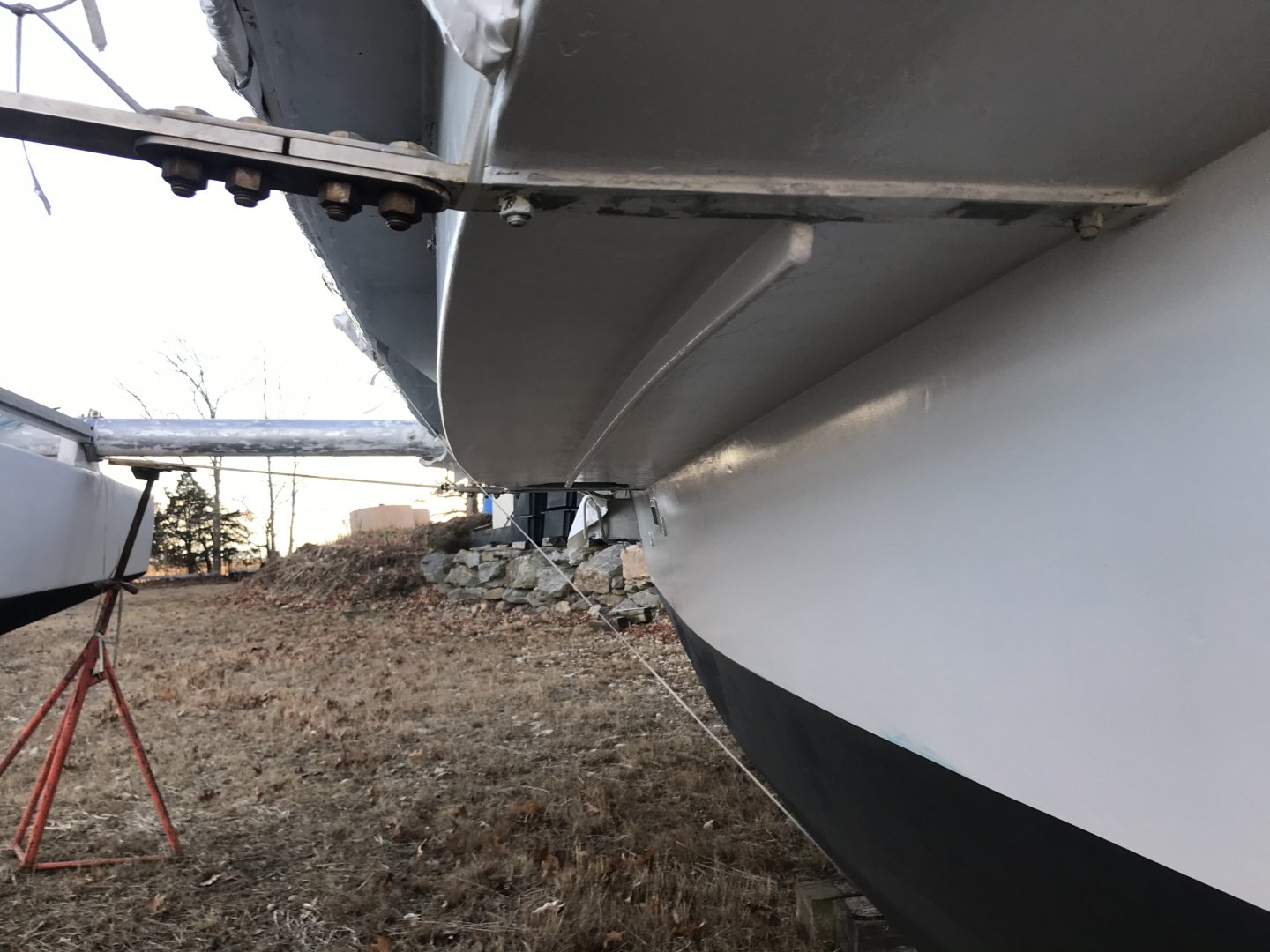

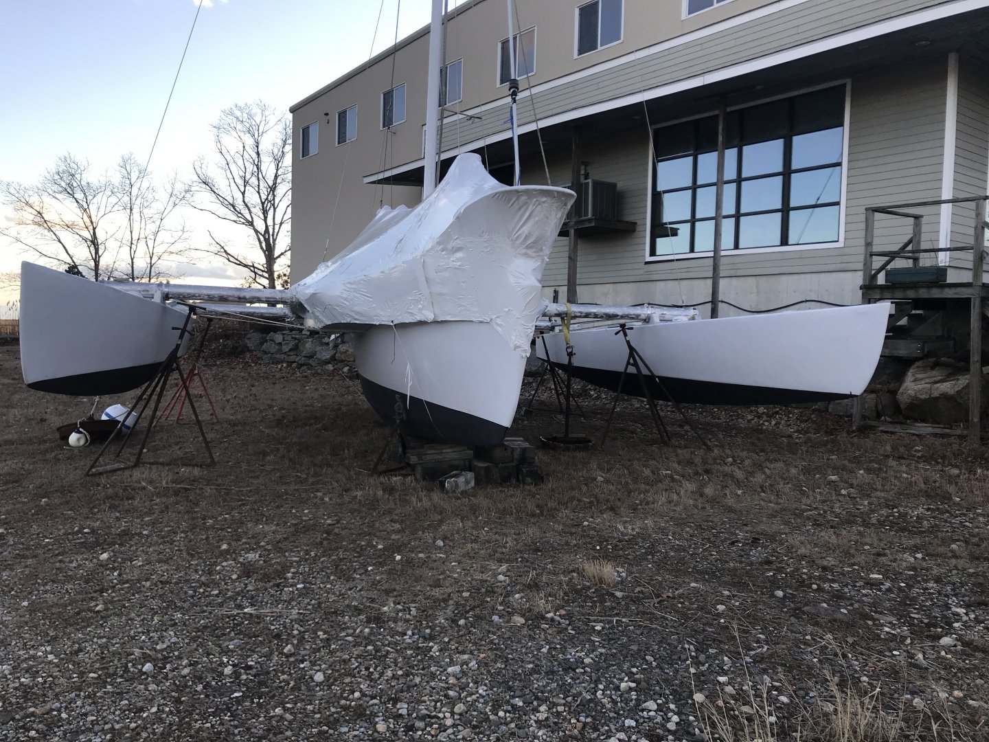

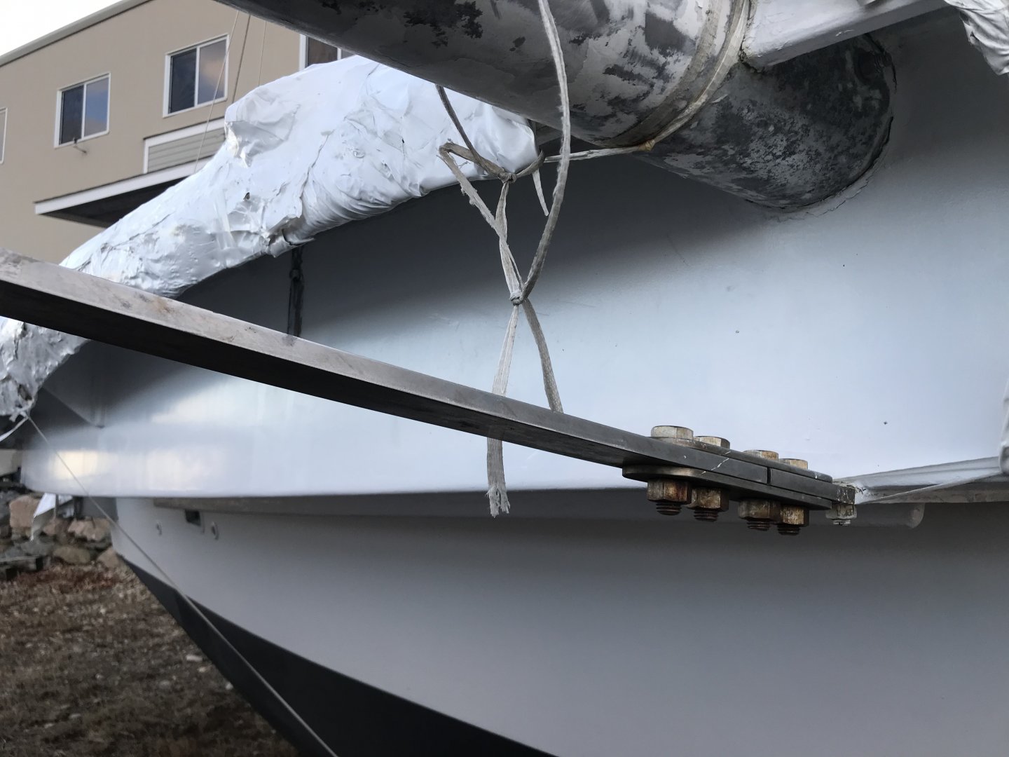

    Sled is definitely the way to go now that I’ve had a look at my boat again today. While I still need to build it and I’d love some plans to work from some advice from this forum would be wonderful. I’m uploading some pictures so you will understand that my boat has this cutout on the starboard side which the raised engine head will slide right into thereby hiding the unsightly thing quite well while providing access to the head if needed but also an Easy way for me to access the manual trim tilt handle thereby eliminating the need for me to buy a power tilt motor as I already own a good running 15 Yamaha electric start. 8D52C5F0-2A18-488F-8D98-4B8F318538F2.jpeg 17CF12D7-7BFA-42A4-9823-05F98CE0EA81.jpeg 0AB6455F-D19C-494D-BF47-BC6599169012.jpeg 20409CD1-C720-4FB8-912D-7EE1AF35A596.jpeg 8D016C70-679C-4514-8314-E65A93C8179B.jpeg

    Useful aperture. I put one in my Nicol quarterdeck for the motor when retracted and had the arms stretch up to the rear wing bulkhead which I beefed up to handle the loads from the pivot extensions which tie into that aka. My sled is a bit different as the sled has room to retract into the quarter deck structure but the arms run against the wing bottom for a ways to preserve a walkway/wing support structure that is necessary for that boat.

    Looks much plainer installed as it is painted white to match the hull. This sled was designed to work with the limited space between the quarter deck frames I was keeping. Every design is going to have different compromises to make so there isn't a once size fits all when it comes to sleds.
    My advice is to download the plans old multi posted or make a drawing to scale of your area and the waterline and make silhouette mock ups of the sled to get the layout right for your shaft retraction and the sled transom angled right for the motor when in the down position. Use a pin for the pivot and scale a profile of the motor to go on it and start trying things till you get what is the best compromise.
    You want a fine entry on the sled to minimize slaps, mine runs just above the surface, the deck lip keeps spray from waves off the motor.
