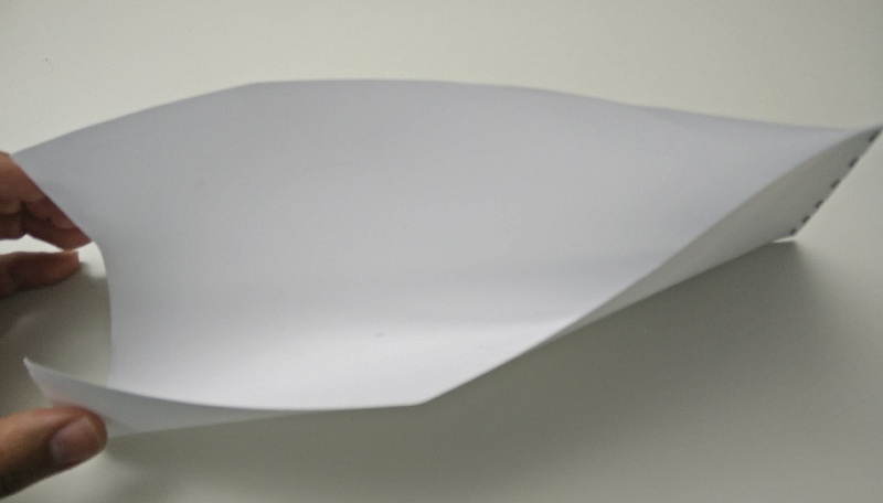

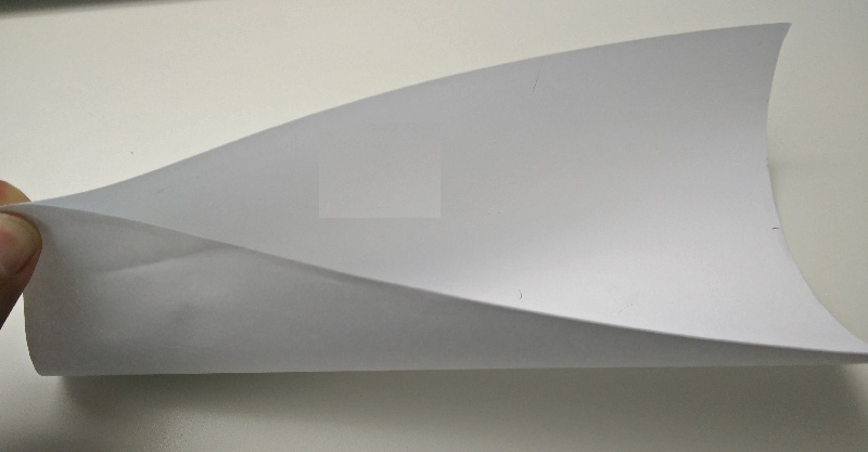

    I recently discovered this interesting method of metal hull construction.
    Question is: how efficient (or inefficient) would be a hull built using a single not cutted plate joined in half at the front and just "flattely" closed with a simple straight transom?
    And since a picture is worth thousand words I attached some image of the idea (just transom missing)...
    The construction would benefit both from less cuts and less soldering, and also aesthetically I like this resulting curved lines.
    PS: differently pushing or pulling the top borders at various sections one can have some control of final hull shape

    I think that the shape you show would make a lousy boat. It is interesting to try to develop a hull out of a single flat sheet. However, that should not take the place of good design.

    This sort of thing has been tried and the usual problems are related to getting reasonable shapes without a few more cuts in the sheets. Structural issues aside, the basic shape you've "discovered" produces a hull with a very fine entry, which doesn't hold up much and a progressively warped bottom to the transom. Though this can somewhat mimic a sea skiff like shape, the major problem is the transition from the forefoot to the after sections. This area usually requires a fair bit of "blending" to get it right, for both sail and power hull forms. You might be able to force some shape into these areas with a torch (requires pretty heavy plate stock), possibly some bulkheads, but generally it's wiser to work out what these shapes should be prior to bending.
    In terms of you question about efficiency, well this is calculated based on the goals of the boat (SOR) and these help define the shape choices, you need to live with. There are ways to bend up plate, into a much better boat shape, though you'll have to live with some chines.

    Put a transom on it and it will float. But even at that it is a long way from being a good boat. You will need stiffeners -more of them than if you designed a chine boat. The reason is that your hull is entirely a simple conic. It has no resistance to being a tighter conic or a flatter conic. By the time you get to a hull stiff enough to use I think you will have done lots of cutting and welding -to the point there is little or no advantage.
    The next reason there aren't many boats built this way is that it has no ability to optimize the hull to reduce drag. The only parameters are length and transom dimensions. There is no rocker so the transom will drag severely at low speeds. The bow is shaped to push water out, not under for lift -not good for planing.
    There seem to be several differing techniques and terms being thrown out -they are VERY distinct.
    -origami -only uses folding, no cutting and joining
    -buterfly -cut chines that end in the same piece of flat stock to develop shape -mostly conic shape but local 'torturing'.
    -tortured -build from flat sock but violating the conic to give more desirable shape and increase stiffness
    -standard 'developed' -pieced together from conics held in shape by attachment to other conics
