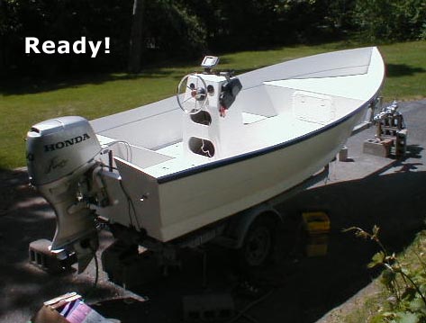

    Towing your island would be best done with a motor boat.
    It doesn't have to be complex or expensive, it just has to be powerful enough to fight unexpected wind and tide.
    I suspect you could get away with say around 50 hp, which is relatively inexpensive, but small enough to start by hand if you have a starter motor problem.
    The boat itself, can be a simple plywood boat, of easy construction. It would be a good utility boat, so you can go and pickup shopping and supplies, tools etc.
    You may not use a long tow rope. Its quite acceptable to tie the boat up against the raft, and power the whole thing tied together. This technique is used a lot, and can solve many problems.
    Something like this perhaps ? What's the cheapest way to get a 17 ft motorboat? http://forum.woodenboat.com/showthread.php?131422-What-s-the-cheapest-way-to-get-a-17-ft-motorboat
