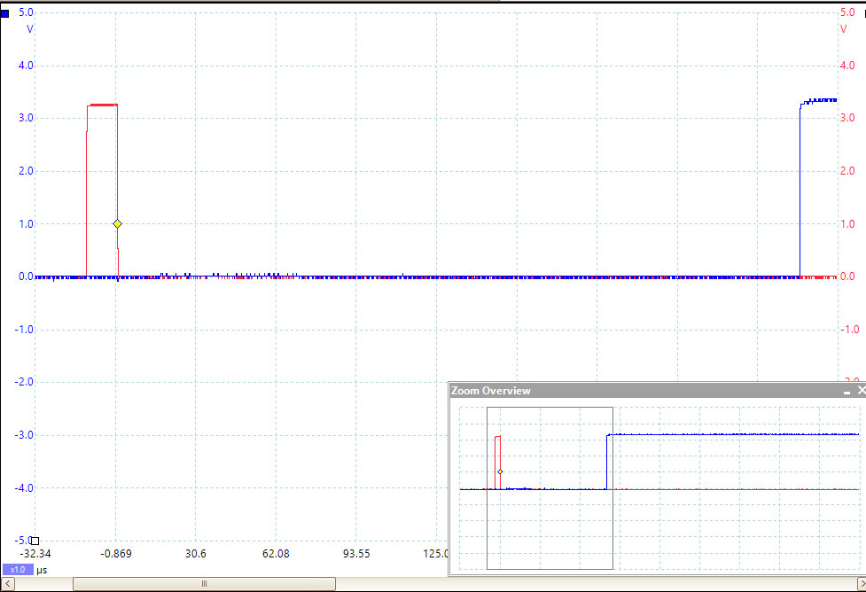

    Yay!!!!! I finally got it all working together, what a freeking mission, without that blue scope and my new learnt language of I2C I would have never cracked it.
    There were so many bugs in the manufacturers code it wasn't funny, man oh man this has been a VERY frustrating two weeks.
    This laser range finder is the business, on a different level to the ultrasonic sensor. Very responsive.
    I left the ultrasonic sensor circuit running for 6 hours and it fired off twice in response to noise, so much for encoding the signal. I might modify it and make it more robust.
    OK I am going to get some rest and write the code up later, yay no more coding for a while now. Time to put it in a waterproof case and test on water and on the road, I am going to stick it out the car window and see what the max speed the laser will work at on land then try it on water.

      pinMode(echoPin,INPUT_PULLUP);
      //Sensor Initialization
      mySensor.initSensor();          //The I2C Address can be changed here inside this function in the library
      mySensor.setOperationMode(OPERATION_MODE_NDOF);   //Can be configured to other operation modes as desired
      mySensor.setUpdateMode(MANUAL);  //The default is AUTO. Changing to MANUAL requires calling the relevant update functions prior to calling the read functions
      //Setting to MANUAL requires fewer reads to the sensor

    //Code added to standard motion sensor code
       //Code for Ultrasonic Distance
       // Clears the trigPin
        digitalWrite(trigPin, LOW);
        delayMicroseconds(2);
        // Sets the trigPin on HIGH state for 10 micro seconds
        digitalWrite(trigPin, HIGH);
        delayMicroseconds(10);
        // Reads the echoPin, returns the sound wave travel time in microseconds
        duration = pulseIn(echoPin, HIGH);
        // Calculating the distance
        distance= duration*0.034/2*10;
        // Prints the distance on the Serial Monitor
        //Serial.print("Distance: ");
        Serial.print(distance);// Clears the trigPin
        Serial.print(", ");
        delay(100);
