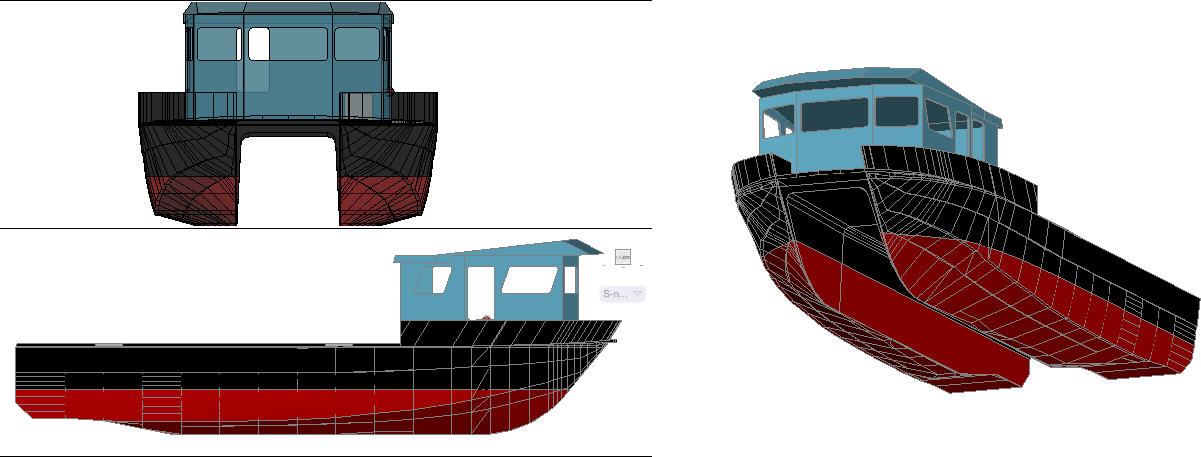

    This is a very simple catamaran which, if you are interested, I can give you a lot of information. It is not a spectacular boat but it can help you in your first steps with boats. LOA = 16 m, Lbp = 14.6 m

    Thanks I really appreciate it. The hull lines for the motor cat you've provided are not quite what i'm looking for. I'm specifically looking for the hull lines for a 14m catamaran sail boat. I guess there is some standard for these contours especially the area below the waterline. Check the attached document as well if anyone is interested in this.

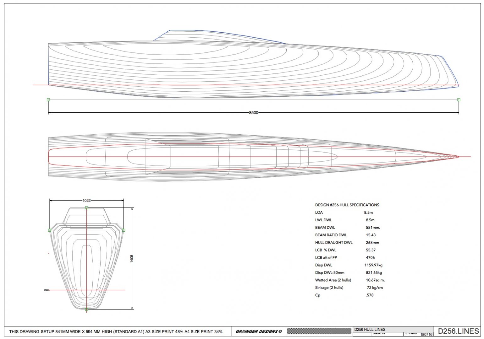

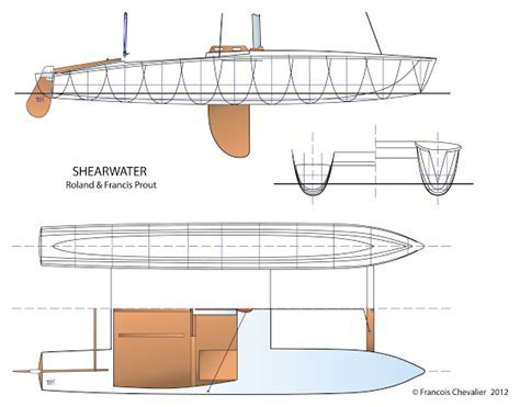

    Here's an example of what kind of information I need to get started.
    Optimising Hull Lines for Performance https://www.graingerdesigns.net/the-lab/optimising-hull-lines-for-performance/

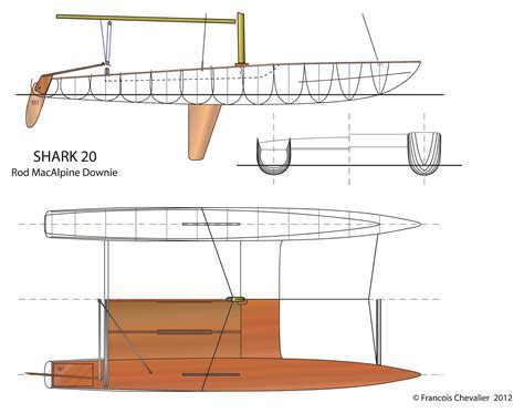

    The boat shown here is a 8.5m cat sailboat. I'm looking for something a bit larger in the 14m range. Also, the images only show one of the hull profiles. I'd like profile lines for the entire boat. I will post some other images I've found online showing profile lines for smaller boats. I still cannot find any 14m hull lines. Can anyone help?

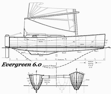

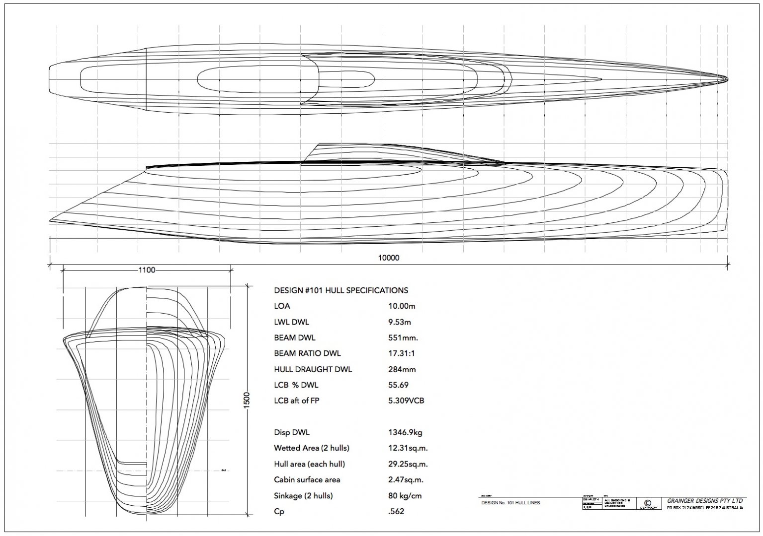

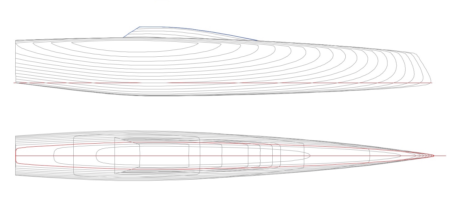

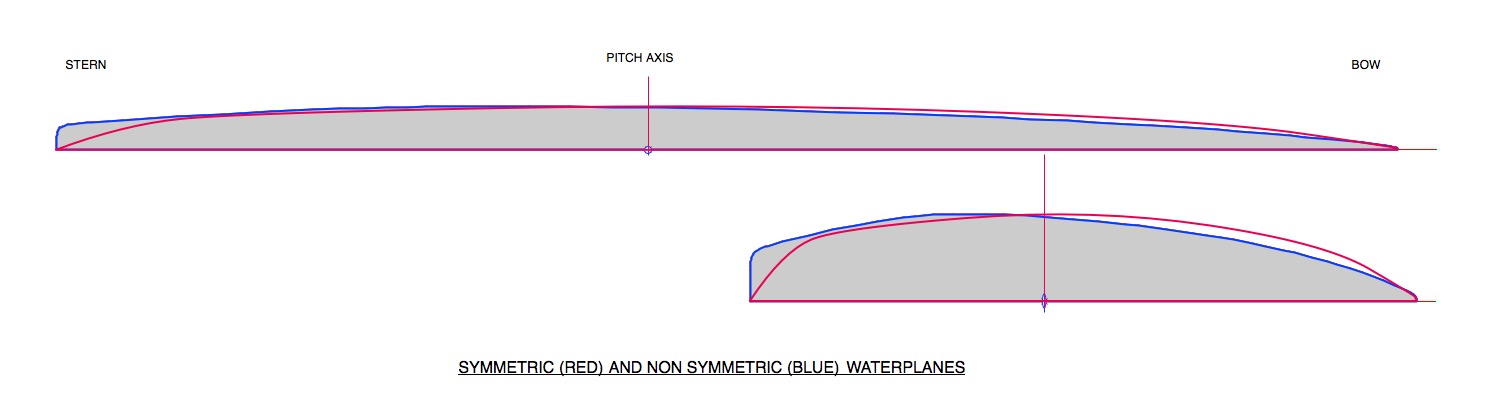

    Here are some other hull lines I've found online. Hope this is useful to anyone else looking for this information. Thanks!

    You could take any of those boats and scaleb the lines to get the desired length. Since it is only a 3D modeling exercise, you do not have to worry about anything else.
    You could even make a mix of 2 or 3 of those models to get the one you are looking for.

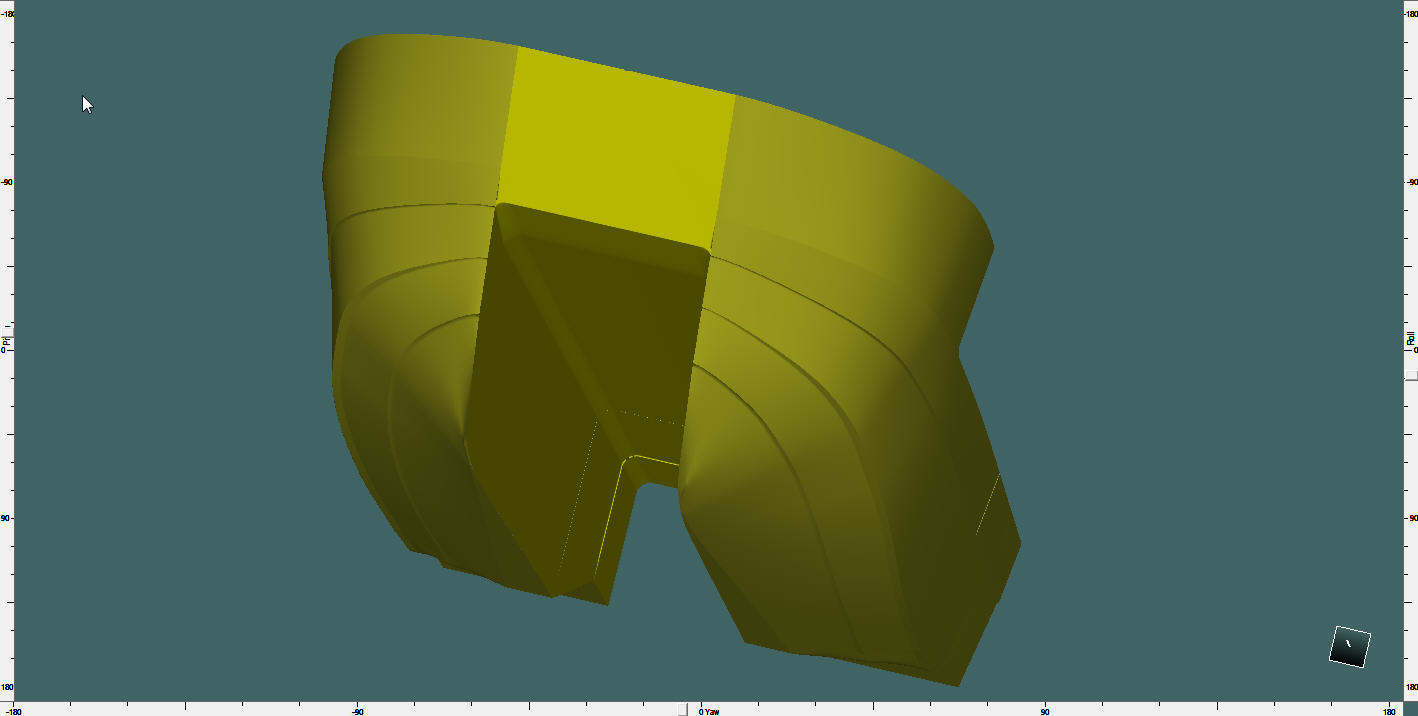

    In complement to illustrate this first approach, my good friend Alain did some 3D views here attached of the hull V2 version with Multisurf (using fit for purpose ouput data in section 5. of the above file).
    To inspire you V2-3_profil[13058].JPG V2-3_dessous avant_tbd[13061].JPG V2-3_dessous arrière_tbd[13060].JPG V2-3_dessous[13062].JPG V2-3 bi-coque[13059].JPG , some other examples of cata, more sport/day sailer oriented than the Saona 47 :
