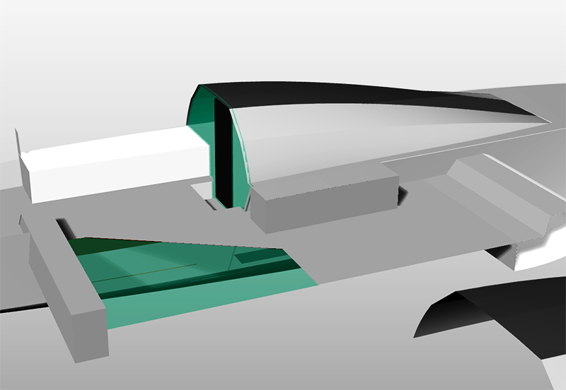

  10. UpOnStands
    Joined: Nov 2015
    Posts: 681
    Location: Sydney
    UpOnStands Senior Member
    true that. Split the bottom lift foil into P&S and mount each on their own board. Yes, the foils would need to pop off if the board hits anything.
    The foils develop lift so if the downhaul setting line is released the foil should :) slide up the board to the surface whereupon the board is swung fwd and up to stow. The boards swing fwd 80 degrees but aft only 30 degrees or so. I do not like indenting the bridgedeck to accommodate the boards.

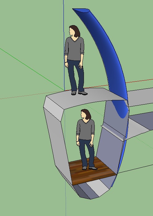

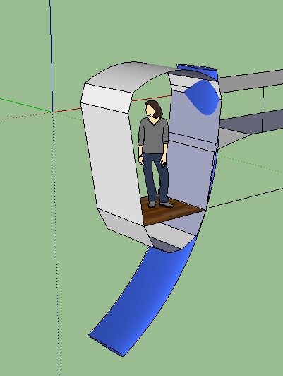

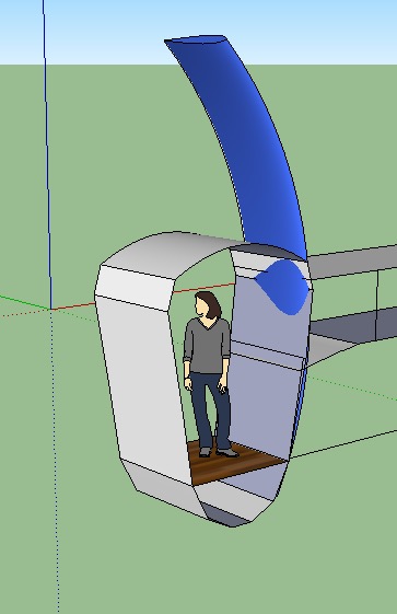

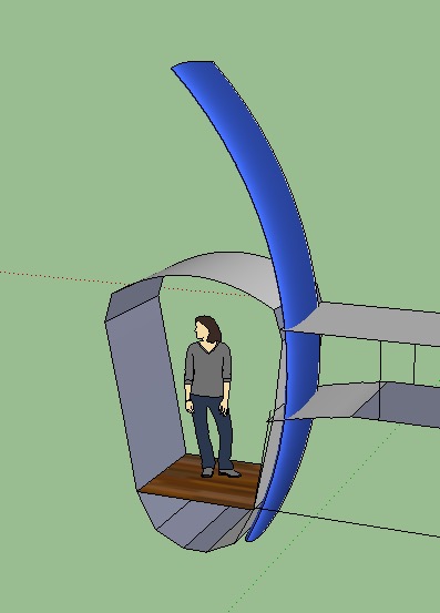

  12. UpOnStands
    Joined: Nov 2015
    Posts: 681
    Location: Sydney
    C-board but facing outboard. There is a external bracket under the waterline that holds the board in place against the hull. Above the waterline, the board runs thru a case in cross-beam.
  13. Doug Lord
    Posts: 16,678
    Location: Cocoa, Florida
    Doug Lord Flight Ready
    "C" board as drawn facing outboard is a bad idea(very draggy) : you would have high pressure on the top side(due to leeway) and low pressure on the bottom-just exactly the opposite of what you want. The only way an outward facing board works well is if it doesn't develop lateral resistance and does develop vertical lift.

  14. UpOnStands
    Joined: Nov 2015
    Posts: 681
    Location: Sydney
    Thanks for the input.
    Design brief for this project is not full foiling. Partial support with lateral resistance and pitch damping.
    This board has non-uniform aerofoil X-section. Other solutions possible to meet SOR but this is design meant to stimulate ideas. Consider what benefits are possible re. potential problems.
    For example, with the board up there is good clearance to the deck and the foil end is away from center of the boat.
    I feel that the center of lift should be as outboard as possible.
    Of course, if Groper is happy with the Fujin arrangement that's it then.
  15. groper
    Joined: Jun 2011
    Posts: 2,467
    Location: australia
    groper Senior Member
    Dougs comments are correct - and this is why you dont see the C board curved the other way on other boats. The C boards used on all the big racing trimarans and Fujin are a proven system which works - hard to argue against that.
    The problem with Fujins arrangement is that the boards are located very aft so that they are in the correct position for leeway. If you look at the design of fujin, the boards are aft of the mast. Im trying to get the lifting foils a bit further forward than this to counteract the rig driving force which tries to trim the boat bow down on a hard reach. Further forward will also increase the pitch damping as the moment is larger to the LCF pitch axis. This is whole reason i considered 2 boards per hull despite the extra hassle/weight/cost.
    If you look at the big trimarans - they position the C foils forward of the mast for the above reasons - they actually raise the bows clear of the water as they get powered up and faster and rise up slightly onto those C foils with a slight bow up trim... exactly what you want when the seastate is picking up with the wind
