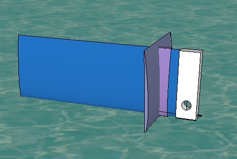

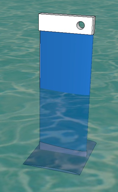

    ive been thinking about a single dagger in a small center nacelle as discussed in another thread here on BDforums. The reason is because it frees up alot of room in the hulls and saves some cost/hassle etc and much better maintenance / damage survivability etc - many good reasons for it. But on the other hand its probably simply too "different" to be successful in the market place. Afterall, theres no point building a 50ft cat which will cost a small fortune and not be able to find a buyer for it once your done with it...
    I like the idea of fully serviceable whilst on a beach, no jamming or fouling in cases and not having to worry about ripping a hole in the hull if hitting something at +25kts. Same problem applies to the lifting foils... This boat will frequently be sailing fast so if it does hit something its probably gonna hit HARD... im open to other ideas which achieve the same end but they all have compromises... I guess the C boards are the most proven system on sailboats to date? They could be angled straight boards instead? almost surface peircing in nature as the board exit in the hull could be around the static waterline. At least no marine growth in there but it completely ruins any accomodation space in that area which is up forward so not such an important area as the midship...

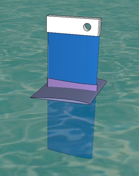

    semi-lift foil on the centerboard mounted in nacelle. 80cm clearance from foil bottom edge in stowed position to sea surface.
    The lifting foil is held down by spectra rope that passes through the centerboard and turns around on a PTFE sheave at the bottom of the centerboard.
    Edit: If the actuated foil is too complicated, fix it in place and set next to it a regular but slightly shorter centerboard. If speeds are too slow for foil assist use the straight board. If speeds are high enough, retract the regular board and use the foil board.

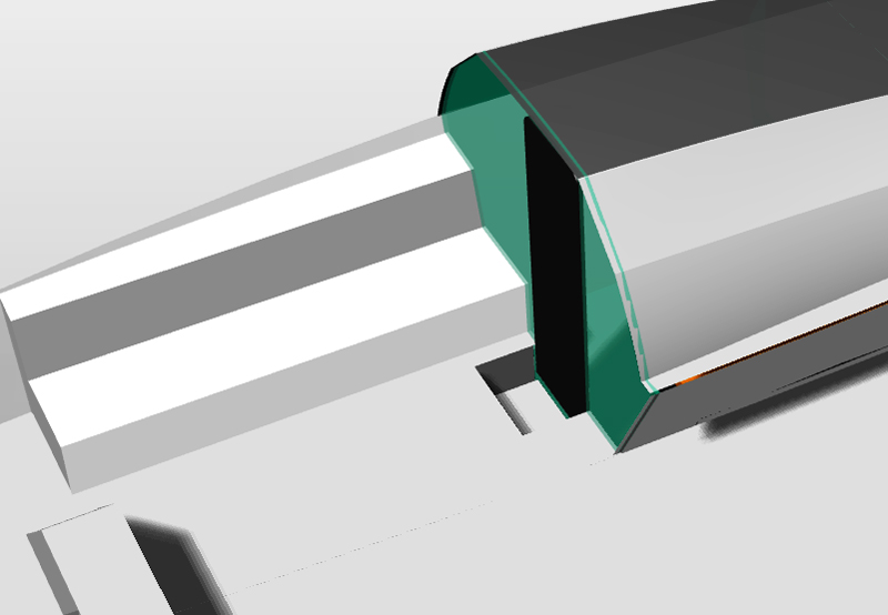

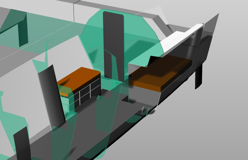

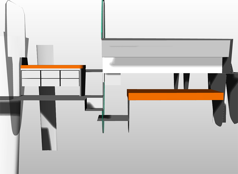

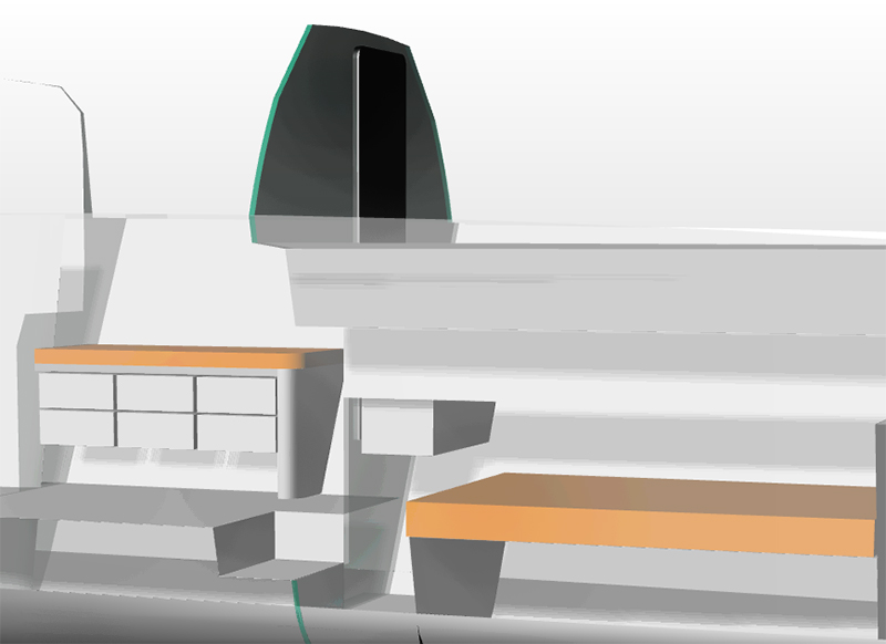

    The aft bunk has very low headroom, even to get into it from the high side. I suppose that is what race boats have.
    I put a bench in the space when you first enter, is that correct? It looked like galley went where dagger is because the cutouts are counter height.
  8. groper
    Joined: Jun 2011
    Posts: 2,467
    Location: australia
    groper Senior Member
    Hi Jorge - ya gotta think in 3D man!
    See this next pic;
    The companionway step has been shown here and also a change to the cockpit seat which makes it alot wider to give more volume below to the bunk area. You can also see a raised section forward of the seat which provides headroom for the companionway to the rear bunk. Each companion way is offset laterally and also vertically so its ends up a bit like a spiral staircase if you will. The saloon floor inside also needs another small cutout step down like we put in the deck. The companionway from outside could be moved slightly further inboard, then omit a small section of cabinetry as you get inside to provide the space to walk. After that omission, the cabinets or seating can be full size.
    The rear bunk can be lowered slightly to give more headroom - by how much determines the acceptable width of it. At present, its a queen. If you drop it down to give more headroom youll end up with a double. Also another 4inches of headroom down there can be had by raising the bridgedeck clearance from the 900mm or so at the moment upto 1m which could be good for other reasons also...

    Okay, I was trying to follow your drawing as close as possible, I will give it another go tomorrow. Just working on small spaces gives me anxiety lol!!! Even though you don't have much of a bridgedeck I was surprised you had it under a meter, I think that should go up too.
