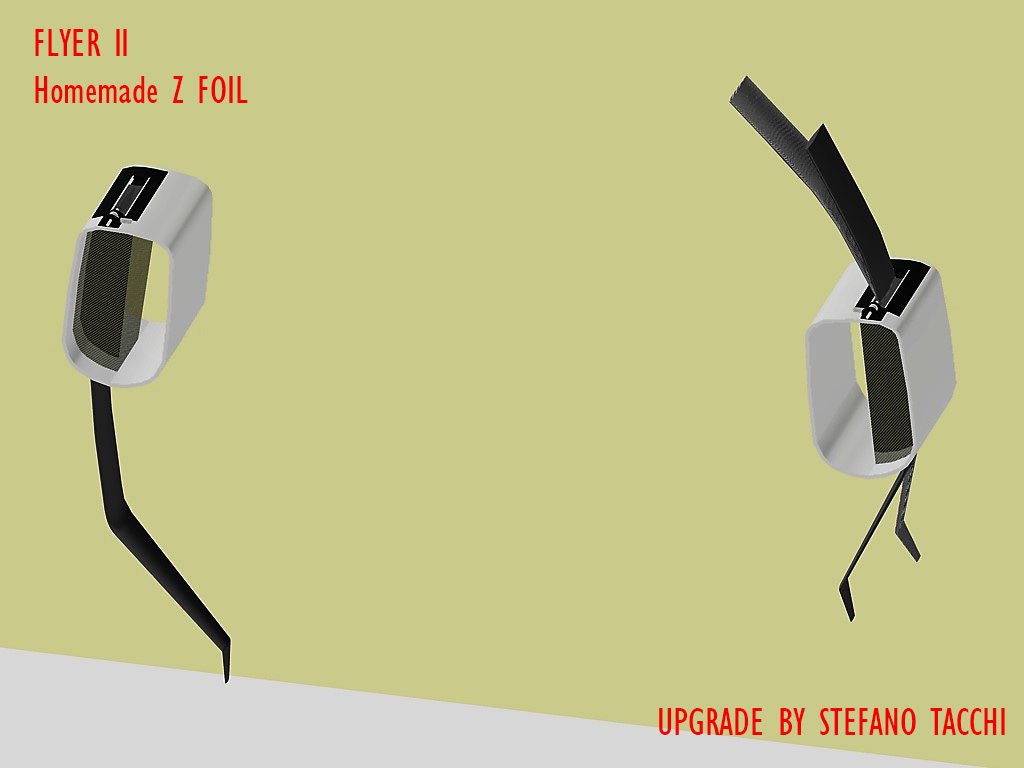

    Picture already posted-more details here: New 'Z' board Cruiser-Racer Cat: The North Wind 55 | Catamaran Racing, News & Design http://www.catsailingnews.com/2016/04/a-cat-applied-tech-new-z-board-racer.html
    What about the board raise system, curved boards seems to have a smoother framework, and Z as seen in the As do have a special space required in the deck for fully raised?
    The boards will end flat over the deck?
    GR:
    We have designed the tightest daggerboard trunk possible, so the way they are positioned is not a problem even for the interior. They do go a bit over the deck but this is something we studied and is not a problem. In the end when sailing, both boards will be down.

    I was hoping for actually built hulls.
    Well, this is the designer speaking so of course everything "works well" & "not a problem"
    No examples have been launched so no owner has yet to make the choice between curved or Z boards.
    This special space required in the deck is the key design point as it appears to cut the accommodation up. But we need detail images of the cassette/trunk system to know exactly what the costs are.
    This is the best I could find but it is retrofit of an existing hull by Stefano Tachi. Images seem to show that the z-board is not removed completely? But the trunk is massive.
    https://2.bp.blogspot.com/-Jn44aOGP...BqpoQ0oemu3x-w/s1600/AclassFLYER-Retrofit.jpg
    Catamaran Racing, News & Design: March 2016 http://www.catsailingnews.com/2016/03/

    Im not even going to respond further to the Z foil idea- the above pics and other info posted earlier about why its not practical are obvious.
    Doug- look at the above pic. Now imagine the hull is not 1ft deep but 8 feet deep, go ahead and draw it if you have to. How on earth are you going to fit that trunk in there allowing for the curvature of the Z part of the foil and the straight sections so that the board can be inserted from above? Go ahead and draw it and then show me how much volume you have left in there for a bathroom or a galley or anything at all! And this occurs at the most useful voluminous part of the hull so ypuve just destroyed your best living space with your decision to use z foils... great idea mate!
