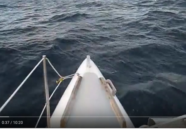

    Interesting, SIG45 runs the anchor off the longeron. Probably the anchor is the smallest aluminum one available.
    This shows the conventional solution to bow bury, make the bow really high and keep the decks flat. Certainly is simpler than trying to locally reduce the freeboard a'la Fujin.
    What's your vision of the bow/fore deck shape?

    Flat deck to stem;

    this is from TS50 XL
    The bow does have a cleat, looks like sufficient foredeck to actually use it. SIG45 has no such space or cleat?
