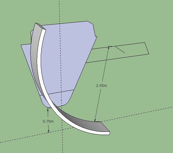

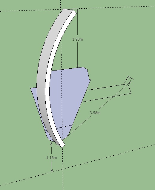

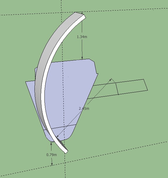

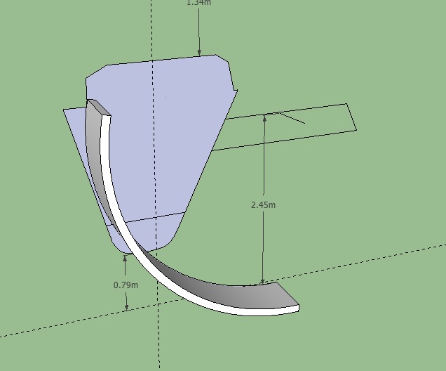

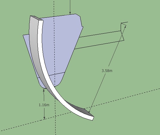

    G. first rough view of C-board down and up. +max lift?

    groper Senior Member
    Exactly- and this is probably too much curvature and will generate too much lift and not enough leeway. Thus it could be straightened a bit to get the right balance of both...

    UpOnStands Senior Member
    flatter then
