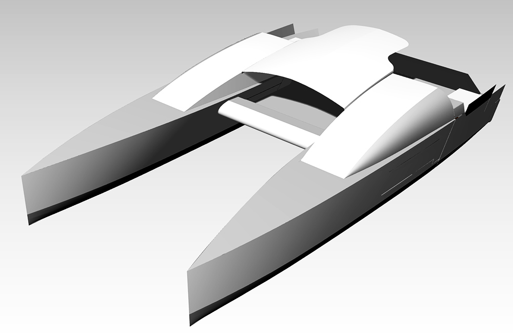

  4. groper
    Joined: Jun 2011
    Posts: 2,467
    Location: australia
    groper Senior Member
    You must have read my mind Jeff? After i posted the rendering of my old design with the roof etc i decided to clean it up a bit and ended up doing exactly what you just said above! This was before i read your reply... something about minds thinking alike :D
    Pushed the inner coach roof up a tad and blended in the roof with a forward scallop to lower down on the coach roof forward... makes a good rain catcher too!

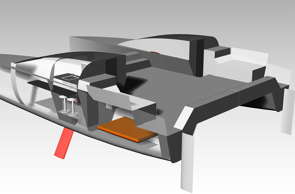

    I like the full deck too. The swinging davits is a good idea, keep them out while you are running and swing them in if you need to at the Marina. Here is what the full deck looks like, I will try to draw the roof. I notice you can't pull the red foil completely without hitting roof.

  13. DennisRB
    Joined: Sep 2004
    Posts: 1,270
    Likes: 26, Points: 48, Legacy Rep: 228
    Location: Brisbane
    DennisRB Senior Member
    Nice renderings! How much does moving the rear beam back affect weight at the stern?
    I have always thought that boards with an inward angle (opposite to what is designed here) would have the benefit of adding a bit of lift. But also in the event of wind or wave capsize conditions they would be safer. I imagine a wave hitting the side of the boat. With inward angled boards the windward board would dig in and the leeward one would want to rise. That may help a bit to prevent capsize. With outward facing boards the opposite would occur! Sideways movement would create an overturning moment from the angles of the boards.
    The effect is probably not great, and its obvious with this design that the slots are in a very easy place to manage in this location and would be difficult to access if it were the other way around. Plus there is hardly any cabin intrusion. With the planned lifting foils at the front you don't need the lift plus having them cant in seems good for upwind performance.
  14. groper
    Joined: Jun 2011
    Posts: 2,467
    Location: australia
    I dont think weight at the stern is too much of a problem other than the inertia in it and its effect on pitching. The rudder horizontal stabilizers will take care of that - and no i still havnt done a proper weight analysis yet - ive been busy.
    I also think a "thunder cat" lifted up by the main boom through the cockpit floor just in front of the rear beam is tempting - no davits at all and no weight and expense of cockpit floor to build either.... The thunder cats have a low profile and flat deck not too uncomfortable for lounging on, so could work well - i think we just eliminated more unessesary junk and cut more costs from this project :)
    The daggers and foils are a work in progress - im really starting to second guess the feasibility of having 3 or 4 different boards which is where this thread started. A single lifting and leeway board- like a large C board or L board, with a good strong set of rudders and stabilizers at the stern is probably the best option - likely why you see this configuration on cats already, not 100% convinced either way tho. Id really like some decent L boards but having them able to be withdrawn from the top and not looking too ungainly on the exterior of the hull is proving difficult...

  15. Ad Hoc
    Joined: Oct 2008
    Posts: 6,898
    Location: Japan
    Ad Hoc Naval Architect
    The pitch stability is dictated by the waterplane area inertia. The mass distribution affects the radius of gyration.
    You must do a weight analysis before you go any further. Otherwise you will have no idea what you're aiming at...in terms of:- will she float..will she float up right..and will she float on the draft expected....etc. You need a datum.
