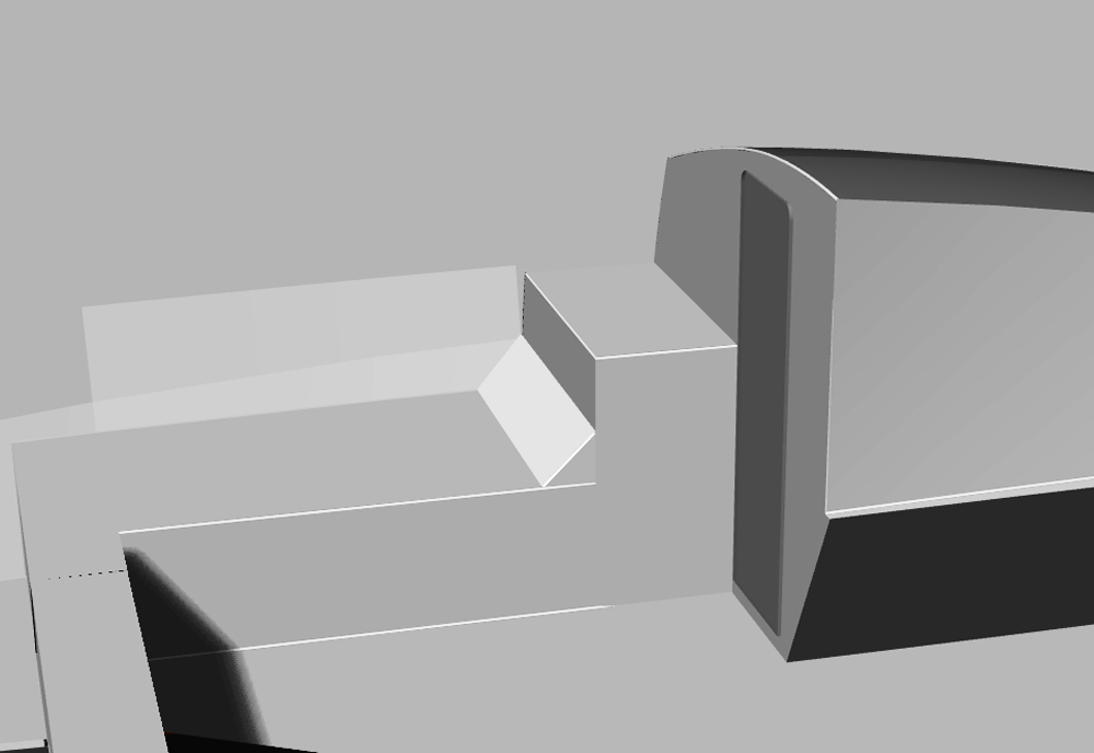

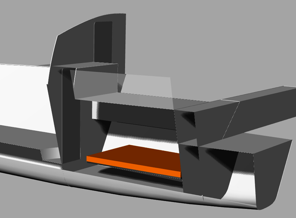

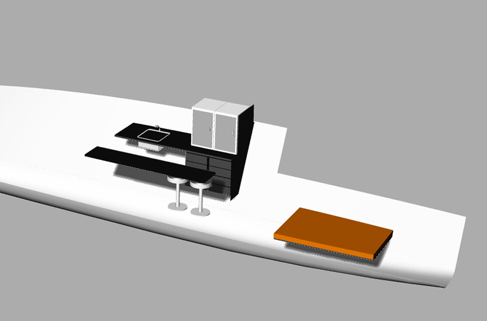

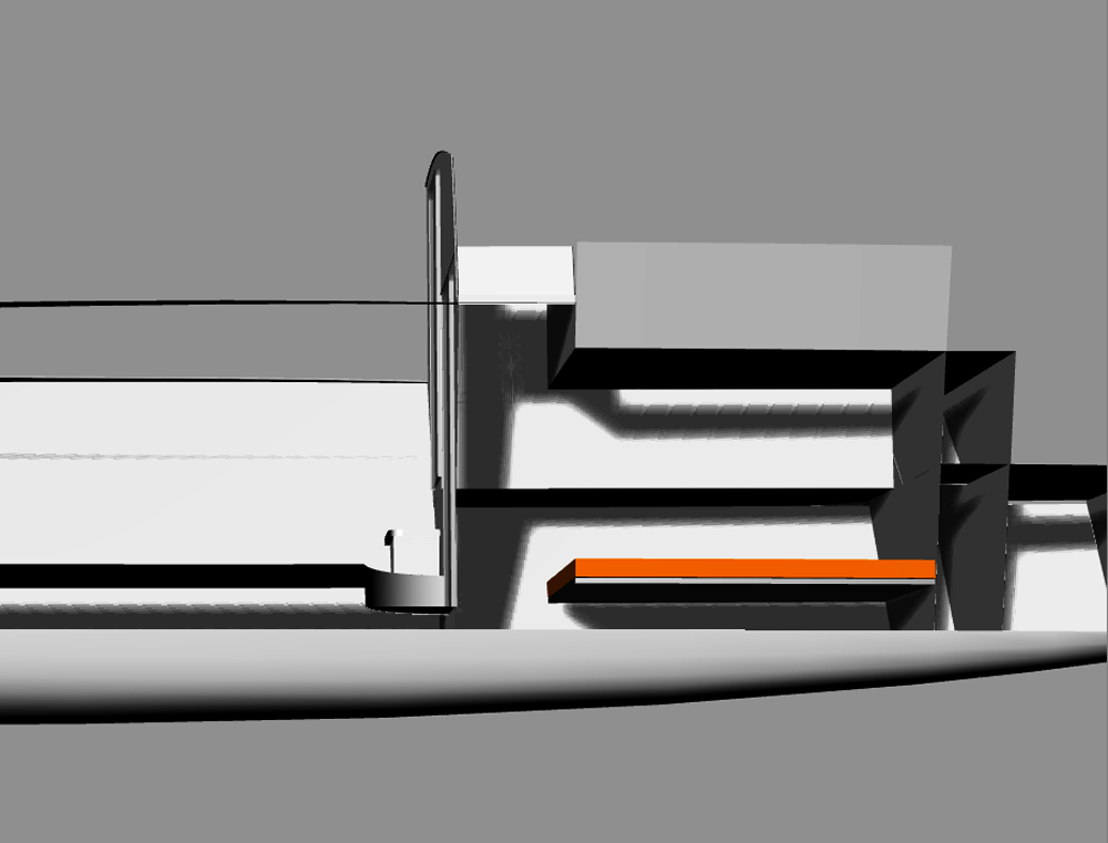

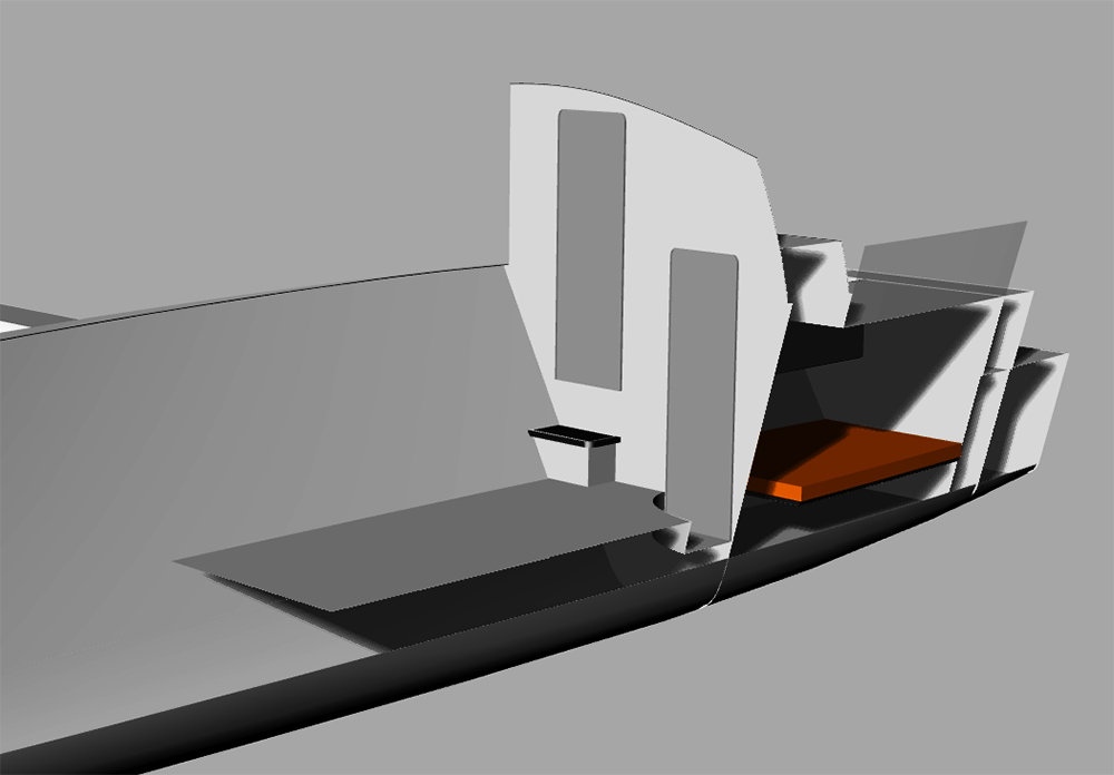

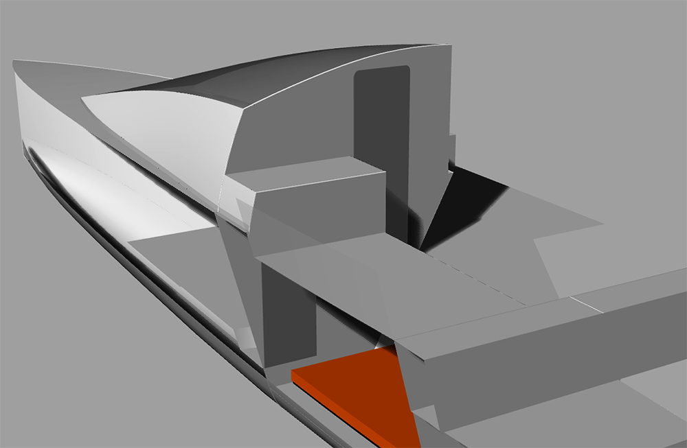

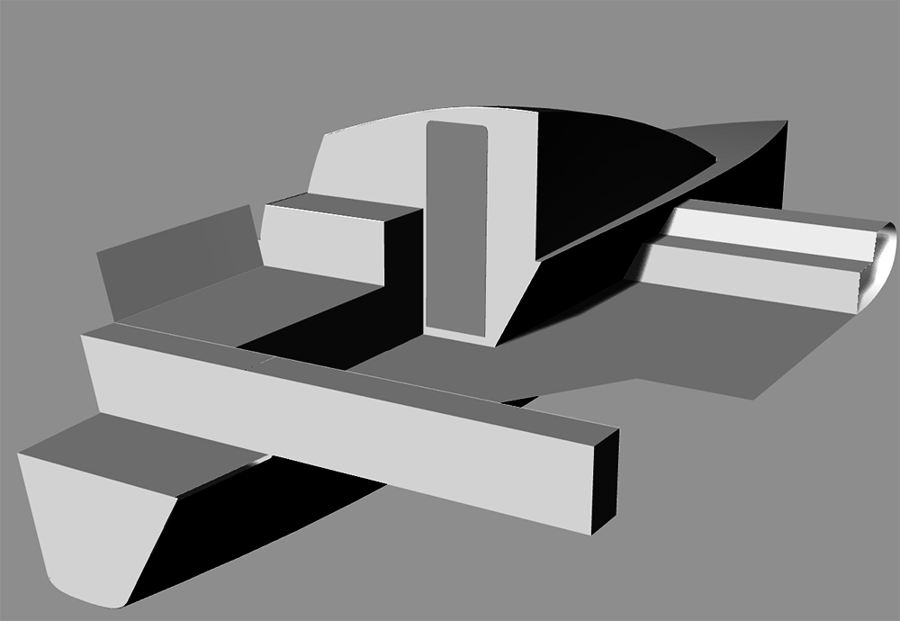

    1. Ok fixed the coach roof to be more like the SIG with the tilt, makes a big difference for the entry, no need to cut out deck area which is an accident waiting to happen.
    2. It's a race boat so what is an extra step, made the aft beam span all the way across boat and tied a really wide bench into that. Now you can sleep holding the tiller and you get nice headroom below. ))
    3. I made sure the door to aft cabin clears when opening in toward outboard side. It's looking okay back there so moving forward...

    One small detail, bench and box should come together with an angle so nobody busts their head getting into bed.

    section 9 dimensions; This opens fine for me in autocad - no scaling or anything required from the last file i uploaded and pulled these dimensions straight up. If your having trouble, it must be the settings in the software at your end thats messing it up.
    Jorge - i orginally had the coach roof like that but upon looking at the boat in profile and from other angles - it juts up too high and looks silly/out of proportion - not to mention the extra windage and upwind performance penalty. It pushes the entire roof line up just so you can walk through a door without 1 step in front of it and then having the roof that high once your down the step it then becomes overkill/higher than nessesary once inside. I know you hate steps - but steps are an absolute necessity in a design like this to keep the windage down as much as possible. If you want upwind performance - you MUST have low windage.
    I know your struggling with the concept of small spaces - but thats what performance boats are - tight spaces. its challenging to make the most efficient use of the small spaces available - but consider this - my last boat has MUCH lower volume than this in the hulls - approx half the width!

    I think windage would be about the same, the outboard side is right where your old coachroof was but it does give a lot of extra height inside. I will drop it and add a step. Yeah I don't, at all, like steps. Had one boat that was all steps and benches to climb over, hated that thing with a passion.
    Fridge and Freezer fit
