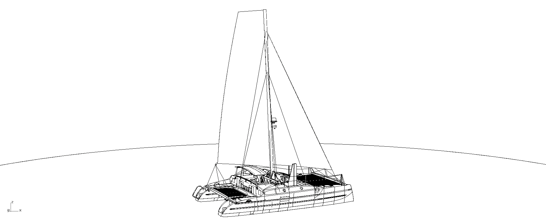

    re-rigged
    OK, single mast...simple.
    1 person likes this.

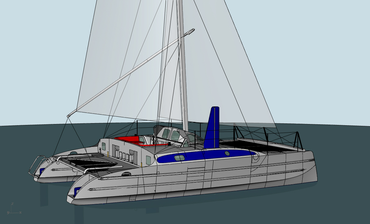

    Right...I've got the sailplan for Robin Chamberlin's Cirrostratus 10. I do like it. I also really like what I see in this forum post on CruisersForum. I think the soft rigging would be a perfect combo with the three tiered cutter rig.
  4. catsketcher
    Joined: Mar 2006
    Posts: 1,306
    catsketcher Senior Member
    I like it more now but then again I will like it any time it has a wishbone, cutter rig and a low cabin.
    Think about the exposed companionway hatches into each hull. I had these because my first cockpit shelter was, like yours, an extended windscreen. I was okay with walking around the open hatches but my 6 year old son slipped one day and fell down onto the cabin sole below - lots of blood and crying. More stitches and a guilty father.
    This was one major reason I extended the cockpit shelter - to protect people and stop water from falling into the hulls from on deck. After seeing my son plummet whilst in the lake I was anxious not to do this again offshore.
    Think of how you can stop water and people falling into the hulls whilst still keeping the cockpit usable. My eventual option was to have a pretty normal looking cabin with very good visibility. Look at Seawind 1000s for how they get a covered cockpit and good visibility.
    cheers
    Phil

  6. catsketcher
    Joined: Mar 2006
    Posts: 1,306
    So Bob you are in the design spiral - what do you need? Good bridgedeck clearance - 600mm minimum and good headroom in the hulls with payload for 1500 kg of cruising gear. Then you dictate your length unless you have a marina berth already.
    If you not increase anything else in size (beam, height) then extending the boat to 37ft will cost about $1000 and make the boat worth much more, sail faster, pitch less and carry more payload easier. If you can get over 34ft then you can have a cabin/dodger and get what you want. Can you economise on something else? The diesels would be first on my list. This looks like a nice sailer and you will be motoring with outboards at 6 knots using about 1.2 litres per hour. Just bolt on and go.
    If you do need to stay at 34ft and don't want a cabin/dodger (which is fine in many ways) then small blisters over the companionways may suit. Work out the ergonomics of moving forward from the cockpit in the dark, wet nasty night. Also I would move the intermediate stays in to the inward chainplates so you don't cop a faceful of stay when using the sidedeck.
    I also would move the inner forestay aft to about 50% of the J. Where you have it will be a pain to tack with. Searunners are like this and whilst I dearly love them you almost need someone to run the genoa around the inner forestay because the inner forestay is far forward. I would move it aft, put a storm jib on it and use it only in heavy weather.
    cheers
    Phil

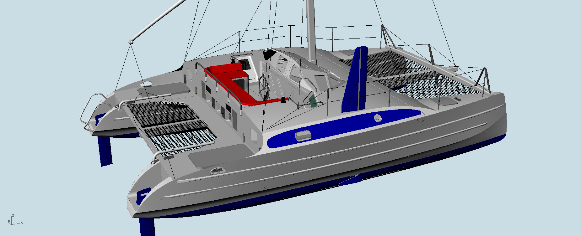

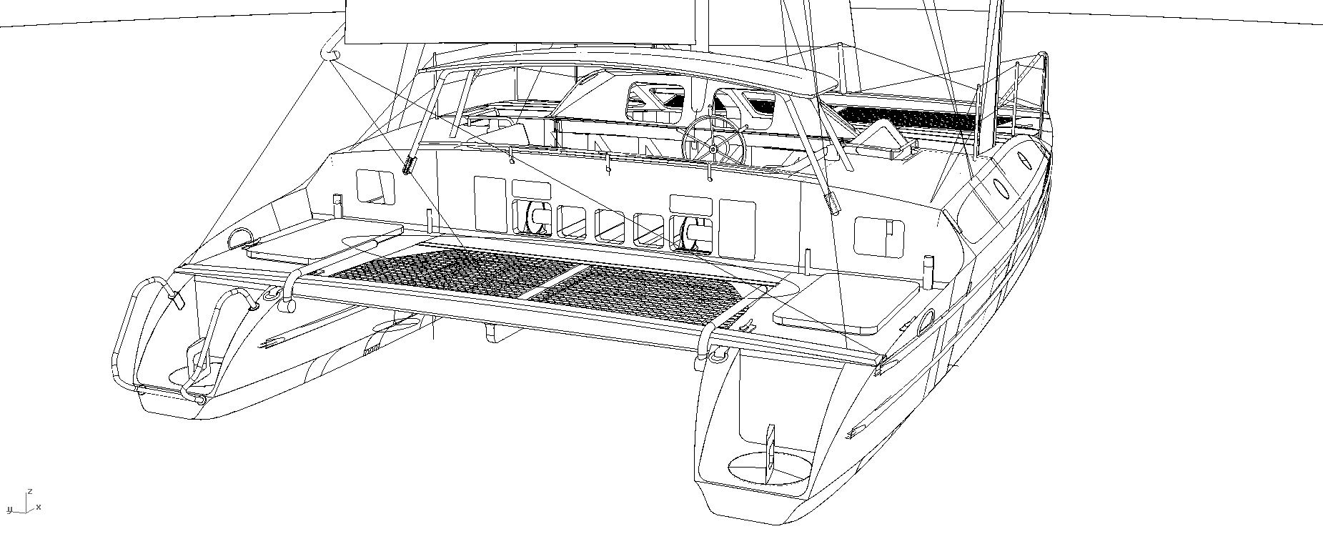

    limited space
    The bridgedeck is at 32 inches...812mm...maybe 30 inches fully loaded...the only accommodation I fit above deck is beds. Regarding clearance: from what I read more is better (at the cost of space for accommodations)...I may be aiming at too much. It does seem that the consensus for a boat this size is more like 600mm. Changing that would be a huge shift in the design limits. It may be that I'm designing for conditions the boat will never see...I took features from
    http://www.multihulldesigns.com/designs_stock/36ccat.html
    I already have a building space 36' by 36' (a metal Quonset hut)...with our climate it needs to be a permanent insulated structure...the winds here would destroy a temporary structure in no time (the barn next door had its back wall blown out when they left the east end open less than a year after construction), and the temperature average for winter is around 20F at night (extremes to -20F)...we get a couple weeks of 100+ in the summer, 90+ for the rest, with brutal sun. If the space were not insulated it would be unusable half the year.
    Moved the lowers inboard and made more room for the foresail.

  8. catsketcher
    Joined: Mar 2006
    Posts: 1,306
    Having more bridgedeck clearance is almost always better, mine is 860 down to 660 under the trench. I would ensure your bunks have 1000mm over them so you can sit nicely on them.
    If you really want some more length then your rudder design gives scope for this. I would rather have kick ups instead of your barrel rudders but you can get both. In Chris White's book he shows a cat hull stern where the entire aft section of a hull pivots up. Your hull could pivot at the deck from behind the aft beam - giving a fuse to the barrels and also a way of detaching the stern during construction. I am thinking of something similar for a project of my own.
    You could build one hull across the shed - diagonal 50ft. Make it the length dicated by shape required to carry the load - it will never be cheaper to make the boat longer than in the shed. Then make the stern hinge so the rudder don't break when they hit something and take it off after fairing etc. Store it along one side (or outside) till you have finished the second hull and place the aft sections somewhere else in the shed.
    Start with weight then design the rest.
    cheers
    Phil

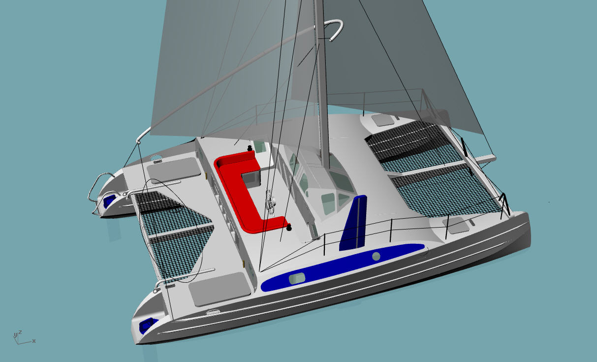

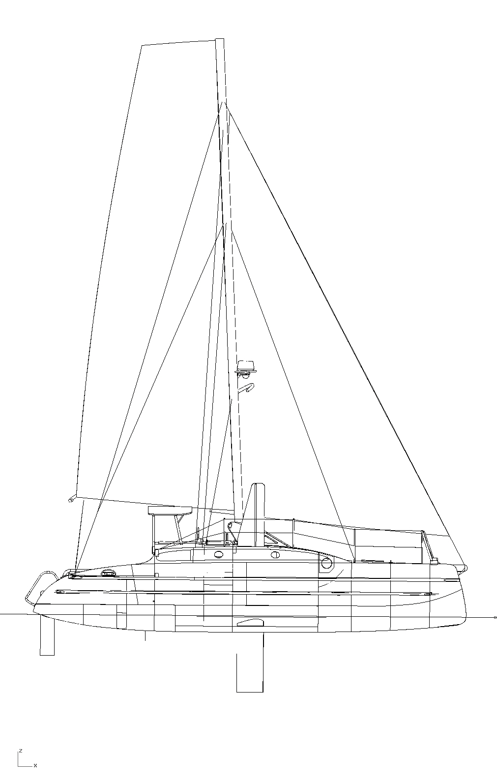

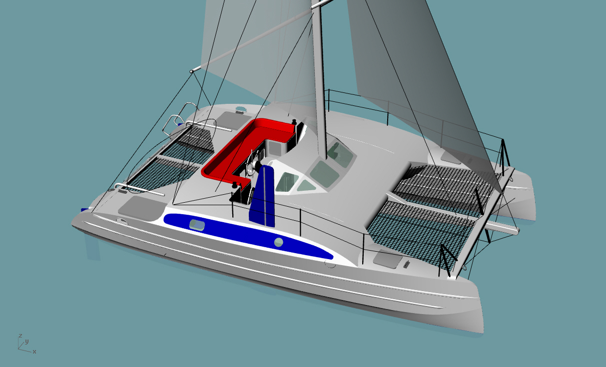

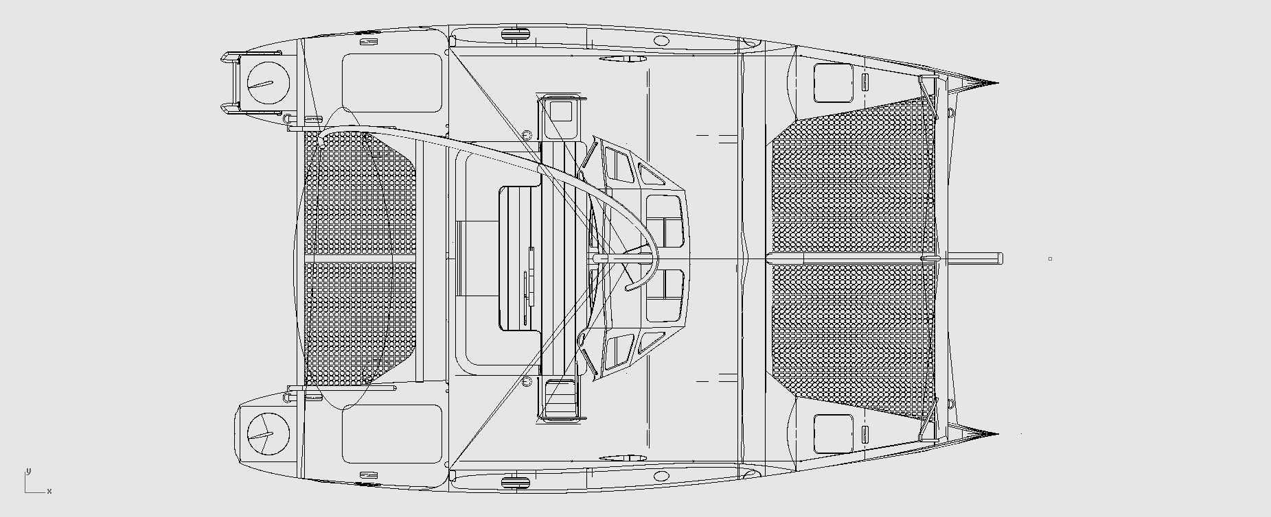

    latest (hopefully, final sail plan)
    I have arrived here.
  10. waikikin
    Joined: Jan 2006
    Posts: 2,378
    waikikin Senior Member
    Hi BobH,
    now if you just bring the cockpit aft & close in the targa you will have arrived close to many other cats;)
    Jeff.

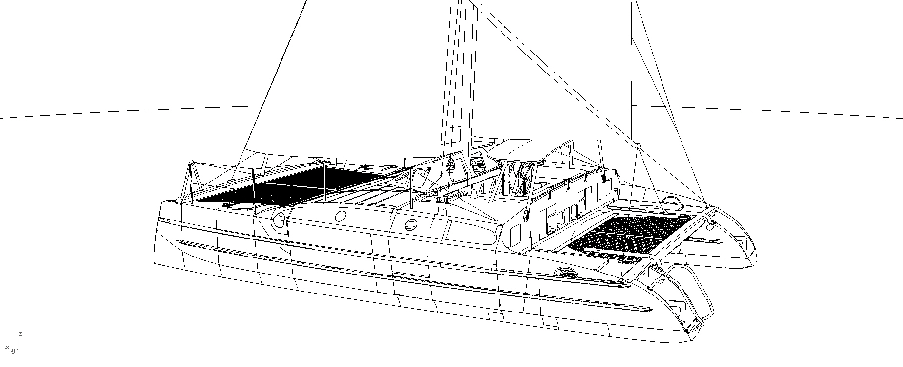

  11. John Perry
    Joined: Nov 2003
    Posts: 281
    Likes: 30, Points: 28, Legacy Rep: 129
    Location: UK
    John Perry Senior Member
    The wishbone boom, actually a half wishbone I think, is a nice idea and one that I used on a much smaller boat many years ago. Catsketcher (Phill's) posts confirm that it can work well on this type of catamaran.
    I thought it worth pointing out though that a conventional mainsheet with a track can contribute significantly to maintaining forestay tension, with the wishbone boom you loose that effect almost completely. That could be particularly important with a rotating mast (although I realise that you are not proposing that), since I think it can be difficult to maintain forestay tension with a rotating mast supported only by cap shrouds.
    From your drawings it would seem that you are including running backstays, I would guess that these could make up for the lack of a conventional mainsheet.
    Your design looks promising to me and it is significantly different from the run of the mill cruising catamaran in that it does not attempt to provide a big lounge/galley on the bridgedeck, so allowing good clearance under the bridge deck and a low profile. Probably also a bit lighter not having so much cabin and furniture on the bridgedeck. One minor point is that if I am interpreting the drawings correctly, there does not seem to be much provision for natural light in the hulls which are the main accommodation - just small portholes and aft facing window.

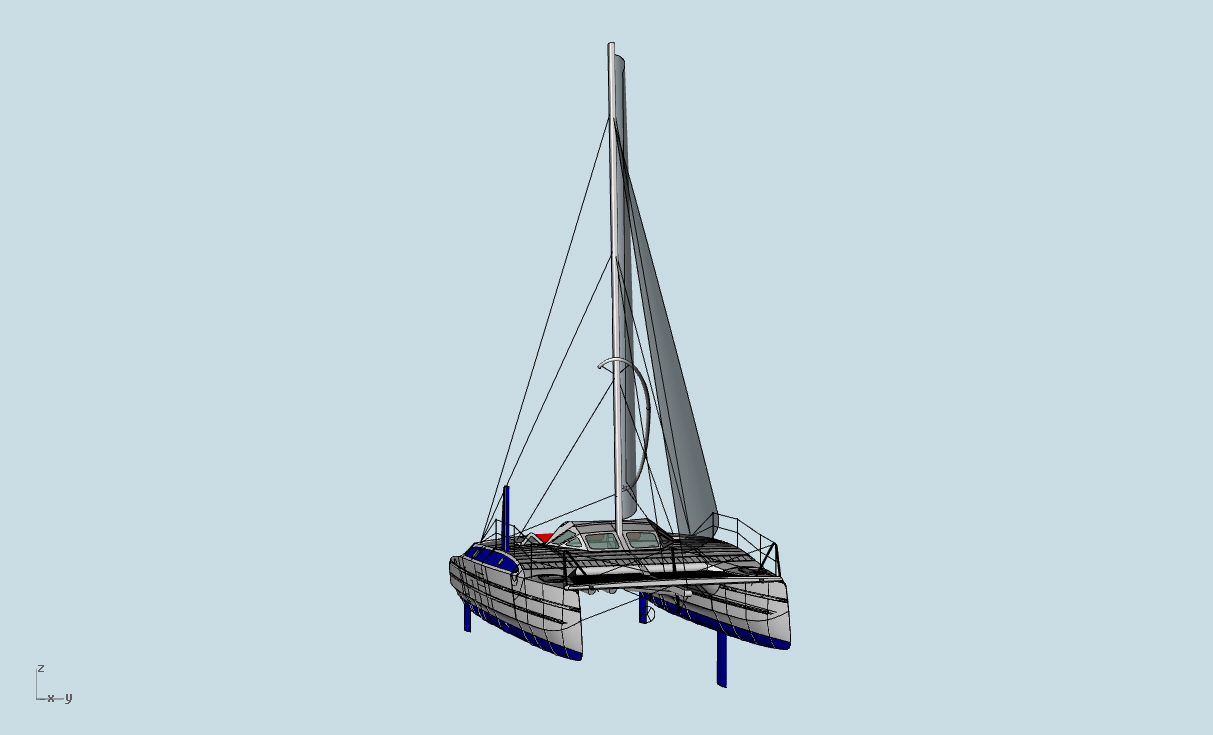

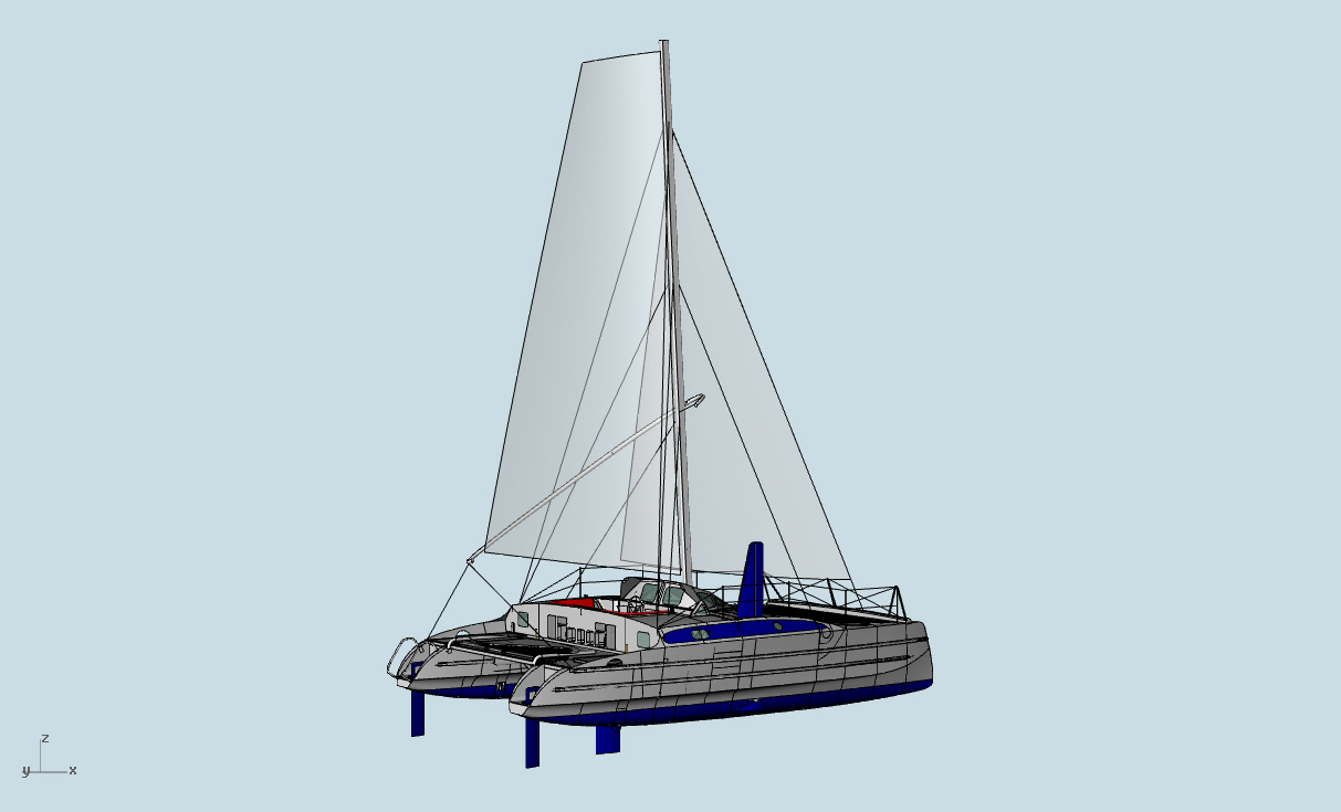

    rig
    The rig design draws on several sources. In particular, the cutter/wishbone from Chamberlain (brought to my attention here by Phil's advice) and the opinions regarding cat rigs expressed by Kelsall on his site (http://www.kelsall.com/TechnicalArticles/TheCatRig.pdf). Kelsall's recommendation for bringing the shrouds forward and going with runners to allow a greater arc of movement for the main while providing good tension in the forestay makes sense.
