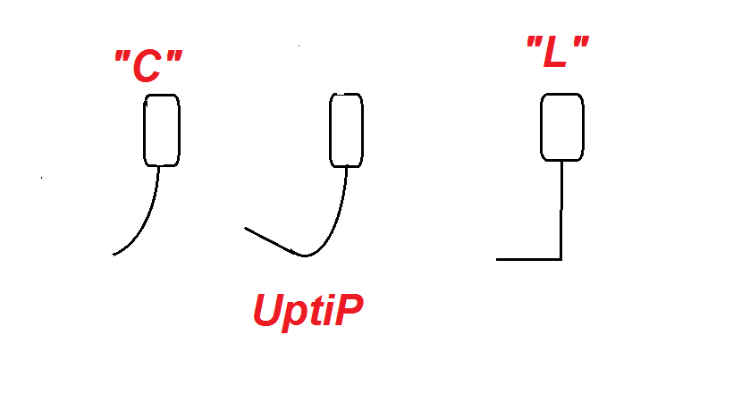

    The floats will have high freeboard to encounter chaotic wavepatterns. Thru heavy seas the boat will sail in static mode, longitudal trim will be controlled via inverted T- rudders under the floats.
    On flat water -flatter seastate-- the boat will fly on C- or L-foils and inverted articulating T-rudder under mainhull . ( Will this rudder be retractable --eleminating i's drag in static mode ?)
    Nothing new , everything is proven. No vulnerable gimmicks as permanent wavepiercing floats or wands for each ( additional ) horizontal foil that are useless in static mode .
    My opinion: they gonna keep it as simple as possible. they gonna design features for both modes as simple and safe as possible.

    Macif doesn't use "C" or "L" foils-it uses UptiP foils on the amas which are the only single foils capable of controlling the altitude of the hull they are on with no moving parts.
    These are nothing short of revolutionary foils that make it practical for a large trimaran to fly. Macif may be the first full size trimaran to use one on each ama-Gitanna was the first full size tri to experiment with and UptiP foil on one ama-a "C" foil on the other.

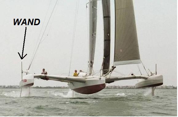

    By no moving parts I meant no flaps or active ,constant AOI adjustment. The foil itself will have to have a system that allows rake adjustment to change the AOI infrequently -and to retract the board. A refined version of an UptiP foil will not have to be constantly adjusted. It is the simplest type of single* foil that also controls the ama altitude automatically.
    * another single foil that could control altitude would be a foil with a wand controlled flap or where the AOI of the whole board is controlled by a wand/feeler(Hobie Trifoiler).

    I find it hard to believe a wand system similar to a hobie
    cat design you mention [ bracketed ] and the photo would survive the southern ocean giant boat destroying seas.
    They would not with stand solid or white water hitting them at 30 mph or more.

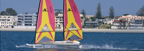

    I was certainly never talking about a wand system similar to a Hobie cat-there is no Hobie cat that uses wands! The Hobie Trifoiler uses "feelers" that stick out in front of the boat and move the whole foil. A wand similar to my Fire Arrow is what I was talking about but better than that would be an electronic system and maybe even a electro-hydraulic manually controlled system.
    Dr. Bradfield used dual wands on his 40' SKAT an they may be able to be scaled up but there is probably a better way to control lift on a big boat.

    Sorry about that I automatically thought hobie cats as I did not realise hobie has designed and built a trimaran by that brand name.
    Hope you accept my apology.
