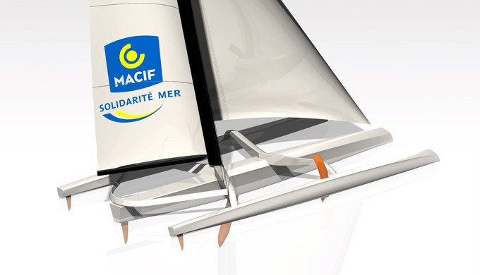

    It looks like the new Macif is going to have a lifting foils and T rudder setup as well.
    https://youtu.be/4BEhHgklfs4
    There is also an article on Addonante.com but it doesn't go into much detail on the foiling aspects of the design. There is some interesting info on how the crew quarters are to be configured though.
    http://www.adonnante.com/33549-ulti...-focus-sur-les-innovations-du-trimaran-macif/

    It looks like they have decided to move the mast forward on Macif in the initial renders the mast was sitting on the rear beam or maybe the beams are just further apart now.

    Can you post the initial renders and url source
    Looks to me the mast is sitting on the rear beam.

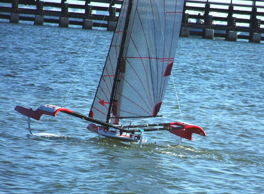

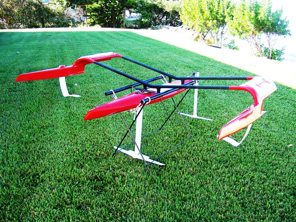

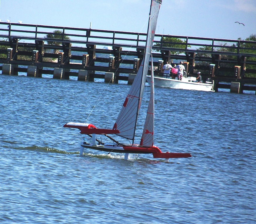

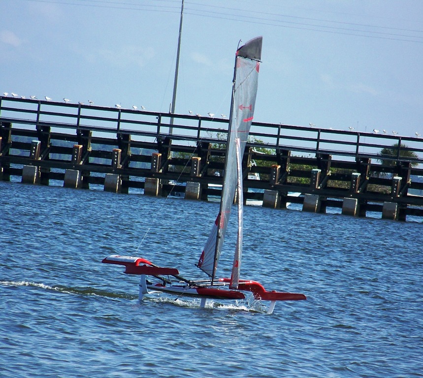

    Pictures below show a scaled down Test Model of a 19.5' version of the Fire Arrow utilizing the foil concept I have been describing. A larger version would have different proportions. The main foil and rudder foil are T-foils and mounted on the main hull. The ama foils are UptiP foils based on the breakthru invention by TNZ in the 34th Americas Cup. These UptiP foils are refined versions that require no adjustment while foiling.Last picture shows the port UptiP foil:
