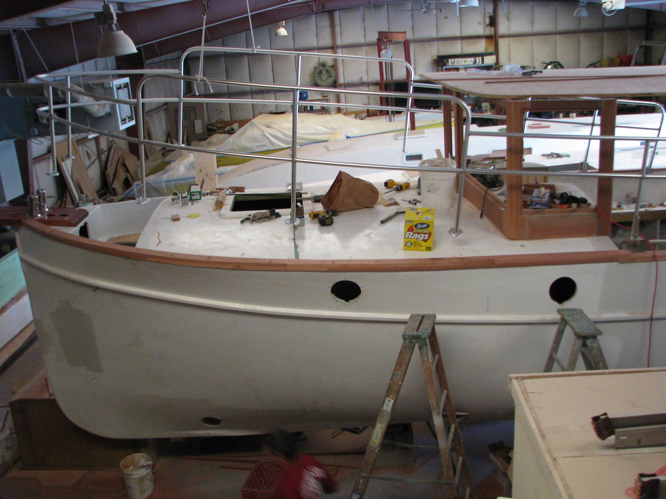

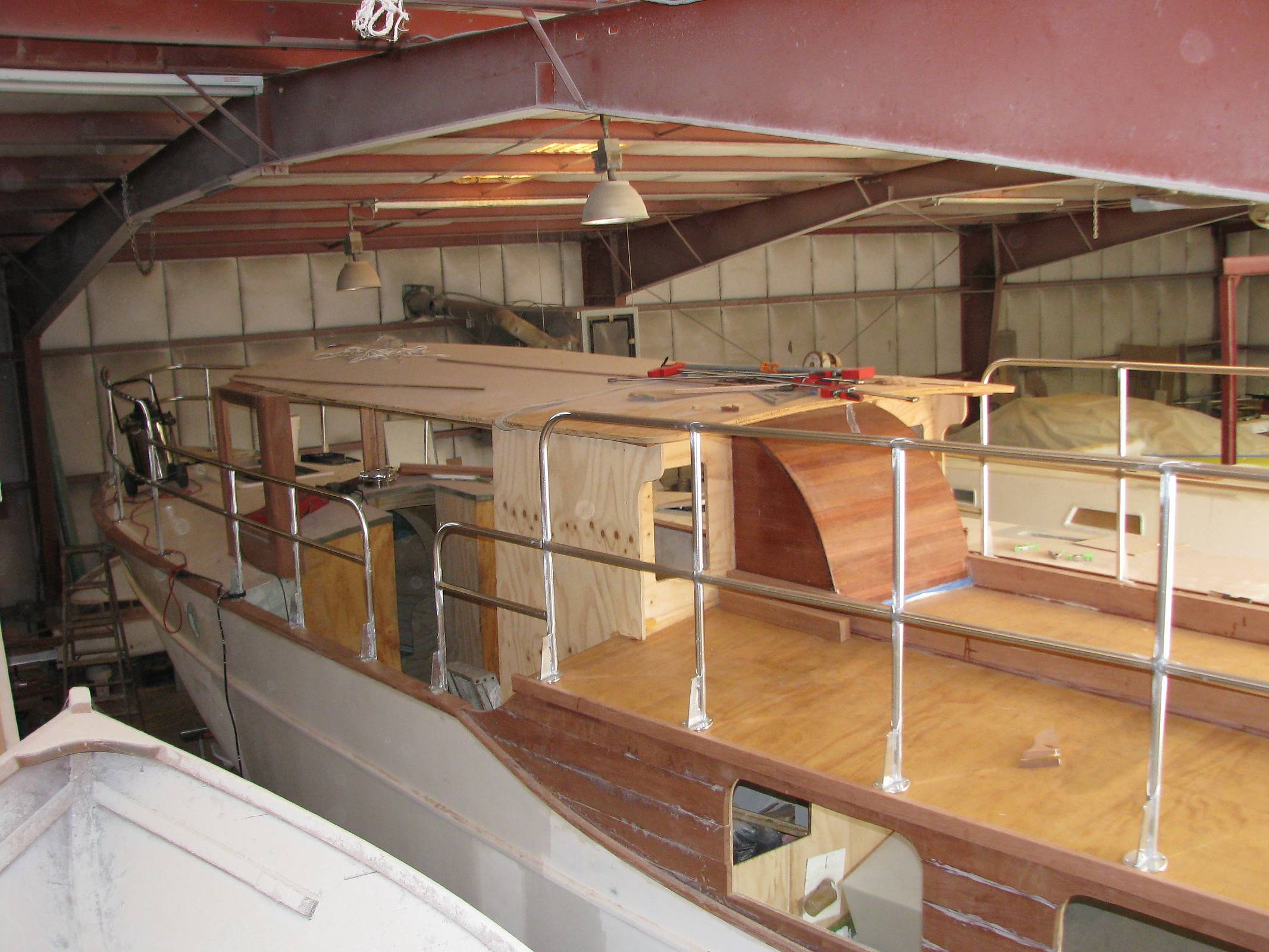

    This one is under construction now on Long Island, 42' by 10'3". The hull mold will be destroyed shortly if someone doesn't grab it.

    Very nice Tad! Getting sufficient hardware may require some scrounging but would be much easier I would think than restoring a broken hull. I don't suppose you can say who is building but is it a 'one off' by a professional or a hobbyist?
