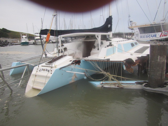

    Sorry, I would have been interested in reading it. The boat is definitely a Cross 37 the AA designation could well have been wrong just what was sent by the broker. I do have a few of the boat in its wrecked state though, a sad sight.

    Well that isn't a Cross 37 which was a early v bottom chined tri. That is a Cross with a transom/swimstep addition making it 37 feet. Some of the other measurements could help narrow down the model. It could be a 36R or a stretched 34, modified 32r etc...
    It looks like you could make frame patterns off the surviving ama and pieces and mirror image them. Despite what it looks like it seems a fairly straight forward repair with care taken on the beam ends and blocking of the boat during assembly.
    Jeff Turner would have stuff but nobody seems to be able to find him or Norm's plans. The Mariners Museum has some Cross stuff but it is from Nobby Clark's collection which probably predates this boat.

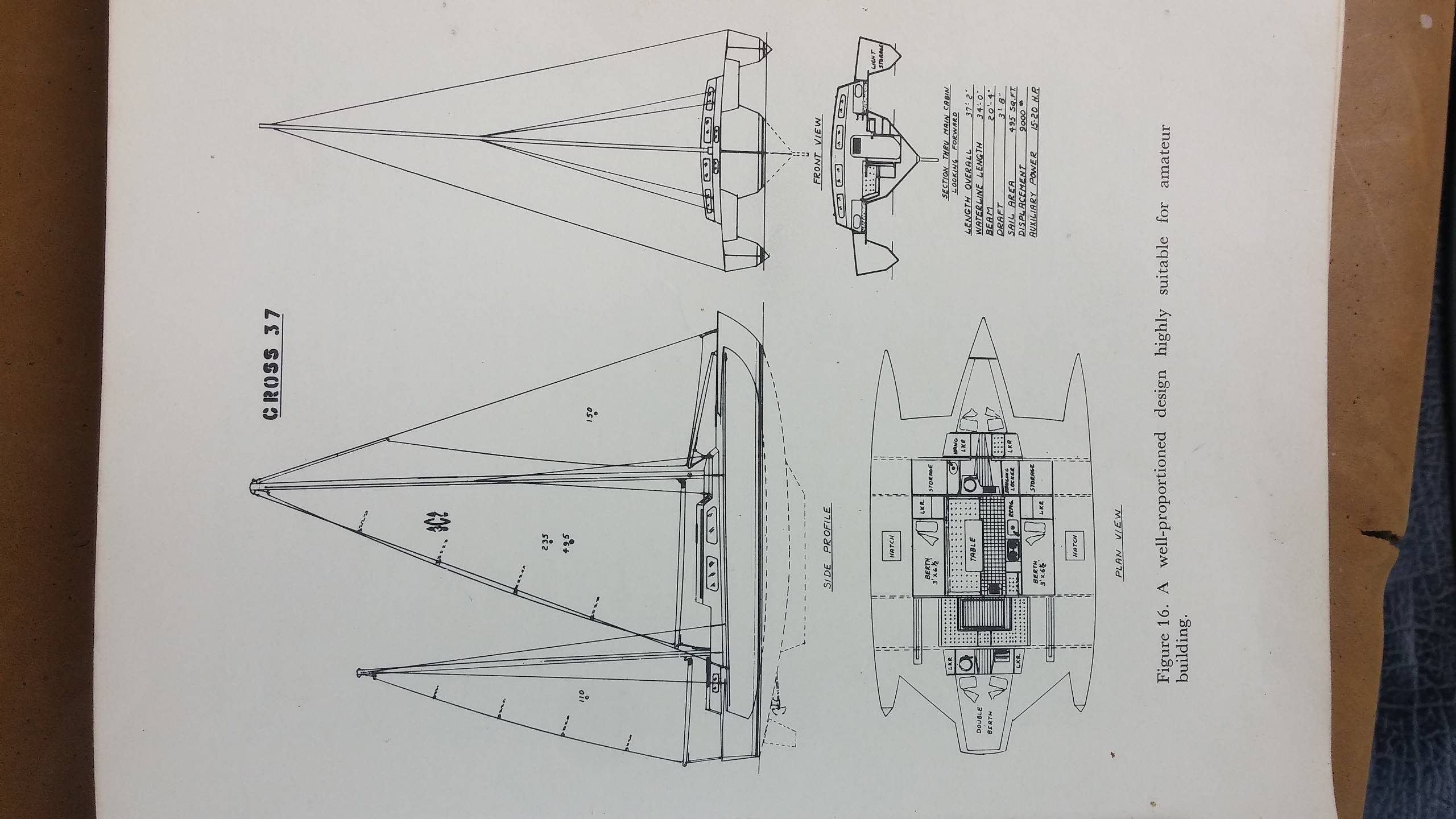

    For fun here aresome views of the stock Cross 37, a earlier design.

    Fair point the transom extension looks like it has been added later. It's a US built boat apparently. It listed beam at 22' in the advertisement.

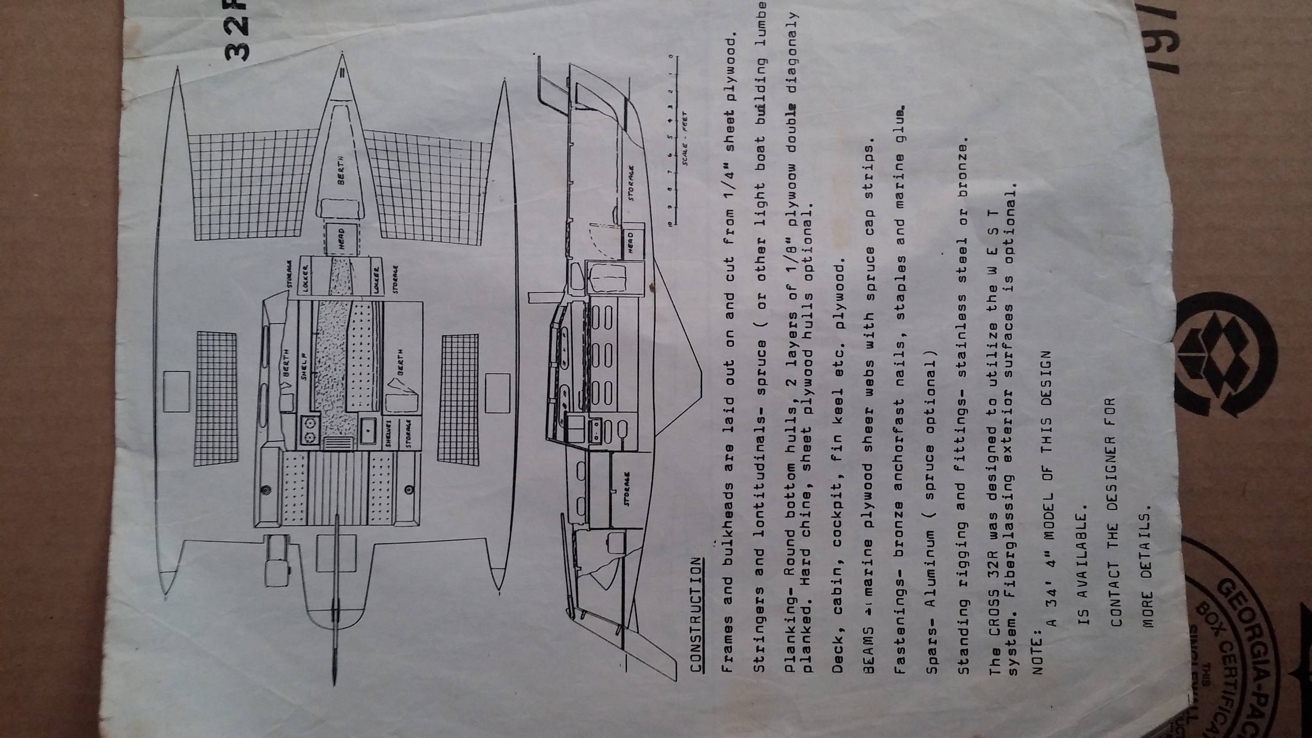

    This is the 32r, the only Cross I could find with 22' of beam. The 36r has more, the 34 mk2 less. Check out the part where it says a 34'4" version was available from the designer. It could be another design modified, check the main hull at the keel, if it has the coke bottle shape it is derived from the 32r for the aerospace "area rule" regarding foils. If it is straight, without the waist I'd lean towards a modified 34 mk2. The main hull dimensions like beam and headroom would give the clue.
    The area rule was from Norm's time in the aerospace industry. For super sonic planes the idea was to narrow the fuselage in the area at the root of delta wings to compensate for the section area of the wing. On a boat with a keel like a Cross this keeps a high prismatic coefficient. The 32r is a quick boat, easily hitting double digits without a hump if not over loaded/ overbuilt etc....

    I know that boat, Seashine, she was something special! It is a 32r that was stretched at the transoms. It also had a modified keel that was hollow and deeper than the original. I know the guy who sold it to the Aussie that let it wreck. He had owned the boat for over 25 years and kept the boat in amazing shape! If anyone has the skills to put her back together, please do, she is an amazing boat, so fast! I can get in touch with the previous owner and answer any questions, he is heart-broken and would love to see his old boat saved!

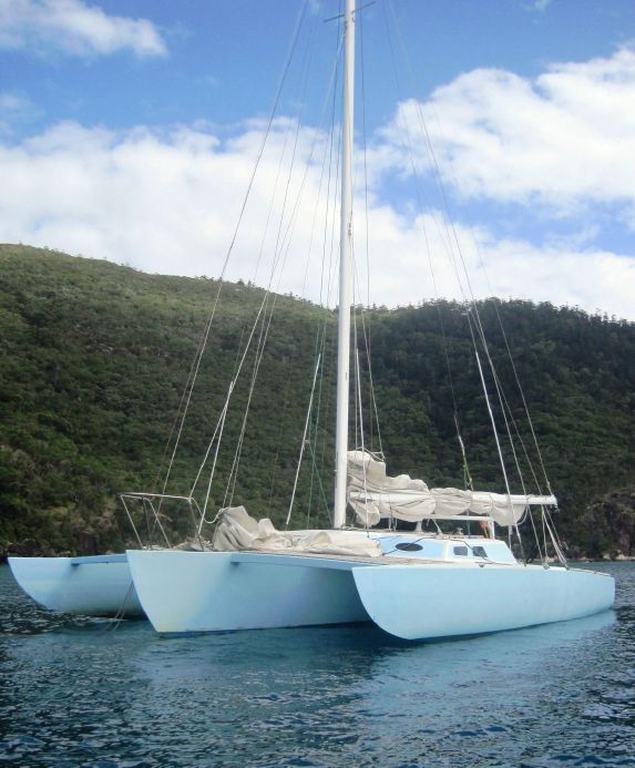

    IMG_0476.JPG Wow... great thread for us Cross fanatics.... I am living on a 37' Cross tri in CA, USA... She was built in 1966. She sails sweet. I would love to get plans for her...
