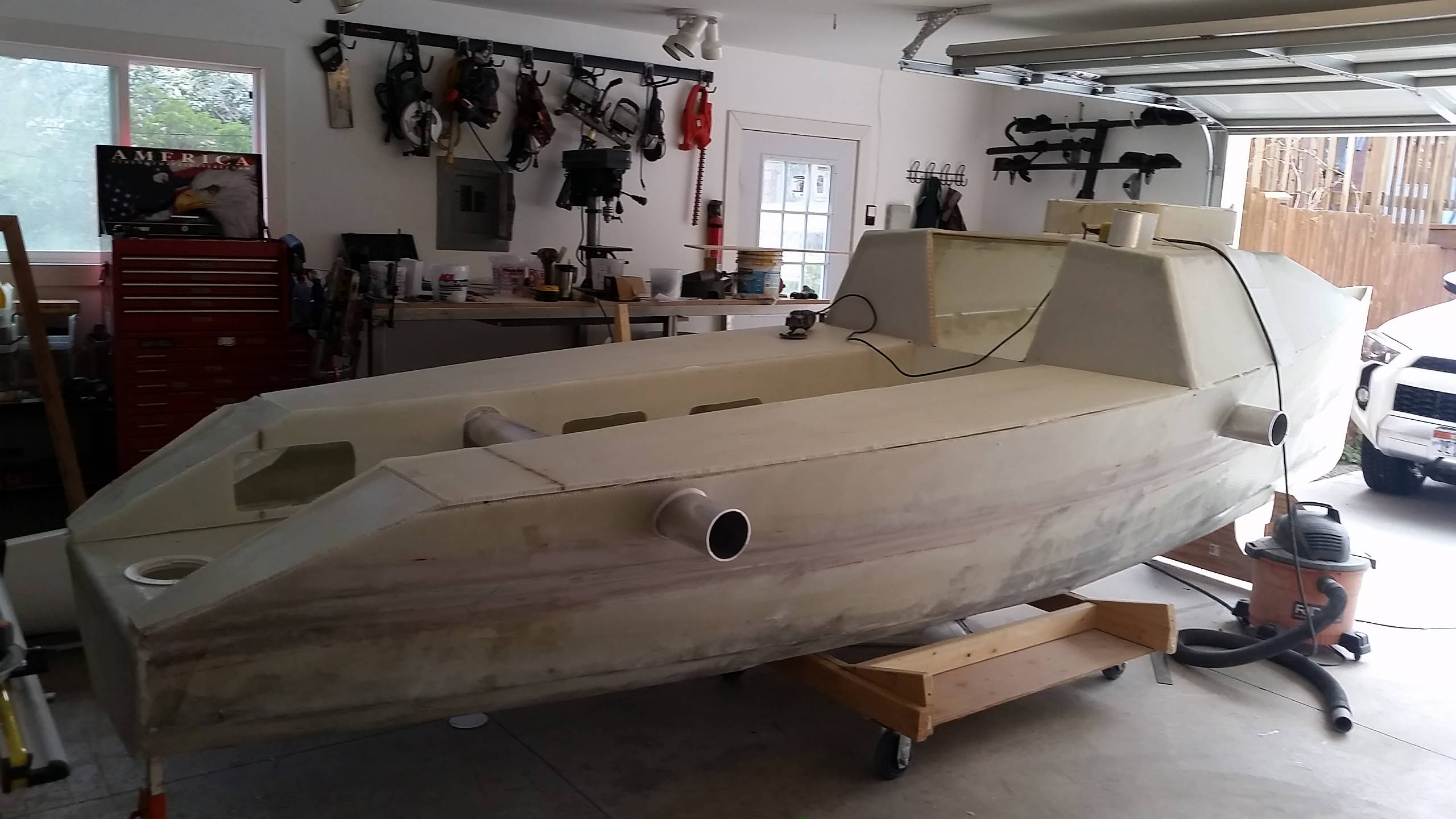

    This is sitting in my garage almost finished. It's 100% plascore epoxy and fiberglass. I've notice no material thermal deformation or softness in up to 100*F heat and sunshine. White color of course. I'll paint it white. It's a fine material for small boats IMO.
    Plascore was easy to work with, shipped and arrived on time. Price was good. And they can provide it already pre-CNC cut and pre-glassed with a variety of fiberglass options already done. I wish in retrospect that I would have done that.
    It can be harder to make joints in some cases due to filling the end of the honeycomb, but it's not too bad with the right consistency of compound. It probably also takes more epoxy because you need to wet the glass and the scrim layer. I have had a couple issues with starving the layup at first, but I've got it figured out pretty well by now. I ordered a bit of extra so I still have about 6 sheets left over. I would get a few extra pieces to experiment with. It's cheap enough that you can afford to do that.
    I don't any long term use to base an opinion on, but I will in a few years.
    What I can say is that it's extremely tough in destructive testing of sample pieces I've made.

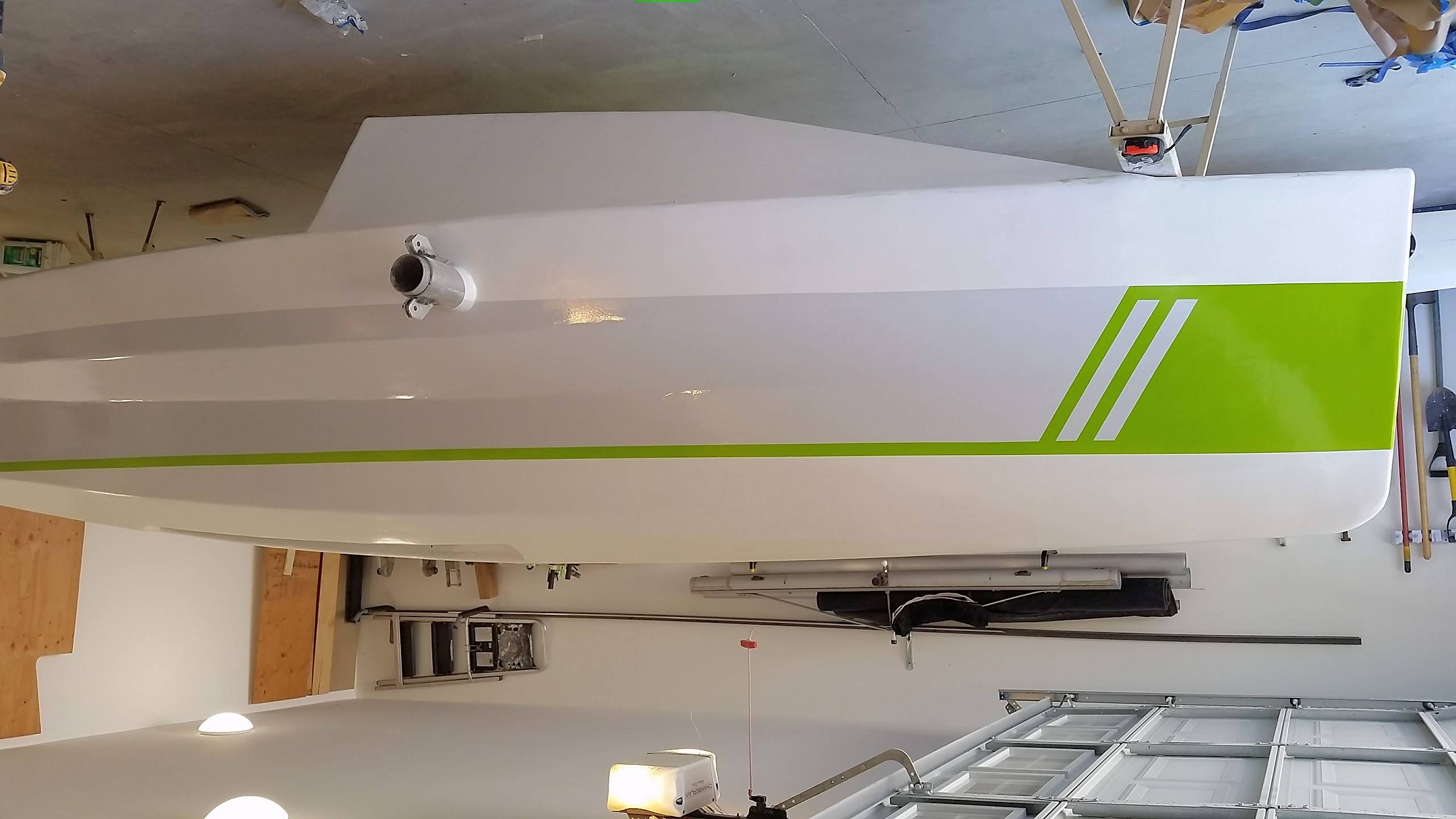

    All of my chines were cut at 90* to the surface of the panel. I cut them using a following router with a fiberglass specific bit and wood patterns. The joints are filled with an epoxy bog in a one step process. The exposed ends of all of the cells that are cut are filled along with the joint. Then while still pliable I wet the joint and apply a 6" wide biaxial tape. The final joint requires some, but not a lot of additional fairing. The lower portion of the hull has an additional full layer of 12oz biax.
    The plascore works very well. I have found no issues so far with delamination. The adhesion to the core is to a bonded veil fabric. It's as strong or stronger than any adhesion to foam I've been around. Foam core doesn't stick to its self very well, so peeling back the glass is usually also peeling the first layer of the foam. The internal strength of the PP honeycomb in tension is probably orders of magnitude greater than PVC foam. But the failure would be the vail to core bond. If you infuse, the mfg will leave periodic spaced cells open to fill and create direct epoxy bridges between the FRP on each side. I did not do this.
    Here's a pic of the boat on the water:
