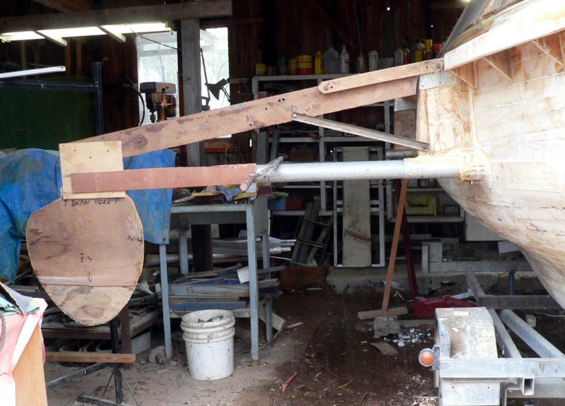

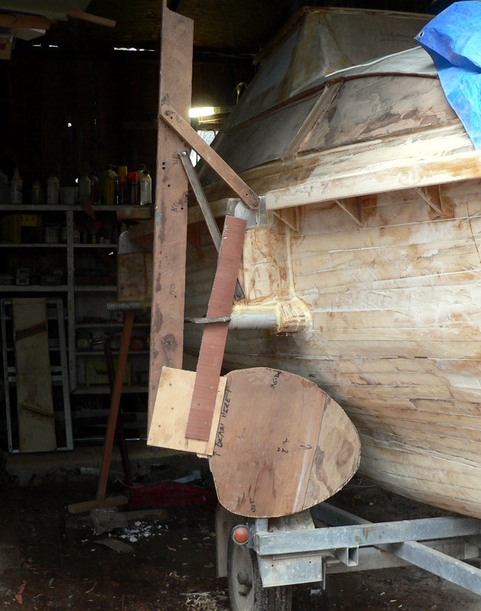

    The Farrier system can be replicated fairly easily - see pictures of the mock-up that should certainly be done before cutting and fitting the real thing. The key is getting the angles and fixing points right - the mockup will prove that.
    Sure this does not answer your wish to have the amas remain vertical plane, but it does work. It would still be working if some helpful soul has not stolen everything moveable, then torched the boat

    Just noticed the Aussie mock-up of the Farrier system and his comment. Are you serious that someone actually stole the boat ! That must be the most discouraging conclusion to hours of work that I've heard ...my heart aches for anyone with that sort of luck.
    But the mock-up does serve to show a weakness of the system .. the relative lowness to the water of all the framework and protuberances that makes boats so fitted, wetter than they need/should be. Scarabs are the same and both systems take considerable cost, time-to-build and set-up to work properly. It's no wonder that Ian sold the system as a working set, but many years ago it was quoted at $6000 when I once inquired. Once set up, the Farrier original does work well though if the added spray doesn't bother you. The Pros and Cons are covered in an article on my website if needed. Cheers
