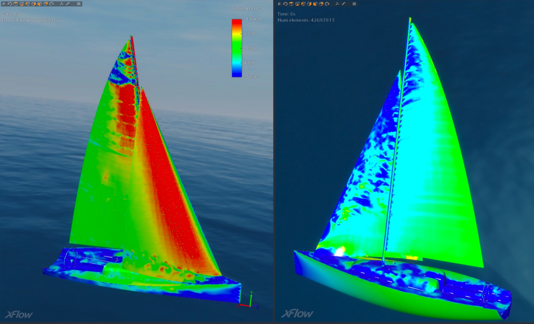

From what I have seen, the proposed sail shapes perform very well, when analysed with CFD, even very different shapes providing quite similar results, as you state in the manual. On my wish list in the OUT-result file would be the mainsail and the jib CL & CD, easily integrated from the given Cl & Cd distributions. This would highlight the role of the main vs. the jib, as the jib CD is often close to zero, very much different from the ORC sailcoefficients, for instance.

In my program, the induced velocities caused by the free and bound vortices of the sails and of their mirror images are calculated using the Biot-Savart-law. In addition, the effect of the streamline curvature is taken into account. As a result, the flow field for each sail is quite different from the undisturbed onset flow. The resultant force vector at the jib is rotated forward, whereas the vector at the main is rotated backwards. One consequence is for example: If you leave everything unchanged and just reef the mainsail, the force on the jib will change and its drag-component will increase.
