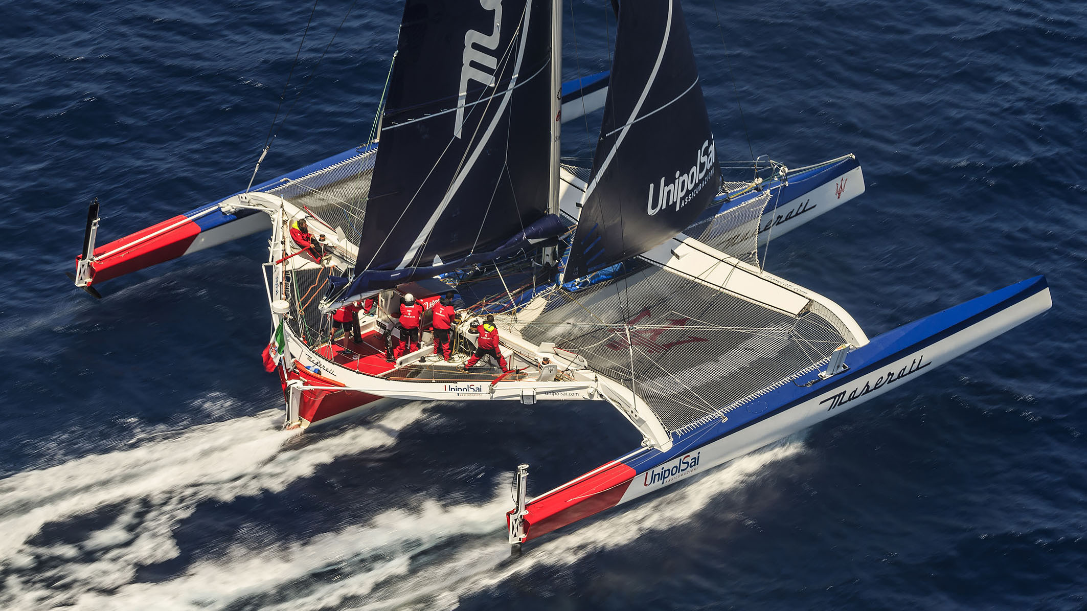

    Maserati with Fire Arrow Configuration
    Maserati using the basic Fire Arrow System 7/18/16:

    Fire Arrow Foil System temporarily gone due to a serious collision with an underwater object which literally tore off the stb rudder and foil, rudder post and bearings! Since it was the stb side(where they have an uptip foil) they may have had to remove the main foil as well because without the rudder foil the main foil and uptip foil won't work. Too bad for the Team! http://maserati.soldini.it/maserati-multi70-in-malta-with-severely-damaged-rudder/
    They don't specifically say they removed the main foil. They may be able to leave it in with very little to no lift on it. The stb uptip foil has to come out. And they were already sailing w/o the port uptip foil. Imagine -one collision and 10 years+ back in time!

    Maserati without the Fire Arrow Foil System
    Thanks, Corley-their site has been down all day. I read there last night that they removed the stb ama foil and I guess they're using the same "C" foil they have in the port ama. I'll be amazed if they get the stb rudder fixed but I guess since they're not foiling they could do without it? I just saw what they did with the stb rudder-what a job!
    I was sure looking forward to them being able to fly during this race and I know they were too-damn shame.

    Not too hard to see why it failed, the back half of the rudder bearing was totally unsupported!

    It seems to be an intentional design feature for controlled failure, at least by looking this photo: https://pictures.dealer.com/m/maseratiofsanfransisco/1011/e2a9a428fe760d1f67326dff0d160173x.jpg . The structure around the rudder bearing is thin and elastic, resembles a terry-clip. It was made to let go at impact, IMO.
    After all, the hull structure has remained undamaged, only the C-shaped rudder stock bearing seem to have failed during the impact. Hence the repairs will not take too much time and the repair costs have quite surely been contained in this way. I say it was a smart idea.
