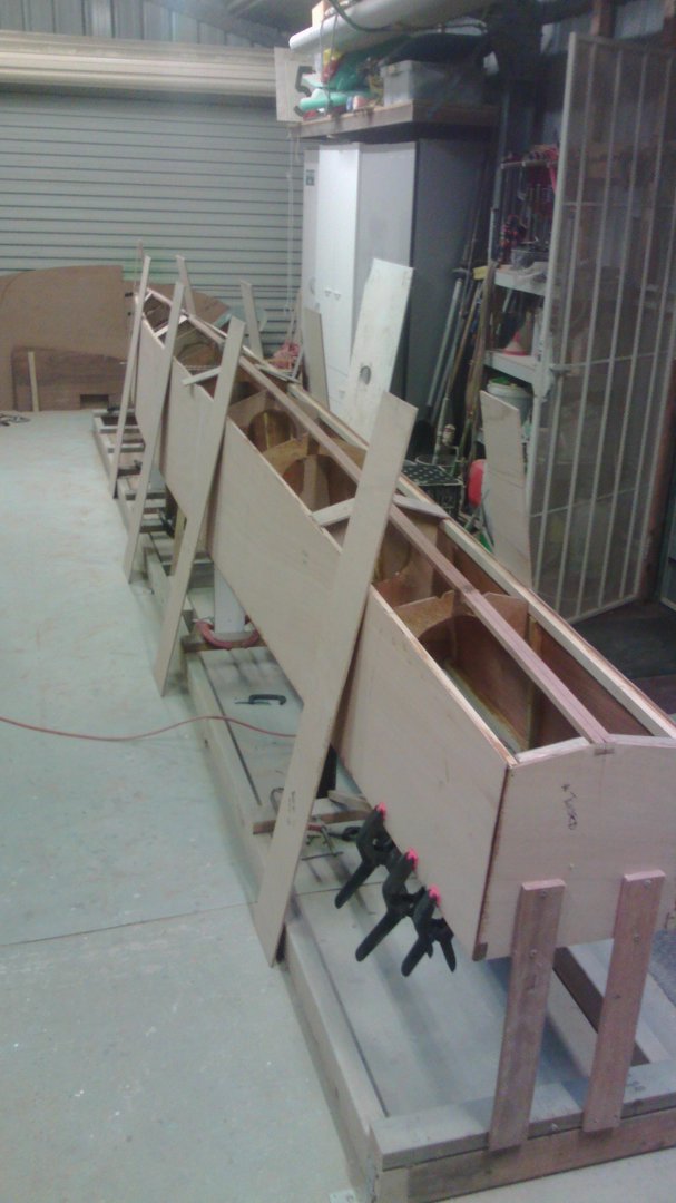

    I've just received a further update from Len Surtees for his Sting 600 project:
    "Sending this from a remote mine site, here for two more days then home to ready for launch.
    Have attached photo of stbd hull (and port bow ) showing bottom skins ready to fit, then f/g and paint then turn over, fit decks, f/g ( just use light weight surf board cloth which is easy to apply with epoxy and minimal preparation for painting ).
    Once this is completed, fit to swing beams, connect nets and ready to launch.
    I expect to launch at end of this month then I will update web site with photos and hopefully some video clips.
    Then all efforts will be to complete f/g molds of all foils, then sailing trials.
    I have redesigned swing beams in plywood and timber and they have been approved by structural yacht engineer.
    This will save thousands of dollars for owner builder but I will still supply foil wings and optional composite dagger board and rudder.
    The price of plans will increase due to added work and costs to me for inclusion of swing beam details.
    All hull frames will be full size along with metal components and rigging set up plus build material list and trailer dimensions. Also many construction photos and useful hints to make building more enjoyable."
    I'm really interested to see this up and running as it seems to tick virtually all of the boxes I am after. I will be interested to see it in some chop and powered up though - I like the Weta frames with struts so the beams are further out of the water.
    I found that having a similar approach on my "Isoproamaran" frankenboat was really useful to keep the beams out of the the chop when powered up. The floats scythed through it really well when really powered up and keeping the beams higher made it a bit drier but reduced the drag considerably.
