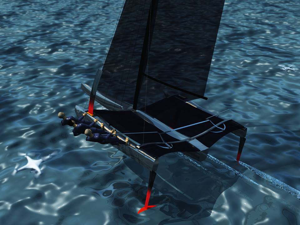

    Super Foiler
    This is a wild new(under development) wannabe foiler from Morrelli and Melvin. An uptip foil in each ama and a rudder t-foil in each ama.......no more details yet.
    "Welcome to the home of the SuperFoiler Grand Prix. After more than 18 months of work we are now airborne and have locked away the design of the SuperFoiler with Morrelli & Melvin. Featuring unprecedented aerodynamic & hydrodynamic efficiency along with a maximum possible power to weight, the SuperFoiler will be the focus of a fully televised circuit of racing commencing in 2017. Keep up to date here over the coming months. ‪#‎superfoiler‬"
    http://superfoiler.com/
    https://www.facebook.com/SuperFoiler/

    Clearly designed to be a 100%-foiling "trimaran" - certainly not what I'd expect from M&M for a Trimaran ;)
    But then again this is a one design destined for commercial endeavor.
    Will be really interesting to see those shorty ama bows work IRL

    Super Foiler
    The foil system looks just like a cat system. Bound to be fast considering the designers. I guess-depending on how light a wind it starts to foil- the amas or main hull ,for that matter, won't have much relevance to the performance of the boat?
