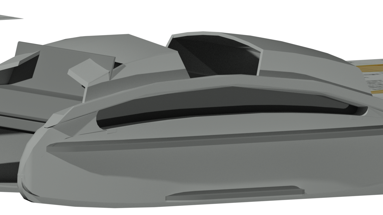

    I enjoy reading this site so I decided to join in. I do like all the professional insights and I could use some guidance.
    I am not really a designer but a dreamer. I have architectural design experience and I work as a civil engineer therefore boat design is something that I have only played with and dreamt about. But it is time as I am building my shop and gathering my tools.
    I am planning on a retirement build of a “one off” 32 feet long cruising cat. Construction will be using simple building insulation foam (1-1/2" Owens Corning FOAMULAR 150) as the stay in place male mold.
    I've worked with this material before and I can cut it quickly and accurately with a 3 axis CNC table. All parts of the boat will be milled and glued in place and then faired with a hot cutter/epoxy fill. I refuse to spend any time with sanding and fairing… what we get out of the foam is what is going to be covered with glass and painted… done without any after thought of “does this look straight/fair enough?” Who are we to say what is ugly? Ugly is just in the eye of the beholder… most times not found within the mirror.
    I’m not even going to fair different layers or thicknesses of glass but will try to make natural breaks between areas of different thickness like between the area below the waterline and the sides of the hull.
    I want to build the whole build using nothing but this construction foam (glued and hot glued together) and then covering the exterior and interior with glass and epoxy (connecting the interior hull to the exterior here and there for strength). I am thinking to keep the boat light and well insulated from sound and cold/heat. There will be some marine ply milled on the cnc and then added to some areas for connecting equipment etc. Rub rails and the keel runner will be aluminum and laminated plywood and then glassed.
    The concept for this build is nothing pretty or award winning but utilitarian in nature where function over form rules. This will not be your father’s shipwright’s classic boat nor your great grandson’s futuristic flying cat but a realistic quick build. This is to be a live aboard with beaching capacity, good carrying capacity and to me comfort and safety rather than style. With that said no polished wood, chrome or beautifully polished hulls, but a simple battleship flat gray with little concern to cosmetics.
    Think of the MingMing 2 (https://www.youtube.com/watch?v=0jsPOlg7Ovc).
    Now apply this idea to a 24 foot class level of service stretched into a 32 foot cat for a family of 4… a cross between camping and RV life… a MacGregor type level of comfort without all of the prettiness of a production model.
    I would compare to a class C type RV. Not looking for resale value but most importantly rugged comfort without the total loss of speed. I want to be able to go places without fearing that we are over our heads… maybe an Atlantic crossing and definitely poking around in the Caribbean.
    I would like to understand why so many cats have their weight centered so far stern? I see so many power boats with forward cabins and yet most cruising cats are designed with the salon in the center with the cockpit in the rear. I have seen a few cats with center cockpits (at the mast) but never any front loaded cabins in front of the mast. Why can we not build with weight over the bow and stern equally?
    I’ve attached a conceptual sketch… with a center cockpit. This idea would have the mast at the rear of the front cabin and most importantly the owner’s queen bunk under the center cockpit at the center of the boat to limit the movement… same with the cockpit. Placing the cockpit and the mast at the center of the boat makes sense to me for easy sail adjustments with the added visibility 360.
    Am I just nuts?
    Dodger on that front cabin would keep spray down. And I want settees on the very front of the front cabin for reef and dolphin watching.
    With that said, here are my questions:
    First: Any comments on the arrangements and configuration of a dual cabin and center cockpit?
    Second: Any comments on the construction method? Anyone use this foam or something like it before? I am thinking cost, insulation, speed and strength of the build. The plan is to build the hull upside down from the water level up until the bottom side is 90% and then jacking up the boat higher to build the remaining boat upside down. I will use the cabin roof and the hard Bimini as a floor for working on the interior. I have a simple idea how to do this. I will use the inverted hull as the boat house to work out of the weather and heat. The idea is to have the boat to a solid point (75% complete) prior to flipping it so this would force me to complete a very strong structure as I will be working on top of my structure as I build… maybe a bit too heavy up high, but I will address this later on in the actual design.
    I plan on using a single center mounted outboard.
    Third: This may seem even weirder er… but why can we not design planing hulls on a cat. I want to design this 32’ long and 14’-15’ wide cat as a tunnel hull with 2 planing cats forward and a center hull aft which the engine will hang from. The cat hulls will continue aft but above the waterline as the wetted surfaced of the last 1/3 of the boat will be centered on a planing v hull with the areas between the outer and inner hull being the tunnel injecting air to create a lifting force.
    The bottom line is I want the cat to easily hit 30 knots under power on a smooth river or sheltered waterway.
    For the rig, I am thinking two modern freestanding carbon fiber cat sail as found on windsurfers… easiest as possible to sail for me as I don’t want my girls to think that sailing is too much work.
    This sounds like a dream but that’s what I am… a dreamer.
    Anyone have an opinion? Should I break out this into specific threads?
    Let me know what you think.
    Thanks in advance,
    BJD

  4. philSweet
    Joined: May 2008
    Posts: 2,414
    philSweet Senior Member
    The most obvious question would be what leads you to want to throw away all your actual materials experience and build a boat using materials you have no clue about? Excellent boats can be built using the materials, engineering, and methods you already know.
    Foam-cored composite builds are the last thing you want to consider for the sort of boat you have described. They are fragile, fussy, hard to engineer, tedious to build, and expensive. And you are basically screwed if you forgot anything in the design. You can't go back and bolt or weld anything to a foam sandwich hull unless you have already put in the reinforcing when you built the hull. So zero versatility over time.
    32' cats scream for plywood. If it were a bit bigger, you might consider steel or aluminum. Ferrocement is an option for you, but there are probably fewer than ten people who would accept such a boat if you offered to give it to them.
    Building a rough-looking hull is not any cheaper or easier or faster than building a reasonably good looking one. It is the fit out that sucks up money. Some 32' cats will have $150,000 worth of electronics and appliances. Some will have $150 worth. Some will have $30,000 worth of sails, spars and sailing do-dads, some with have $5000. But the hulls are basically commodities. Anyone can get a decent hull out the door.
    If you want a battleship of a simple 32' catamaran, look no further than the Iroquois MK1 and MK2.

    The simple answeris Nope, your material choices aren't appropate, but give the few details about stucture and general scantlings, you have quite a bit of rearch to perform. Foam/sandwich composites are not very forgiving materials to play with. Given the load paths are nearly all in the laminate schedule, you can see how gettig this right is impotrant. Once you've plowed through the weights, centers and scantlings work ups, you may wish your understanding of the hydrodynamic asspects of the design are also suitable, which given your questions suggests you have work there too. In short a fair bit of study and research or buying plans.

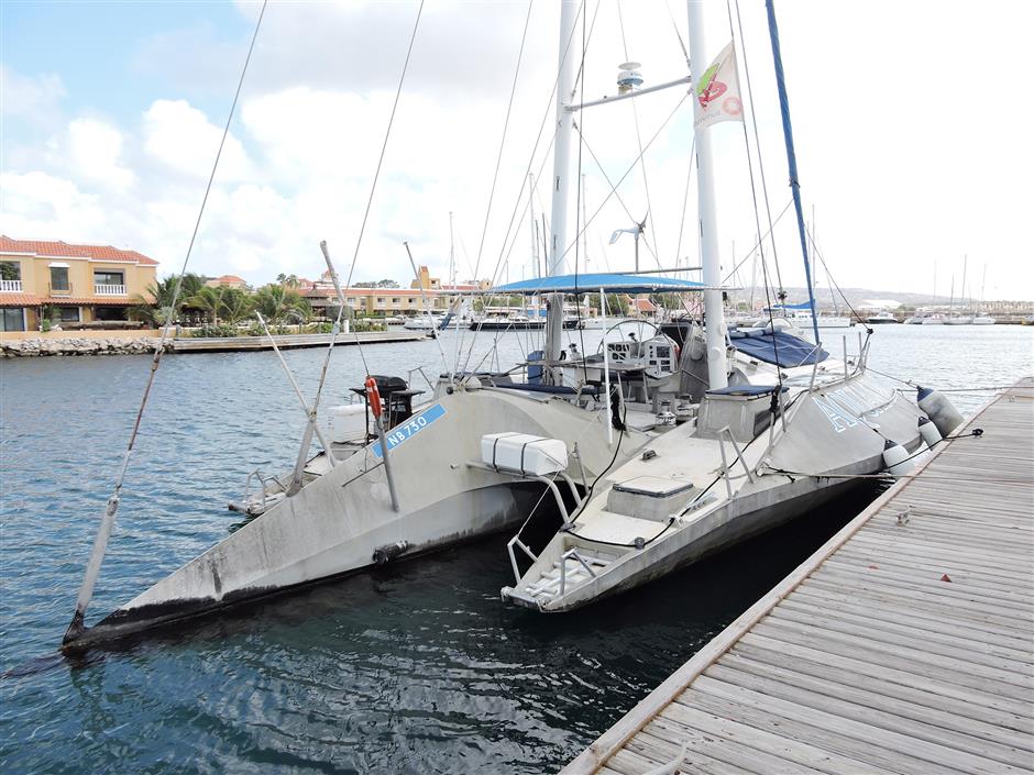

    quick example of function over form
    Thanks for the replies... this is just a quick example:
    Jacques Cousteau must have loved this design enough to build it... but none of our wives would ever let us purchase this (see below) ... most would call it ugly, but Jacques Cousteau called it necessary. So FUNCTION OVER FORM... not pretty.
    http://neffyachtsales.com/vessels/u...ing-sailboat-trimaran-glassbottom-boat-223866

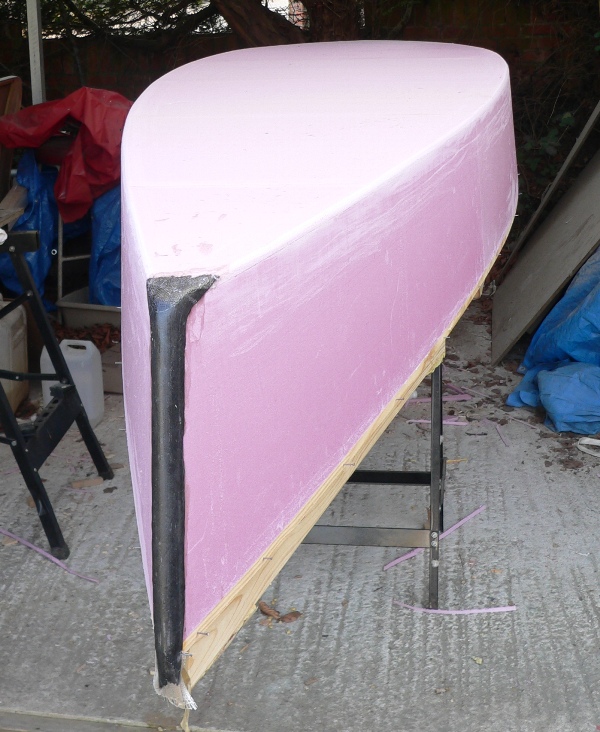

    Most of the desire is to build something different
    I want to build a boat... so I will, what and how is yet to be discovered.
    Someone mentioned a punt and I ran across this canoe built with floor insulation...
    http://uk-hbbr-forum.967333.n3.nabb...r-the-Cordless-Canoe-Challenge-td3777357.html
    Also below is a picture of my hero... thinking outside the lines. I like it.

    I assume you mean xps not eps foam. Eps is out of question, too weak. Xps is better but even that has weak shear strength. If you search there are a couple of xps threads.
    I have been playing with the idea of using xps core for a lightweight lake boat.
    I would never consider it for sonething that is an investment of thousands of hours and tens of thousands of dollars/euros.
