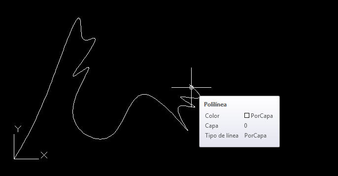

    Maybe things have changed a lot but what I've seen, if you look at a file with the commands to a cutting machine CNC, instructions are only for circular arcs and straight lines. There are no commands to cut a polynomial of second or third degree.

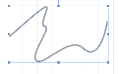

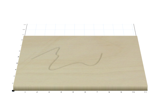

    I have a desktop CNC machine from Inventables that seems to be using Bezier curves to generate the paths.

    Maybe I have explained wrong. The curve may look like a B-spline but actually is a polyline.

    You may be right. There's a g code command for NURBS, but under the hood it's probably just a combination of line segments and circular arcs. In the longer term, I hope to be able to carve out a model of the boat, but it would be from thin flat sheets simulating plywood, so the shapes wouldn't need to be that complex anyway.
