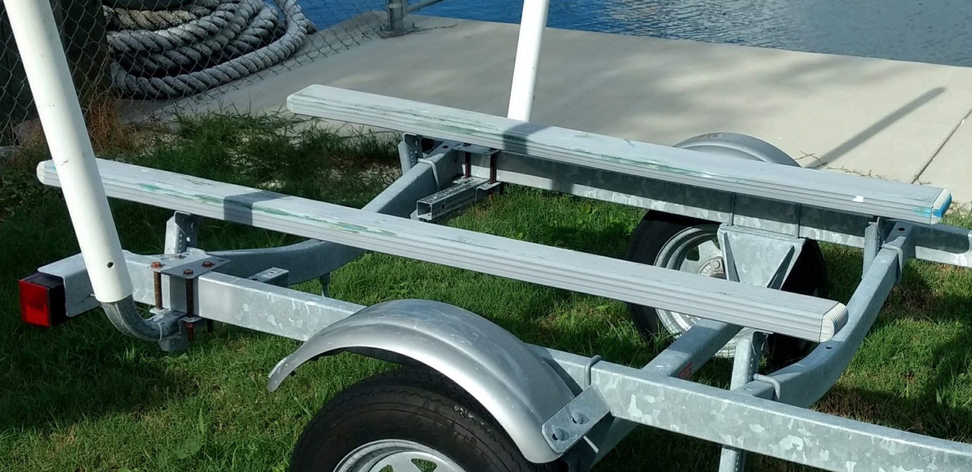

    I got a new 18' trailer for my skiff which had the bunks already installed. Usually they are pressure treated wood covered in bunk carpet. Mine look to be 2 x 6 and the bunks are encased in a vinyl sheathing with longitudinal ridges. Check Magic Tilt website.

    Are you looking for straight or curved bunks?

    These have to be curved.
    Right now the separation between the original transverse headers is 8'.
    That is too long, since the CG of the boat will not be over or behind the rear header when the boat comes off the front one.
    The boat would drop in the "hole" between the headers.
    But, I had a piece of 3/4" Red Oak 5" wide (10 feet) to try out the bend.
    Just had one piece.
    The red oak almost perfectly matched the contour of the boat. It sagged about 1/4" in the middle.
    I decided this meant it needed to be stiffer.
    So I'm going to move the fwd support position aft about 2' and do a test with both side bunks.
    I just bought White oak , again 3/4, and each bunk will be about 5 1/2 " wide.
    I had to get a new fwd support (2"x3" steel rectangle tube) because the trailer widens just after the original fwd support.
    So we will see how it works when I get it installed tomorrow, and the bunk boards cut.

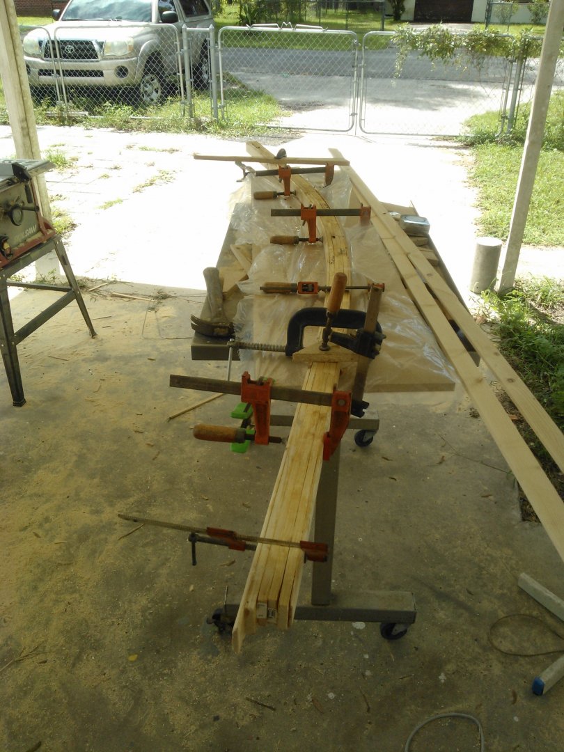

    Three layers of half inch boards, wet glued and covered with plastic drop cloth to prevent adhesion to hull, and placed on the trailer bunk supports would dry to shape of hull when hull is lowered but not strapped onto glued, still wet boards.
    Or you can glue it up off the trailer if you know the required radius. The example shown is my skiff stem made of quarter inch thick layers.
