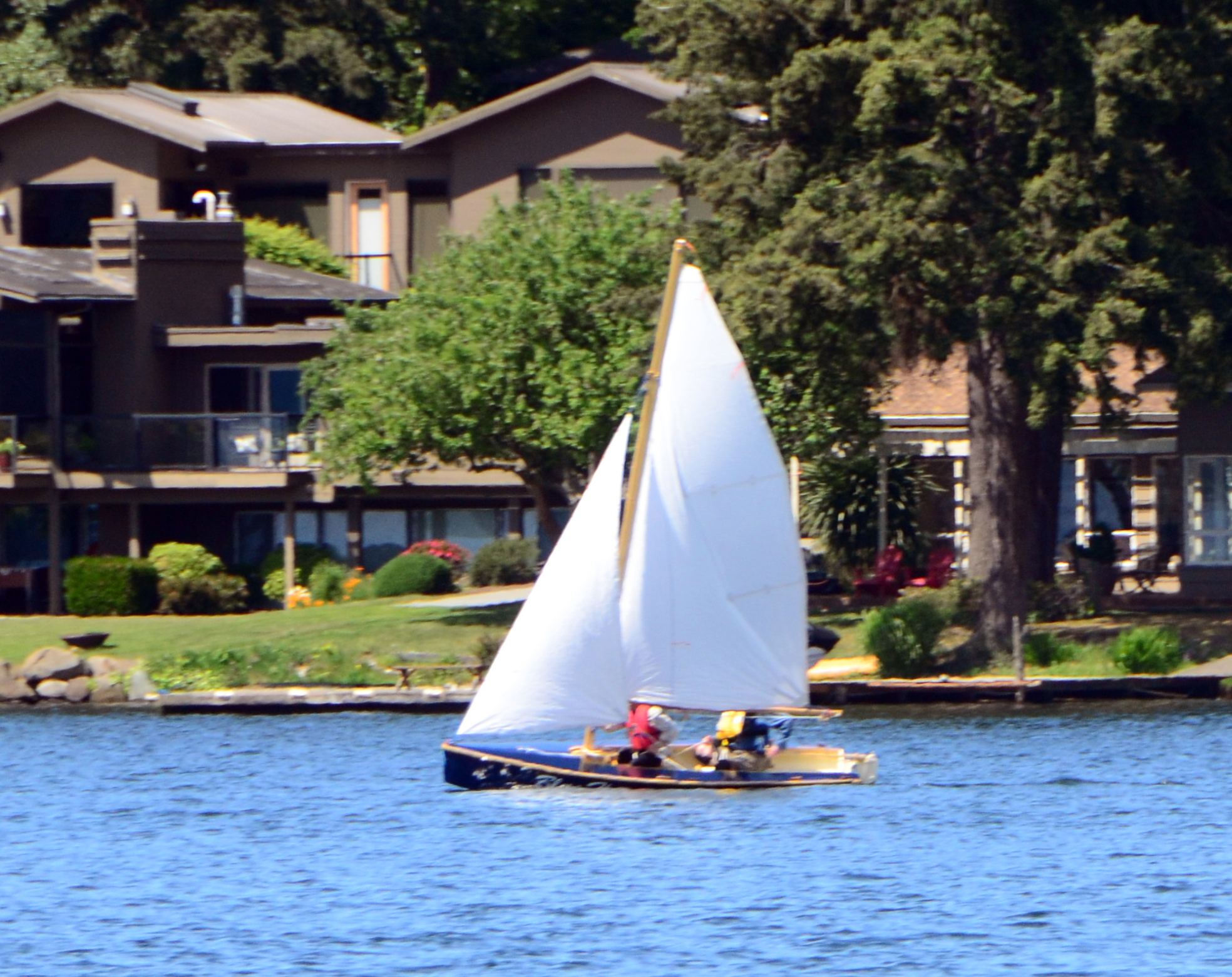

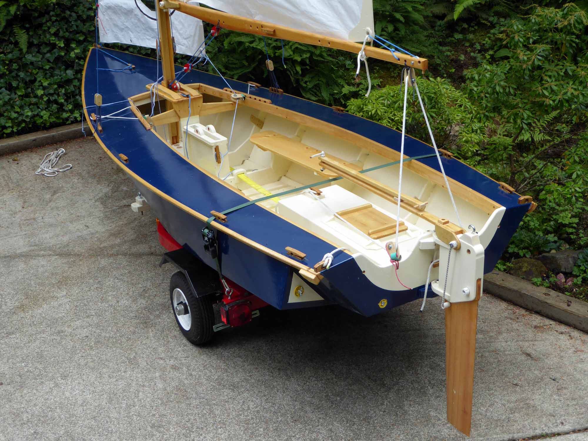

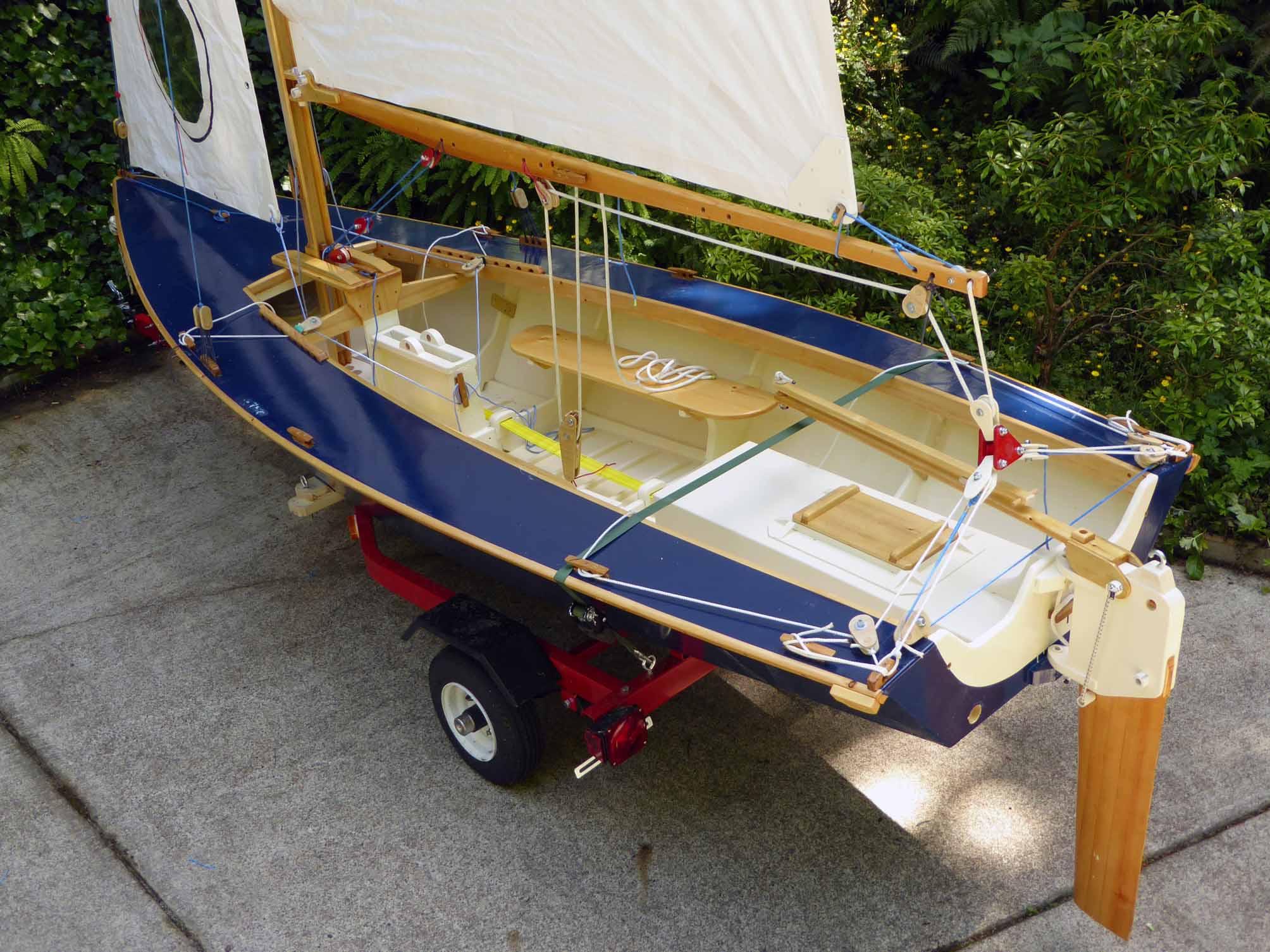

    The 2016 BLUE HERON
    The Blue Heron was designed and built to HW600 specifications. 5mm “underlayment” plywood, ¾ inch #3 pine, a couple of 2x4s, some ½ inch vinyl tubing and white polytarp for sails.

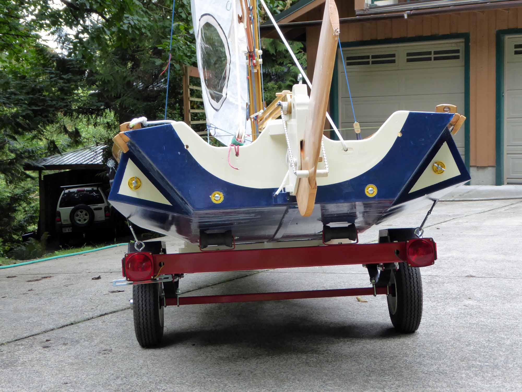

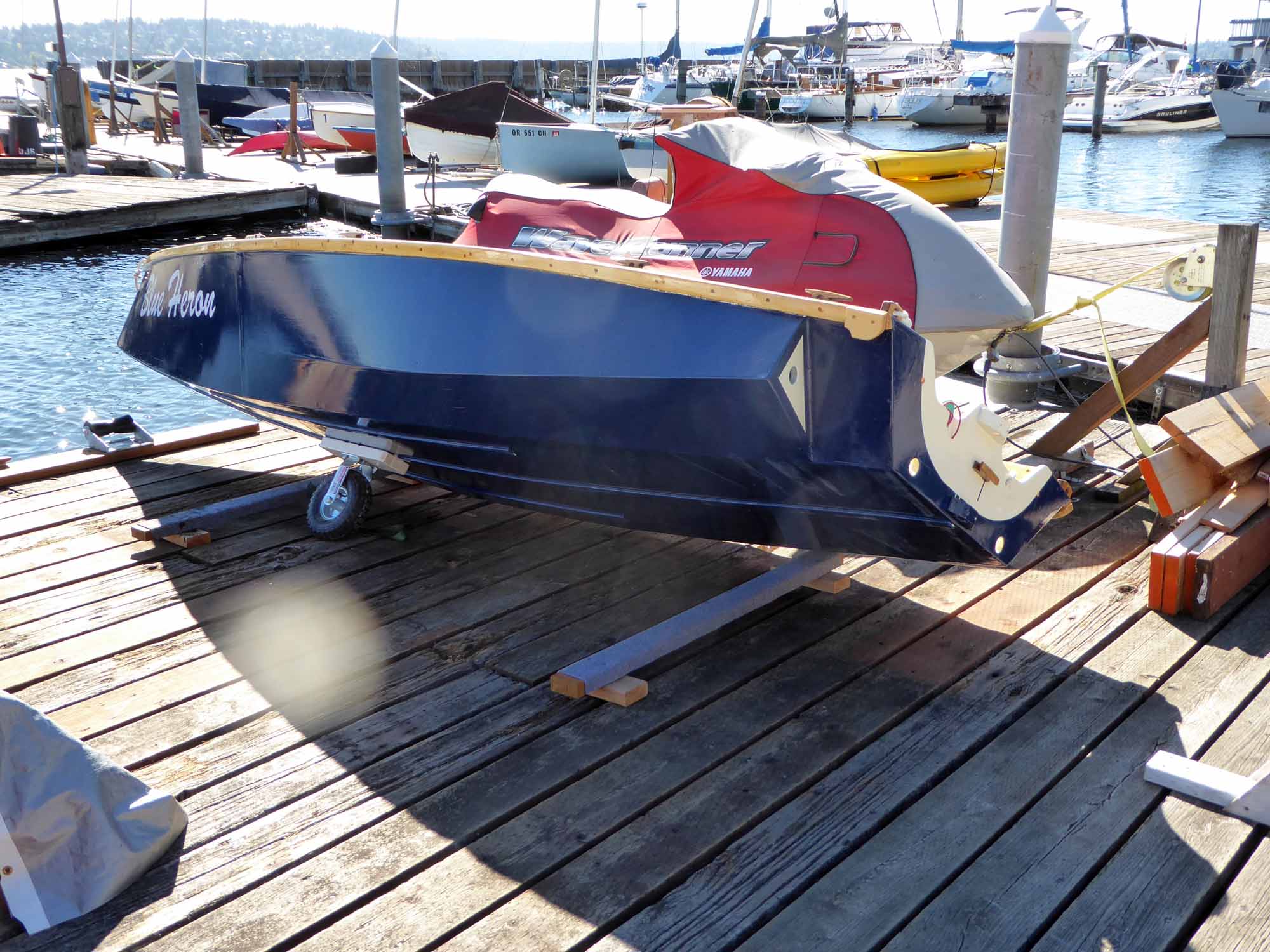

    First launch was in April of this year. Since then, Dunnage finished his Naiad and the two of us have had several outings on Lake Washington. We found a home at the Leschi Marina on one of their floats. Convenient and quite reasonable. Somehow we never got to sailing alongside each other or even race. Probably mostly because I felt compelled after each outing to go back to the shop for some major mods.
    I removed most of my centerline floatation tank to open up the interior for side to side movement. I added external hull extensions, essentially sponsons, to increase lateral stability which was almost non-existent on the Merlin-like hull shape. The pictures below show the evolution.
    I am now satisfied that I have a pretty well performing boat and look forward to some competition next spring.There is a good chance that a third boat may be joining us then.
    As for the $600 budget, I had no problem meeting it. But I made all my sails, blocks, cleats, fairleads and pad-eyes in my home shop. The only manufactured, non-lumber items are 5/16 hex bolts, nuts and washers, deck screws, cordage and wire.
  12. macbeath
    Joined: Jul 2015
    Posts: 51
    Location: Seattle
    macbeath Junior Member
    Why didn't you extend the stability sponsons all the way to the transom?
  13. Segler
    Joined: Apr 2015
    Posts: 43
    Likes: 3, Points: 8, Legacy Rep: 18
    Location: Issaquah/WA
    Segler Junior Member
    Three reasons:
    I limited the "fix" to the available, standard length of 8 feet for a sheet of plywood, trying to place it optimally.
    Hull geometry at or near the transom has little effect on buoyancy or lateral stability, because it is at or near the waterline, not below.
    I speculated, rightly or wrongly, that a "step" forward of the transom might promote planing. Seaplane floats are built this way.
