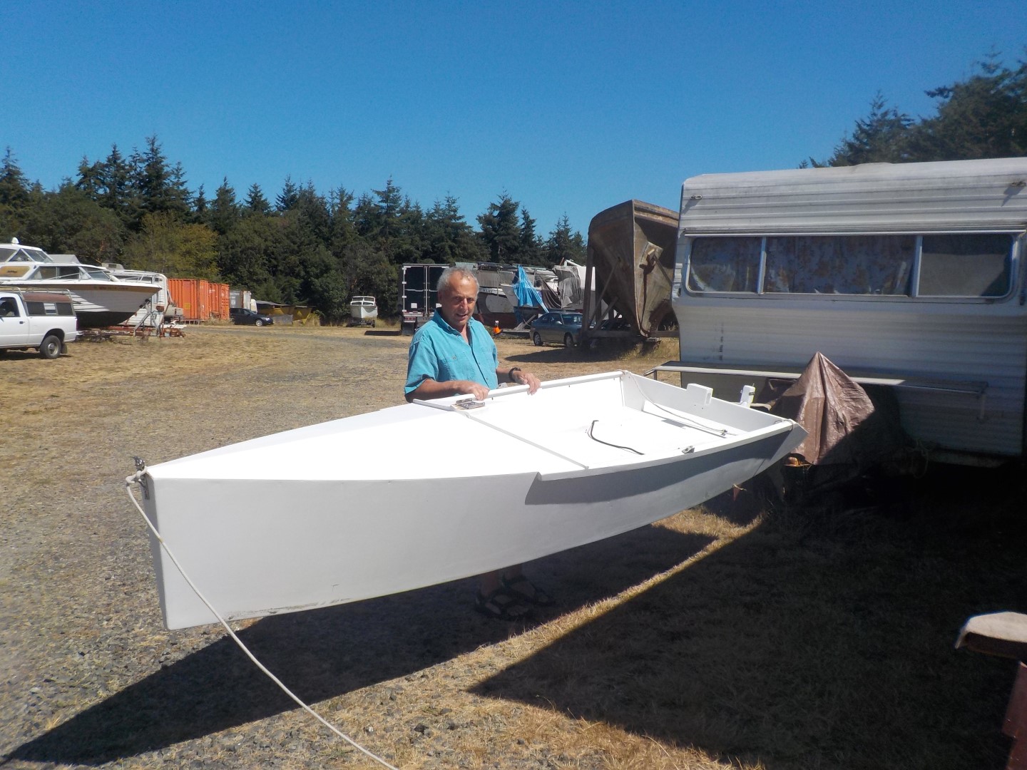

But no matter. Here is my attempt at a "hardware store" multihull
http://sailingcatamarans.com/index....-under-25/458-zeta-14ft-singlehanded-trimaran
7 sheets of ply, 3 x 3mm, 3 x 4mm, 1 x 6mm. I wrote before that I paid USD17 for each 3mm sheet and USD34 for each 4mm, and that those were 10ft x 5ft so I didn't need 3 sheets. All plywood is okoume WBP
Epoxy use is slightly complicated to work out, as the sheathing/coating epoxy doesn't count in the total cost. But I reckon we spent USD150 on epoxy and 2 rolls of glass tape. Wood came from Home Depot. For example, crossbeams are 2in x 3in, maybe cost USD20 including the fasteners. Shroud lanyards lash to beams, which are lashed to the hulls. No shroud plates.
Although not included in the costs, all the paint came from Walmart
Nothing bought new from West Marine. So it would be well under USD1000 even if I had bought a new 420 mainsail for USD179 from Intensity Sails http://www.intensitysails.com/pohemasafor4.html
It is a quick build. Petros will recognise the main hull as the Zest dinghy we built in two days at last years Edensaw Challenge (plywood sheets on Friday, I was sailing it as a skiff type dinghy on Sunday). I always knew I would convert it to a trimaran, so the Zest we built was narrower than the standard Zest dinghy.
It is also a simple build. The outriggers were built without using a plane for example. So no "sophisticated" tools used, like nail guns, routers, lathe etc
The photos tell the story. Light weight, obviously. Car toppable, ditto. Room for two crew or a 300lb box of lead(!) You may say "no its too small" but read this comment from a builder of my 10ft Tryst trimaran. "It works well for my larger body (105kg) and I have been out with my son (he is 95kg) and we never had a problem with swamping the boat. The wind was strong and the swells high on Lake Ontario." The Zeta is 40% longer so has plenty of safe carrying capacity and has a self draining hull.
It sails well, at least in light winds, see video here https://www.youtube.com/watch?v=AS7rgAbw9OU
It will be on display (finished!) at this years Port Townsend WBF Sept 9-11 and I will be racing it on the Friday.

Nice small trimaran.
As I can see it car tops reasonably well (with the amas trailing out behind the SUV).
But I think it would be most convincingly beat by a longer tri, even one with an 8 ft Beam limit.
Such a tri would be almost impossible to car top, but, who knows, with proper ingenuity it may be doable. I can already imagine two inverted ammas nested under the flaired sides of the upright main hull. Over all, the structure might be quite heavy, but the six or seven individual pieces need not be.
As for set up rules, perhaps it would be best to stipulate that the whole boat can be assembled except for the rig.
This stipulation would accomplish two things:
1.) It would penalize over elaborate stay systems, and
2.) It would make no effective distinction between a boat that is car topped and one that is trailered.
As I said on my FB page, we have no trailer or roofrack. Just carpet and rope. It would have been quite feasible to cartop the outriggers as well, had I made some roof rack cross braces, but it works as it is and why make work for myself. We only drive 10 miles down the road and I won't sail it again after the WBF until June next year as we leave the US on Oct 1st
