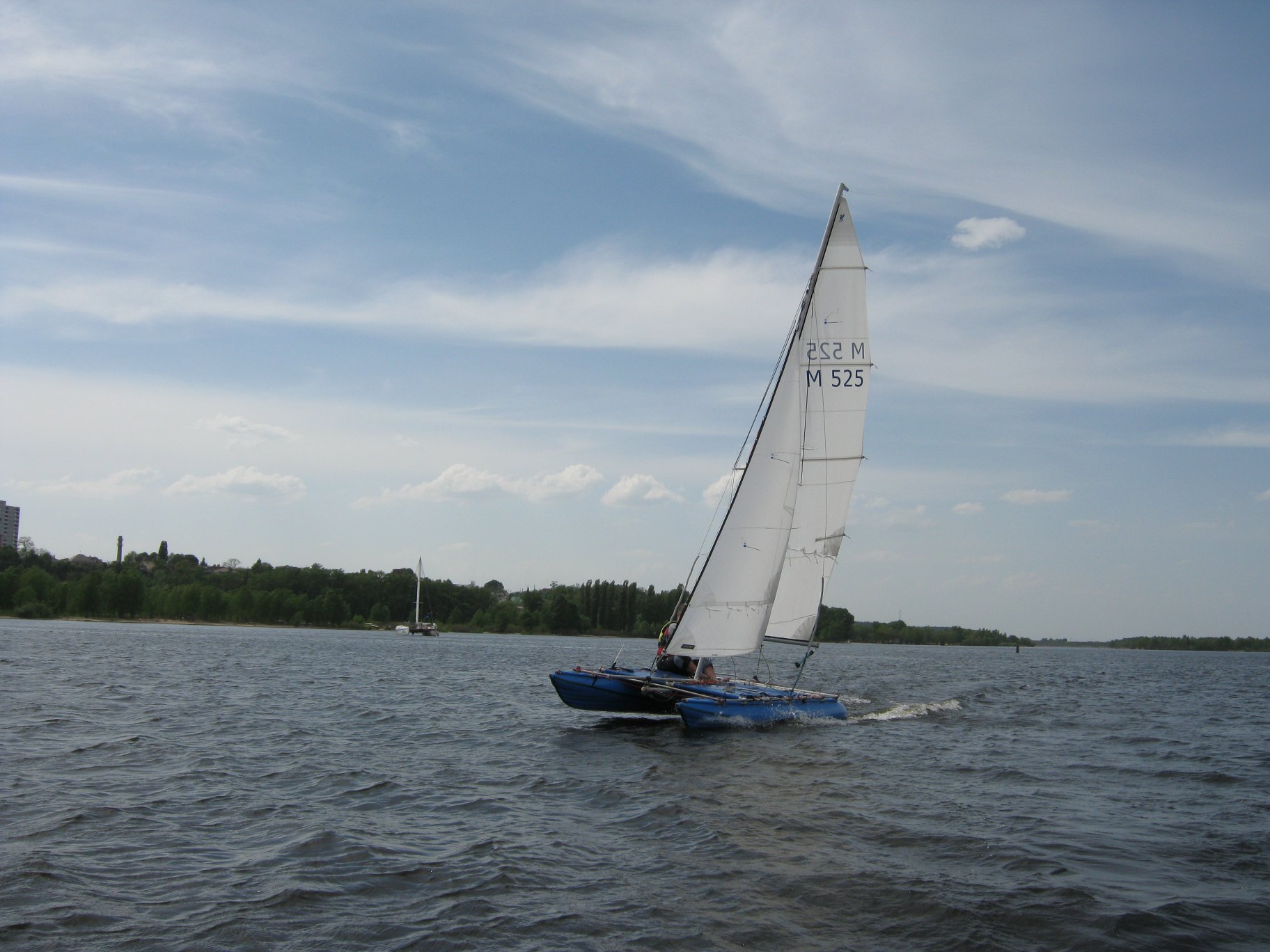

Or, if you in the ex-USSR, something like boat on the picture. Definitely faster, cheaper and easier to sail than Laser.
There's also nothing that will handle the typical weight of two adults that isn't a high-powered machine.
Hobie Wave or Getaway.
Yeah, you're right, the Dart comes close and I should have remembered it. If I recall correctly it's the second most popular cat in the UK, which may confirm that when the cat builders aim for that market, it's a success. The Russian cat in the pic seems to be a significantly more complicated sort of craft.
