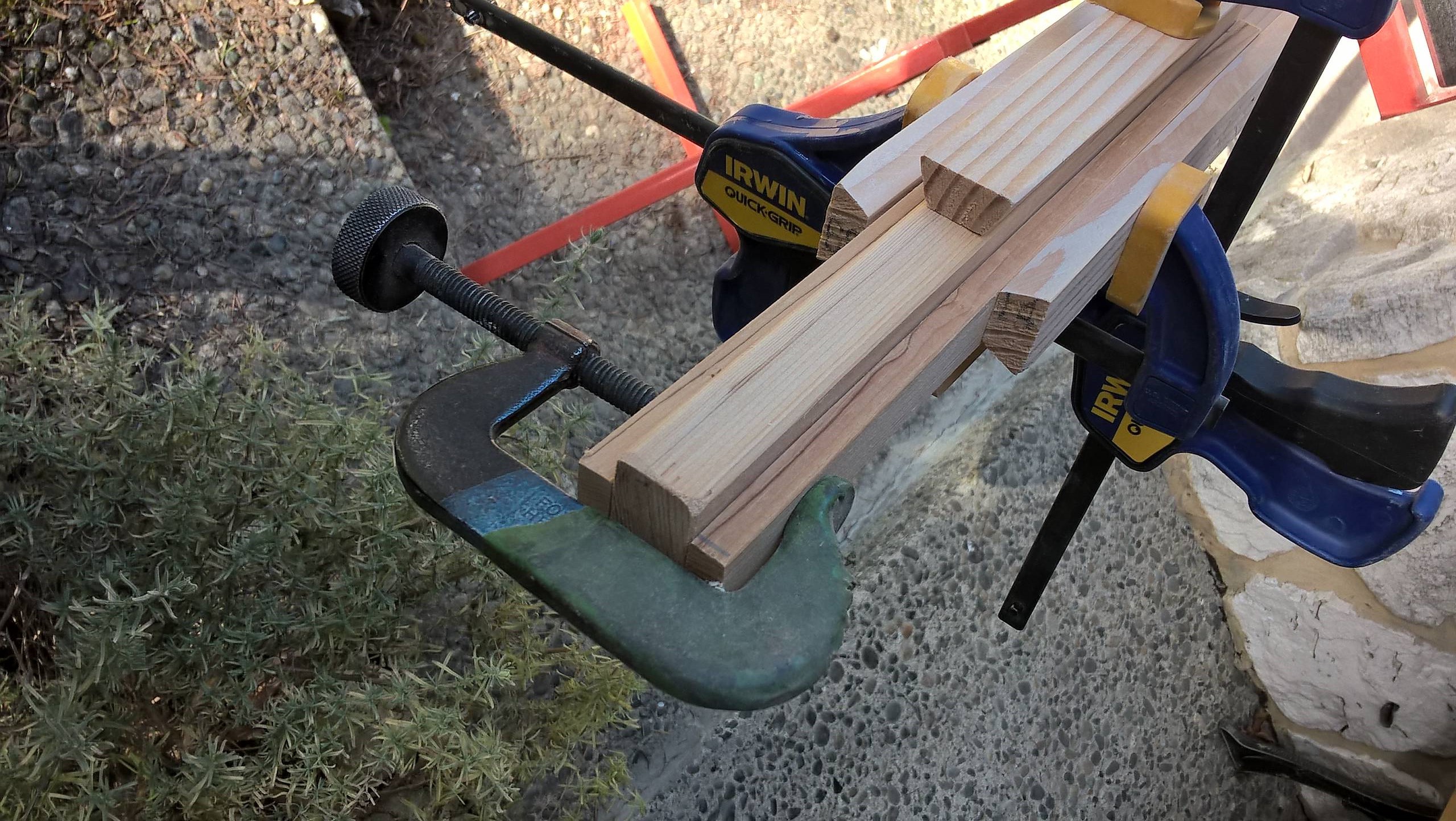

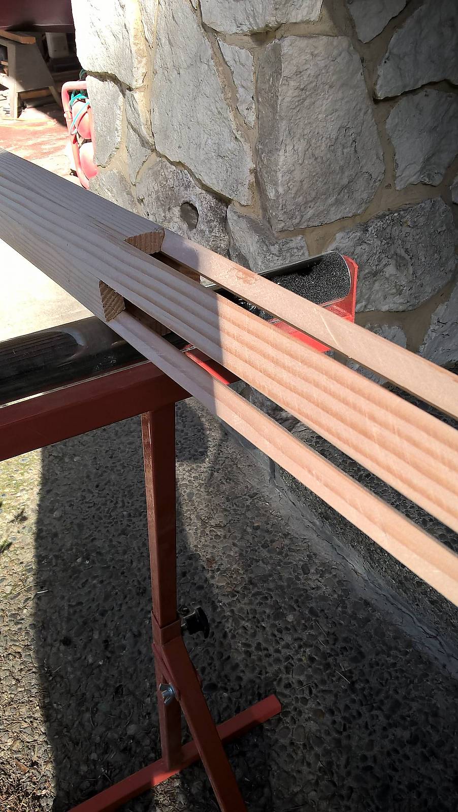

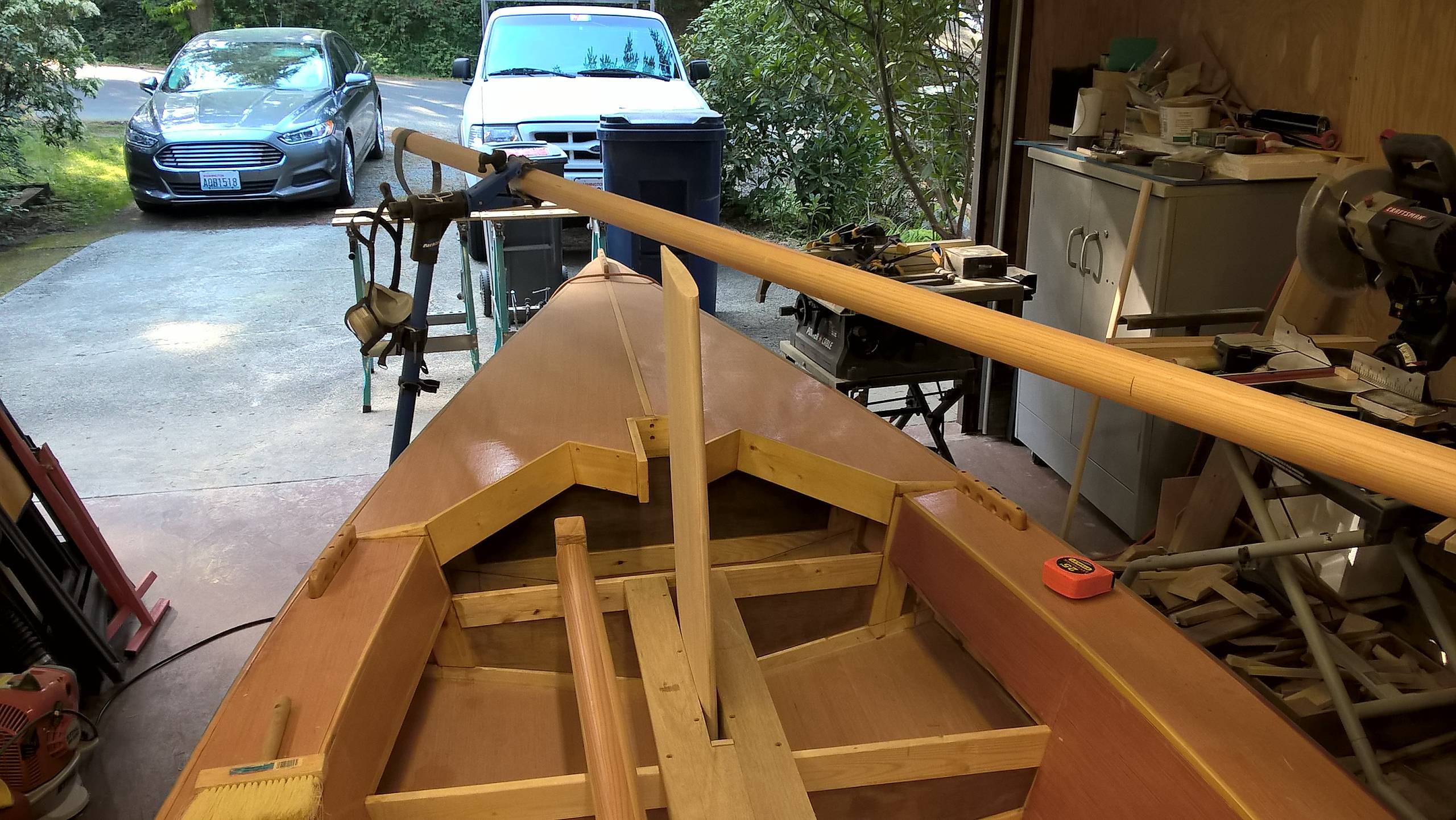

    Possibly Lowest Cost Mast Material
    (Apologies for the rotated pictures... they were right way up when I attached them but the upload put them the way it wanted...)
    The mast for Naiad is made from inexpensive hardware store / lumber yard 2X6's. (In the Antipodes, that would be 6X2 boards.) Our lumber is generally poor quality for the cheap stuff, but there is available poor quality boards cut from Douglas Fir at only a few percent higher price. I selected flat grain boards. No one wants them since they 'cup' as they dry, so the picked over pile of boards usually contains a few of these that are almost knot free. The cutting plan for the mast has me ripping the boards into 5/8" strips,; so the usable strips are clear and have vertical grain. The strips are then run through the table saw again, twice each, to put a 22.5 deg. bevel onto the 'sides'. This makes the strips trapezoidal with a 1.25 inch base and a 5/8 inch thickness with 67.5 deg. angled sides. These fit together to make an octagon that is 2.25 inches diameter. (First Picture) I made the mast from eight strips cut from a 14 ft. board and eight strips cut from a 12 ft. board. There is one splice for each strip. Four strips are spliced with an internal plug at the 12 ft. height and the other four at the 14 ft. height. The strips are interleaved so that the lap splices take every other strip. (Pictures 2 and 3)

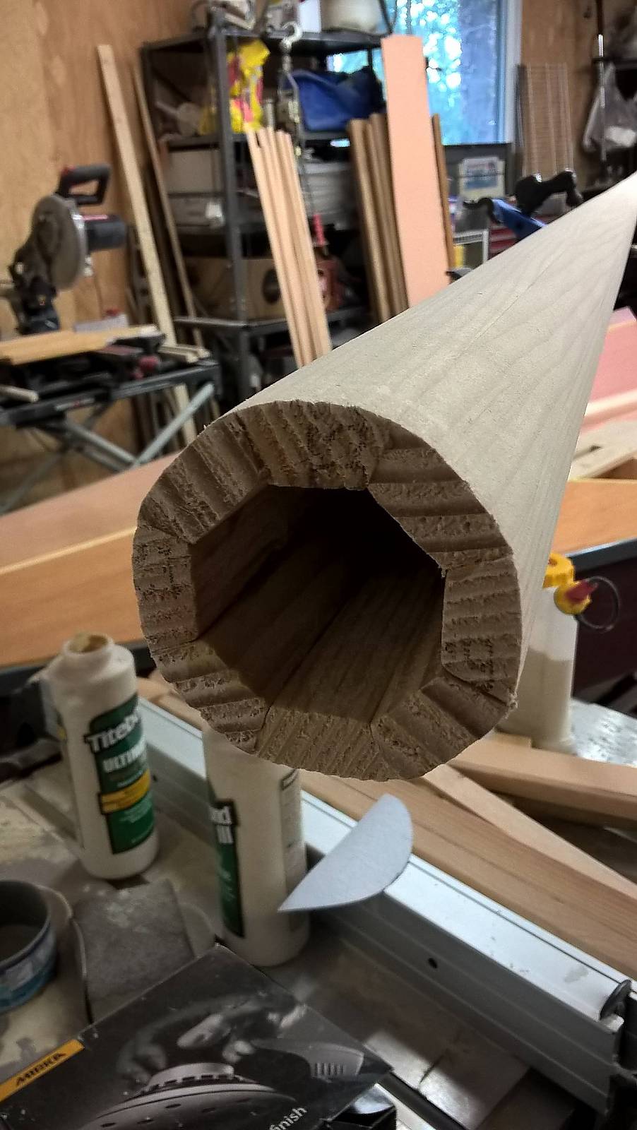

    The final glue-up is a 22 ft. long octagonal mast. I shortened it to 21 ft. and sanded it round. it weighs just under 15 lbs. (Picture 4)
    Gluing the octagon from the eight strips required laying them out on lengths of duct tape, applying a lot of glue to the edges, rolling the strips up like a sushi roll mat and taping in place, and then putting a bucket full of 2"-3" screw type hose clamps on, one every eight inches (about)... and clamping it down tightly.
    Rounding the finished assembly involved knocking down the corners with a block plane to get it approximately round and then sanding it round with the tool shown in the pictures (Pictures 5 and 6) ... the abrasive is six inch round adhesive backed 80 grit sandpaper. Fine sanding can easily follow since the sort-of-Velcro backed sandpaper rounds stick pretty well to the 80 grit paper in the tool... or you can use fine grit adhesive paper.

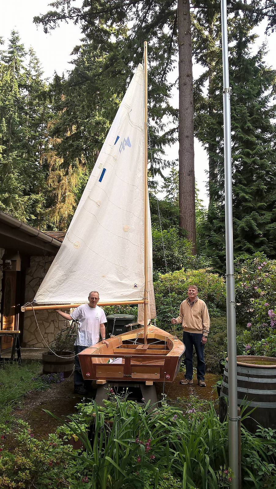

    Finished mast (and boom, and the rest of Naiad) in Picture 7.
    If you want to be pretentious you could call it a Linear Cellulose-Lignin Composite Mast ;-)
    Total cost: Under $20 U.S.D. (but it did require a few hours... at least.)
