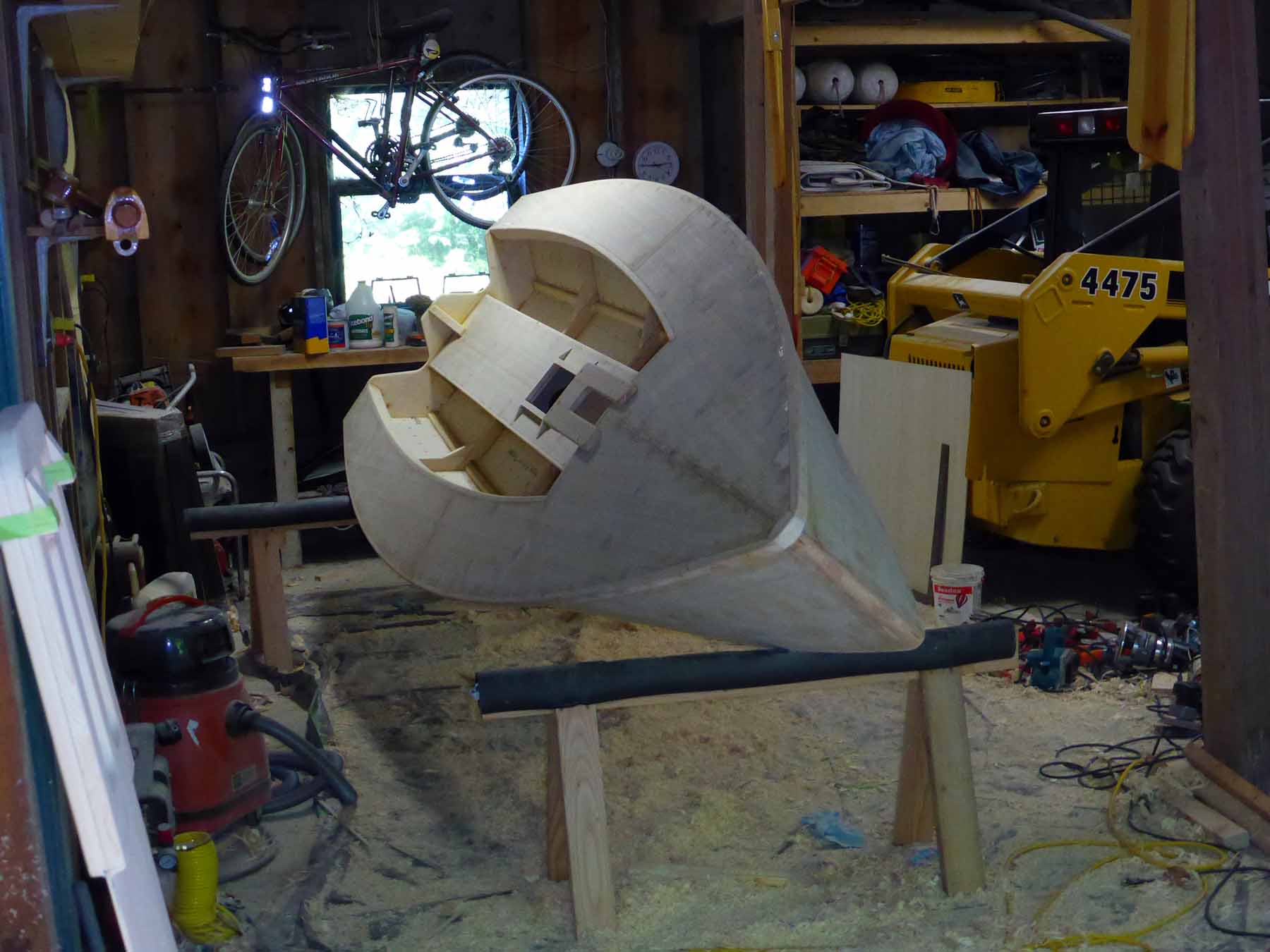

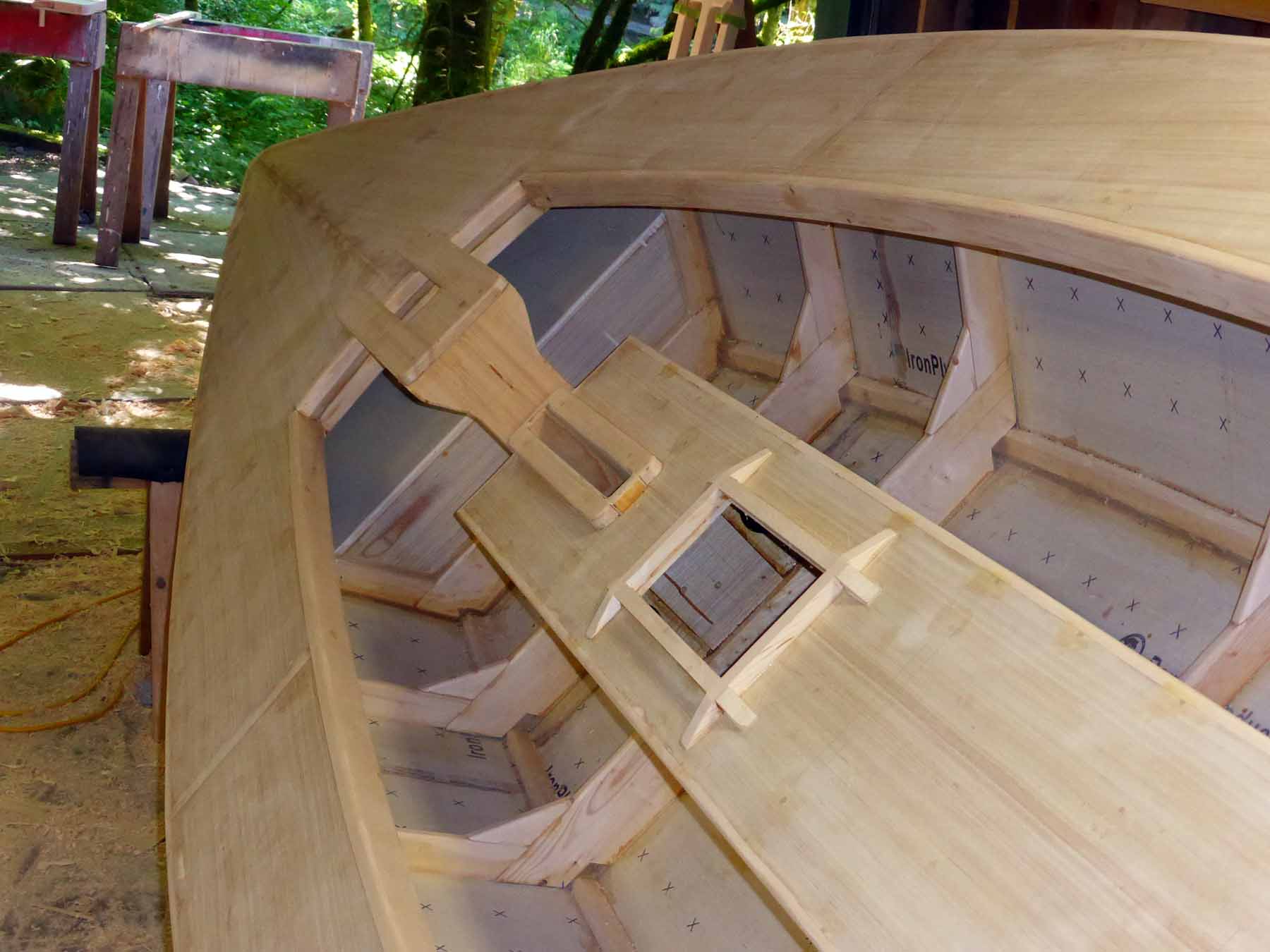

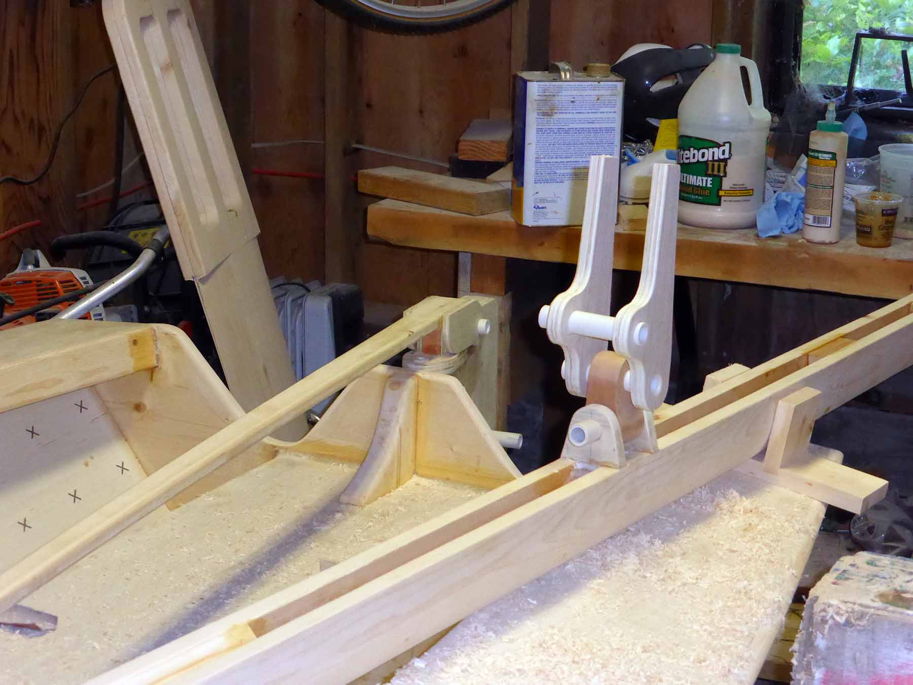

    I am well past the "proposing" stage and really at the "almost done" stage. I started building in early March to the, then, existing set of rules. I think, I stayed well within them. You can "interpret" forever but at some point you just have to make up your mind. I'm not terribly concerned about fine points, like how you hang the rudder. Gantry-schmantry. I am more concerned about the whole thing coming down on top of me when I first take it out on the water. Hopefully without witnesses. Five o clock in the morning.
    I am done building my hull, mast (wood, 19 ft, 21 lbs), boom, centerboard, rudder stock and rudder. I have made a bunch of blocks from plywood scrap. I am about to make the sails out of white poly tarp. So, sails and rigging left to be done. No idea how long this is going to take. Maybe to the end of July. I'm traveling in August, so September may see my maiden voyage. In due time my two cohorts will join me with their builds. We will see where it takes us.
    I think this thread would be more useful focussing on low cost building methods and material resources than forever refining the rules. Or, maybe there should be a new thread devoted to actually building.
    BTW, my entry for this contest has been named. Henceforth it will be known as the BLUE HERON.
