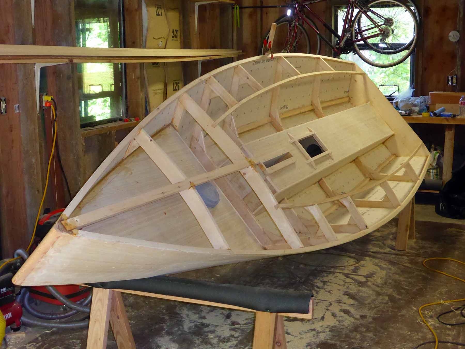

    This is my posting debut on this thread.
    I am one of the "builders", inspired by Sailor Alan to participate in this effort. It did not take a lot of arm twisting. To an engineer, sailor and amateur wood worker, it's more like a dream come true. And the hardware store aspect only adds to the attraction.
    I have been at it since early March, two months into it. I am attaching a photo which shows the state of progress as of today. Be happy to show more building history if anyone is interested.
    Building materials are 5mm "underlayment" plywood and 3/4", #3 pine.
    I estimate I will be afloat and asail maybe by July. No promises. I hear there are some people who can do all this in three days at Port Townsend. So amazing.

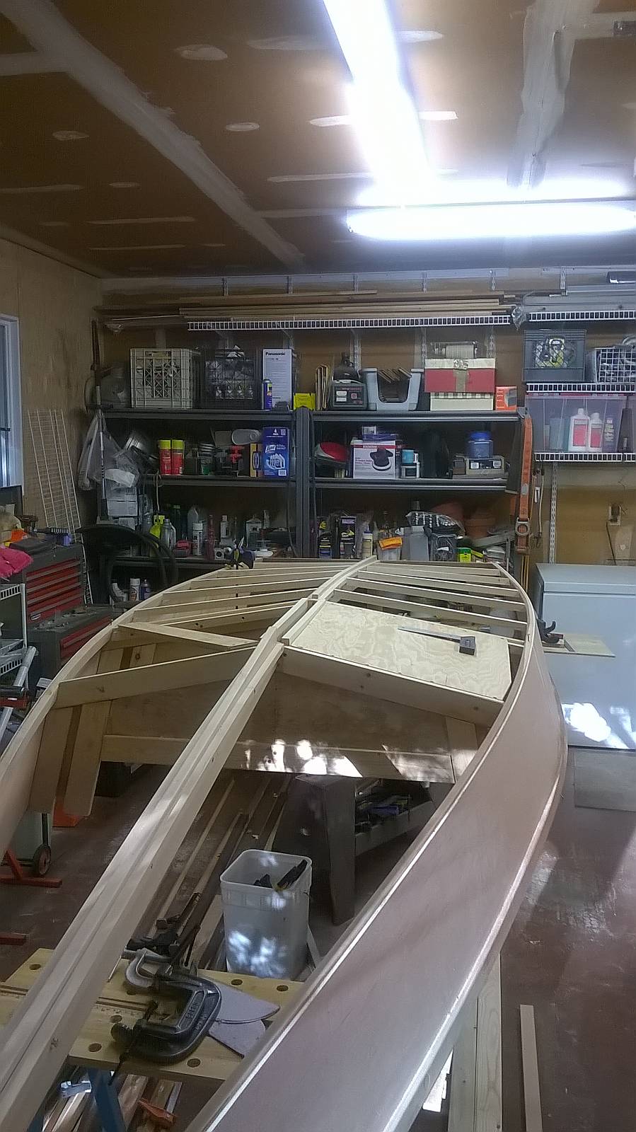

    How does one get a hull number for the class? Is it in order of the request? and how does one make a request? Or is it in order of completion and registration? Which, of course, begs the question of 'registration'.
    My dinghy is also under construction, though less than half as far along as Siegler's. A photo is attached. Note that the hull is shown with the bottom side up; which may be entirely appropriate considering all data from my extensive experience with dinghies ;-)
