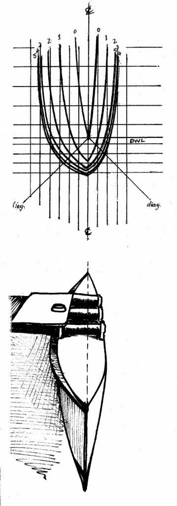

    Hello,
    I have a client wanting me to produce a hobie-cat with a very different hull design. Take a look and tell me what you think.
    He is a boat designer but, I have never seen this before.
    He designed the bottom of the hull after the sailfish. One the he built in 1958 "never lost a race".
    The designer is Dough Harrison

    I guess you mean "beach cat" not Hobie cat??
    Well - if you are a boatbuilder then take the money and build it. But you won't build a second one.
    if you are the customer/owner/sailor then no, forget it

    Richard called it perfectly. If you are the builder then build it, but be sure that you get all your money first. This "design" has the potential for causing you untold grief. It will be the builders fault when the boat turns out to be a dog.

    The shape isn't defined by the drawing, but it looks like a flat bottom with waves ? I wonder what the rationale behind it is.

    JHF, I never saw a waved bottom like this. But the coke bottle form is well known in aerodynamics to make a better flow at the root of an aeroplanes (Jet) wing. Harmen Hielkema used it on one side of his proa: http://harmenhielkema.blogspot.de/2009_04_01_archive.html and http://harmenhielkema.blogspot.de/2010/09/answer-to-good-question.html and here another Proa http://www.proafile.com/archive/article/a_proa_for_ariadne. And please have a look at: http://www.boatdesign.net/forums/mu...new-multi-50-trimaran-46659-2.html#post622246. Would be interesting to do some tank tests, to find the lift and sucction areas and might be the benefits or the nonesense.
    It must be a newer design than 1958 because the plan shows infos like: "Chopped carbon and epoxy". Interesting asymmetric boards.
    Any more infos about the design of Douglas Harrisons catamaran ???

    Submarines, like fish, travel underwater so don't make waves. Norman Cross used the "coke bottle" hull shape in some of his trimarans. He was also an aircraft engineer. But I thought it was all to do with the large wing area/volume and fairing out what would be a SAC if it were a boat hull.
    Apart from the hull shape I'd worry about the central daggerboard, the massively raked rudders and the weight

    The coke bottle shape thing is the "area rule" and used in very high speed aircraft to help manage the transition zone at the sub/supersonic barrier. The area rule has been in place since its discovery in the 50's on high speed aircraft, but is of dubious value in considerably more viscous fluids and much slower speeds. If well shaped (the big key) at S/L ratios of 1.5 to 2.5, it can have some usefulness, but a well designed beach cat can easily exceed these speeds with more conventional shapes, so why bother with the wavy bottom.

    the "area rule" used in supersonic aircraft is not translatable to boat hulls, water is not a compressiible fluid like air, and as pointed out, a hull travels on the surface.
    It is a complicated issue to explain why "coke bottle" aircraft fuselages have less drag at super sonic speeds, due to the compressablity effects of air, and it does not translate to a boat hull.
    It is a really bad idea in a boat hull. I worked for many years in the past as an aerospace engineer doing aerodynamics on military aircraft. Please take my word for it, it would be a waste of time and money to try it on a boat hull.
