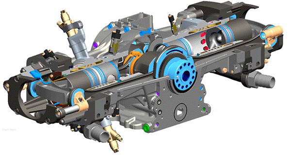

    OPOC Diesel Engine possibilities
    Interesting new OPOC diesel engine subject brought up by the same contributor
    http://www.yachtforums.com/threads/new-diesel-outboard.24899/#post-218278
    http://www.ecomotors.com/ click on engine image on opening page of their website for a motion animation

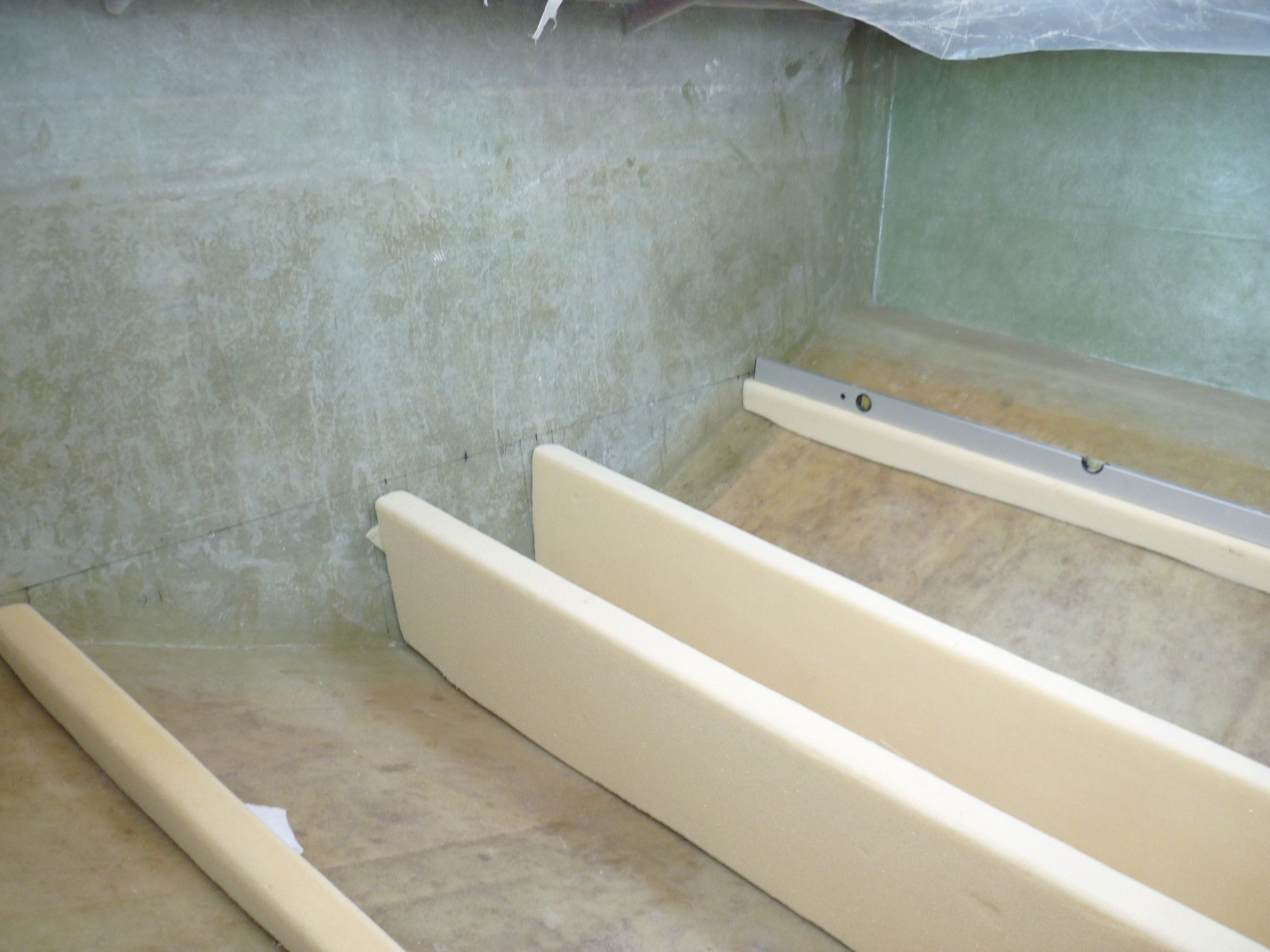

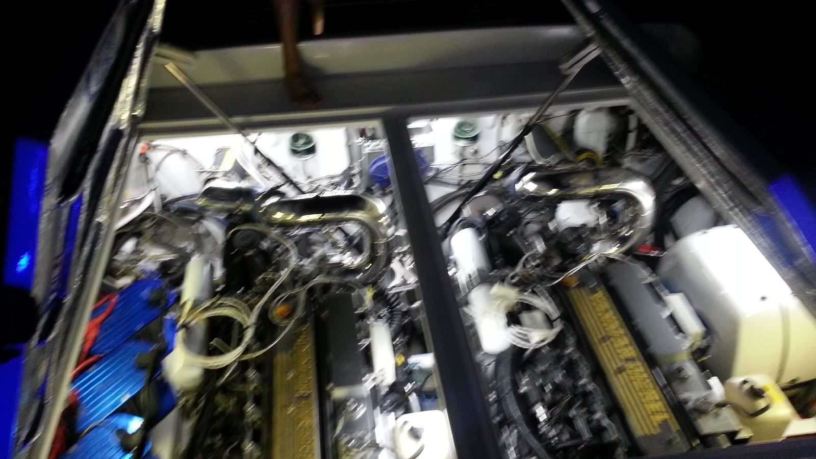

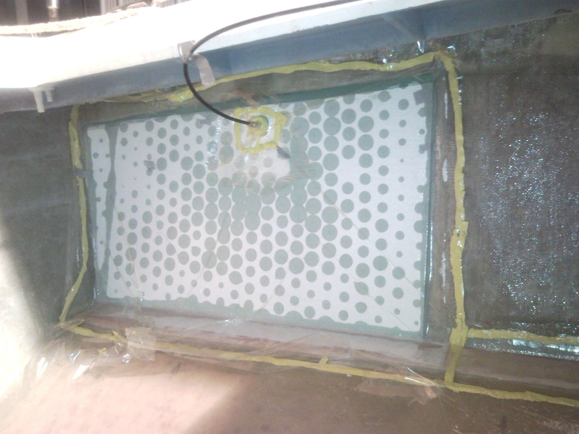

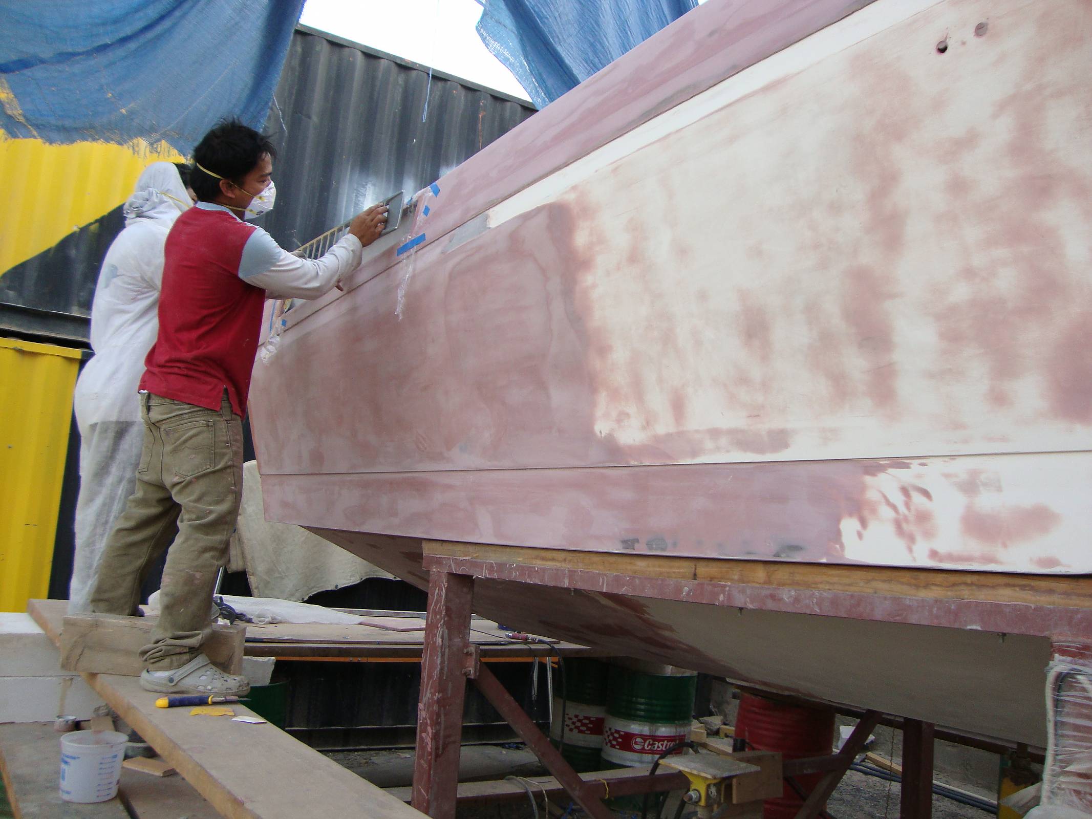

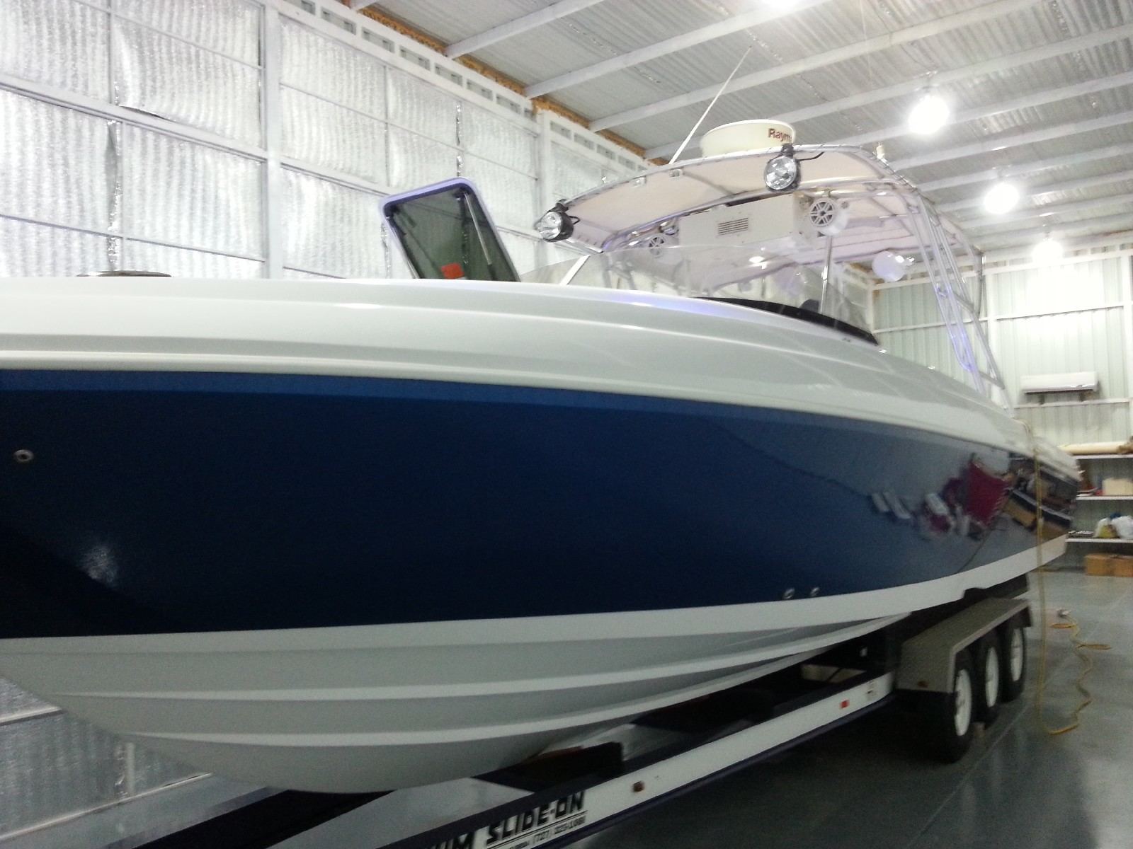

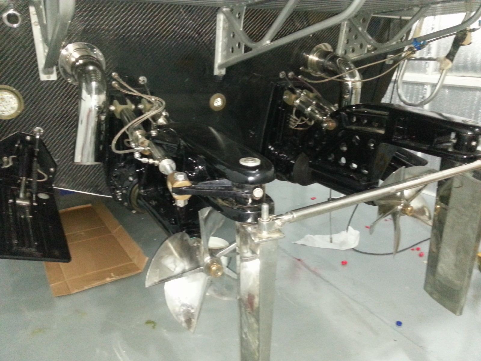

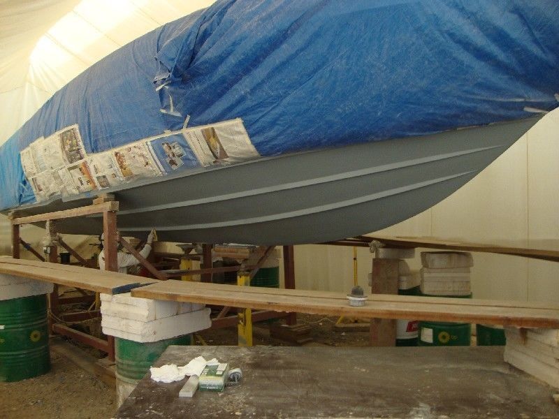

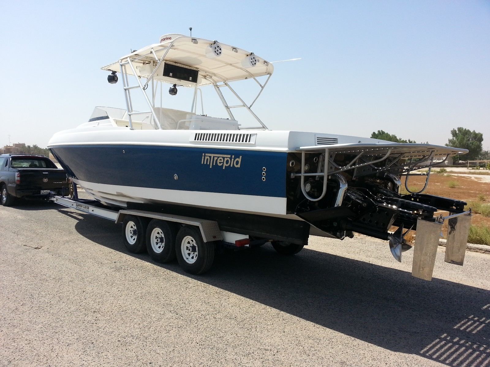

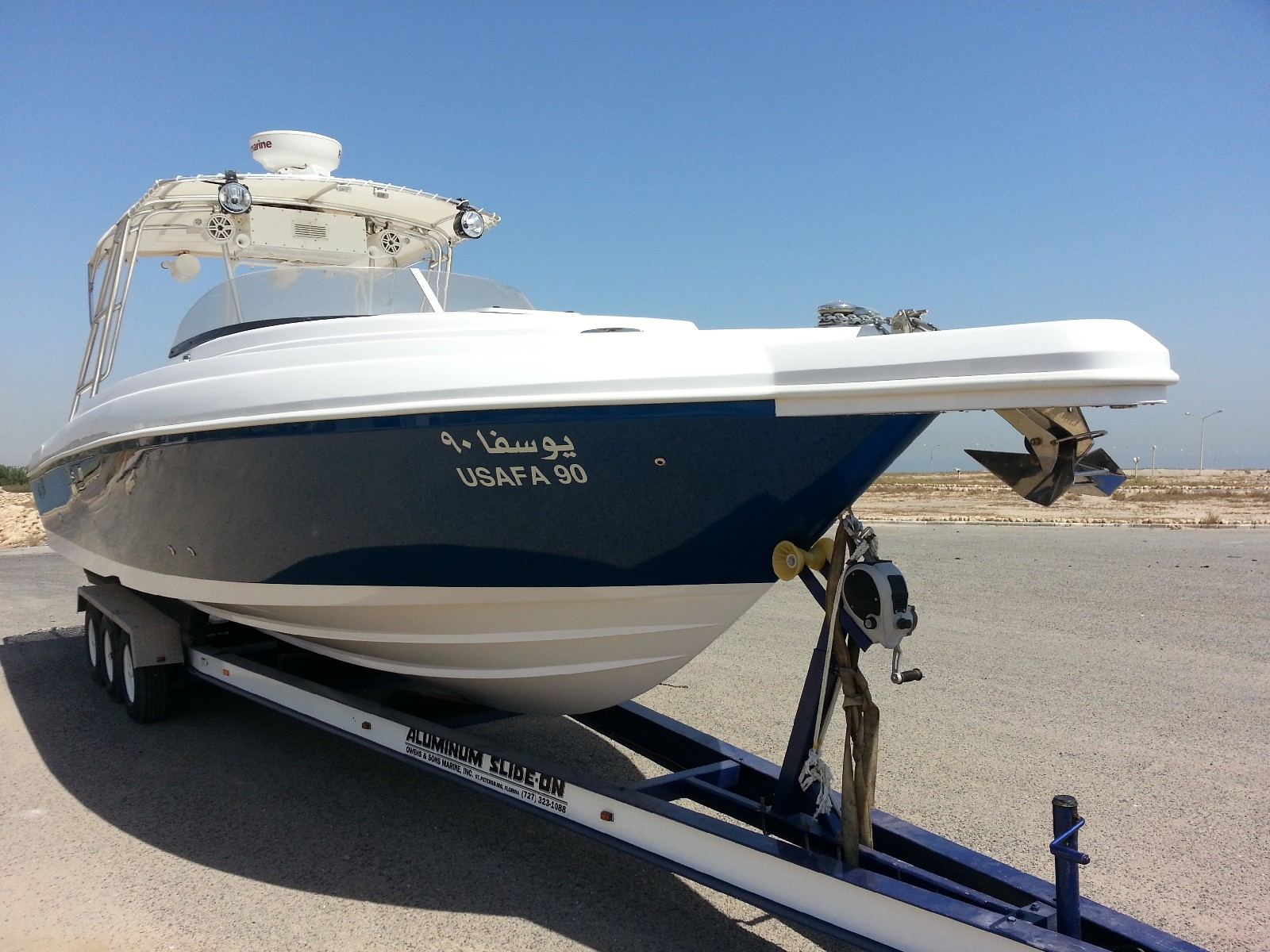

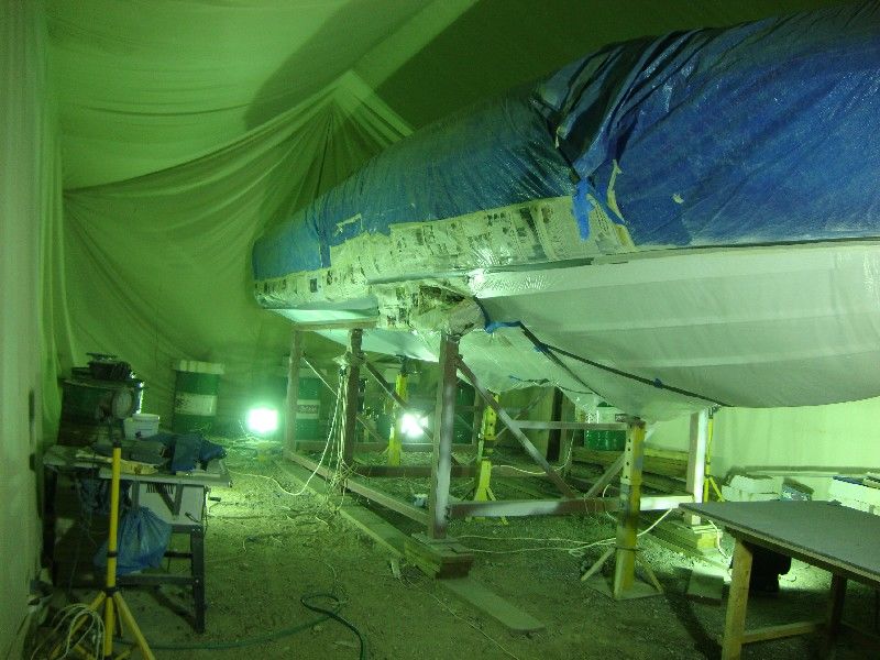

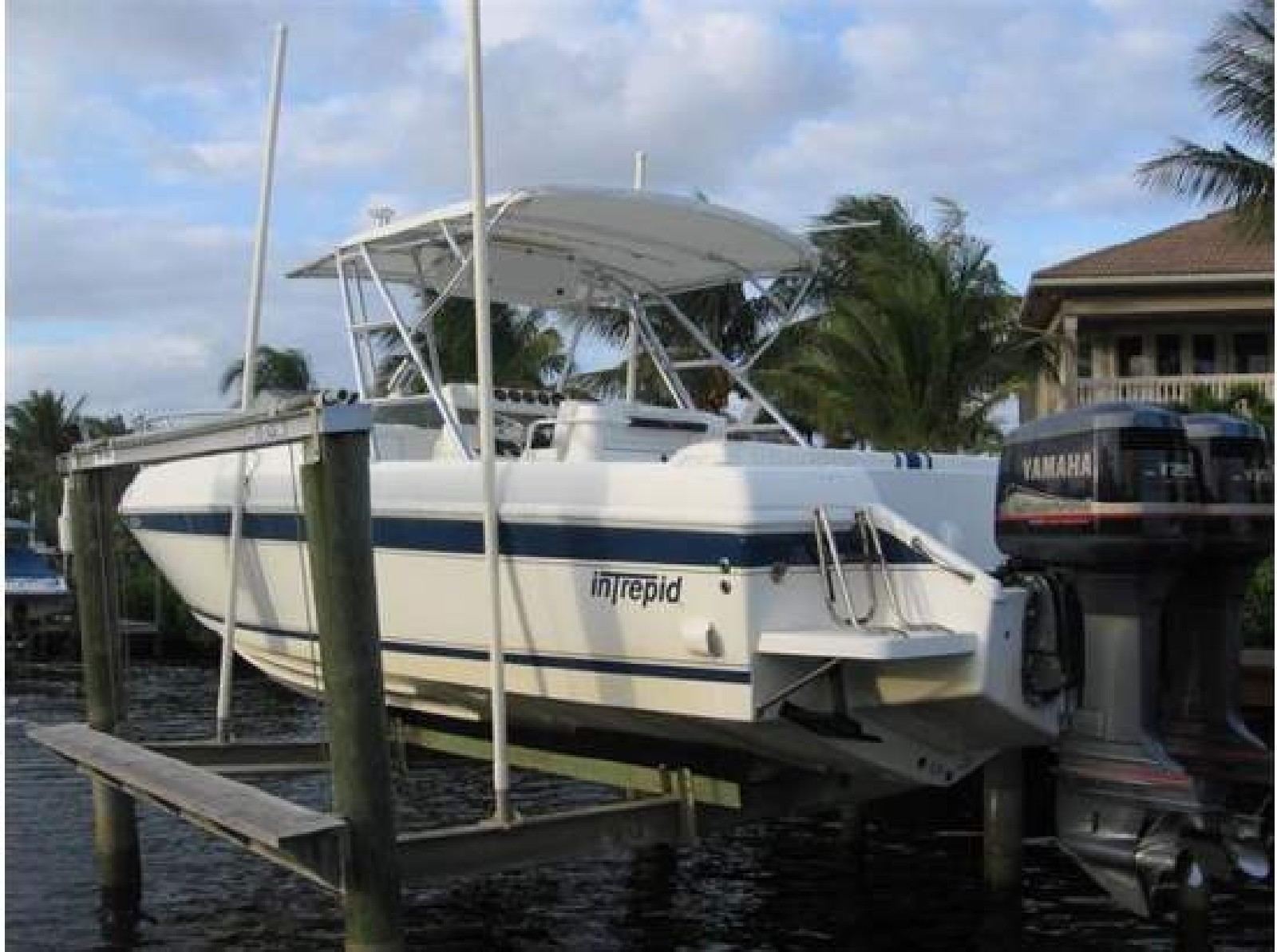

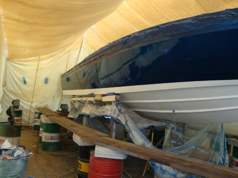

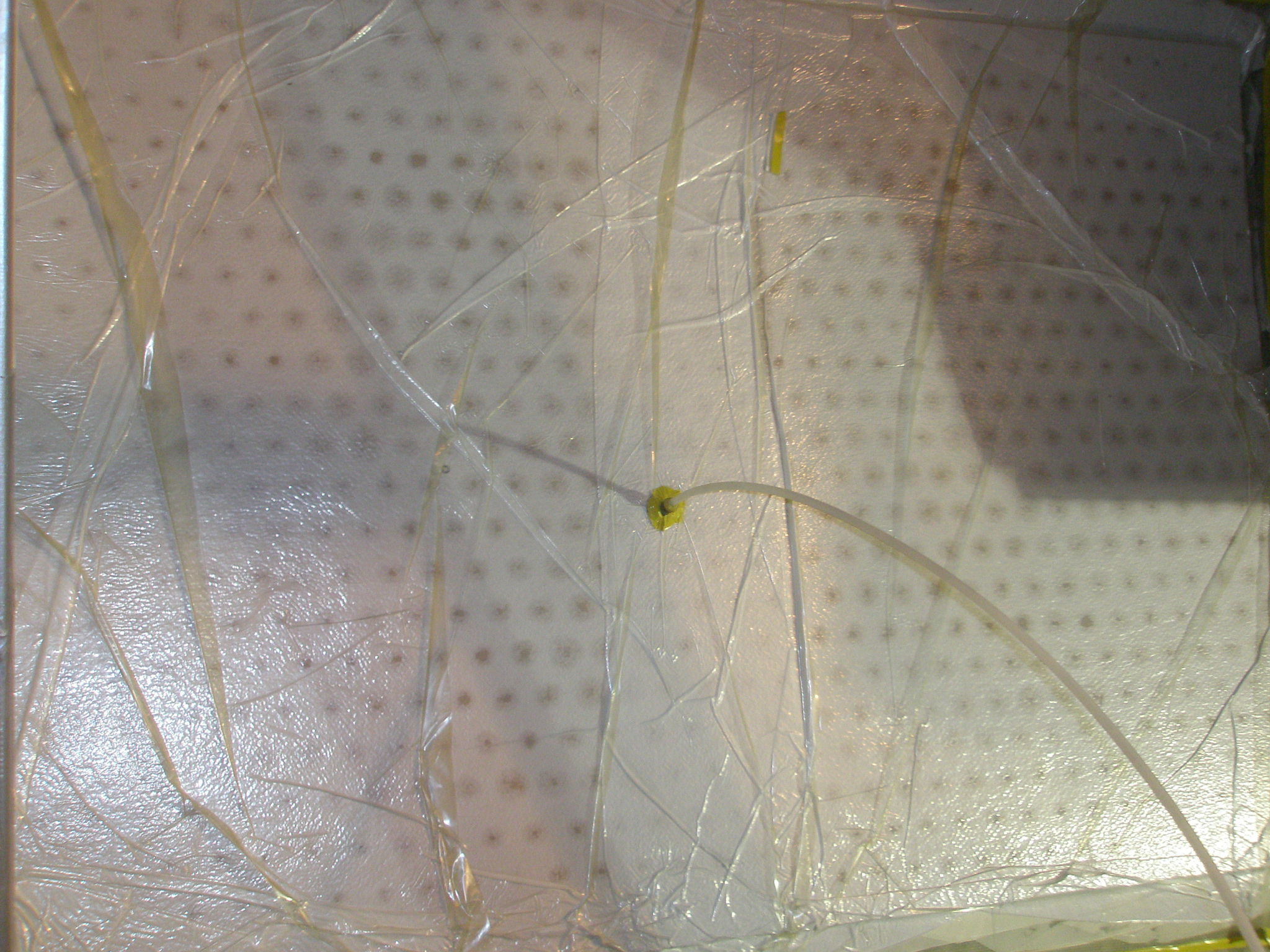

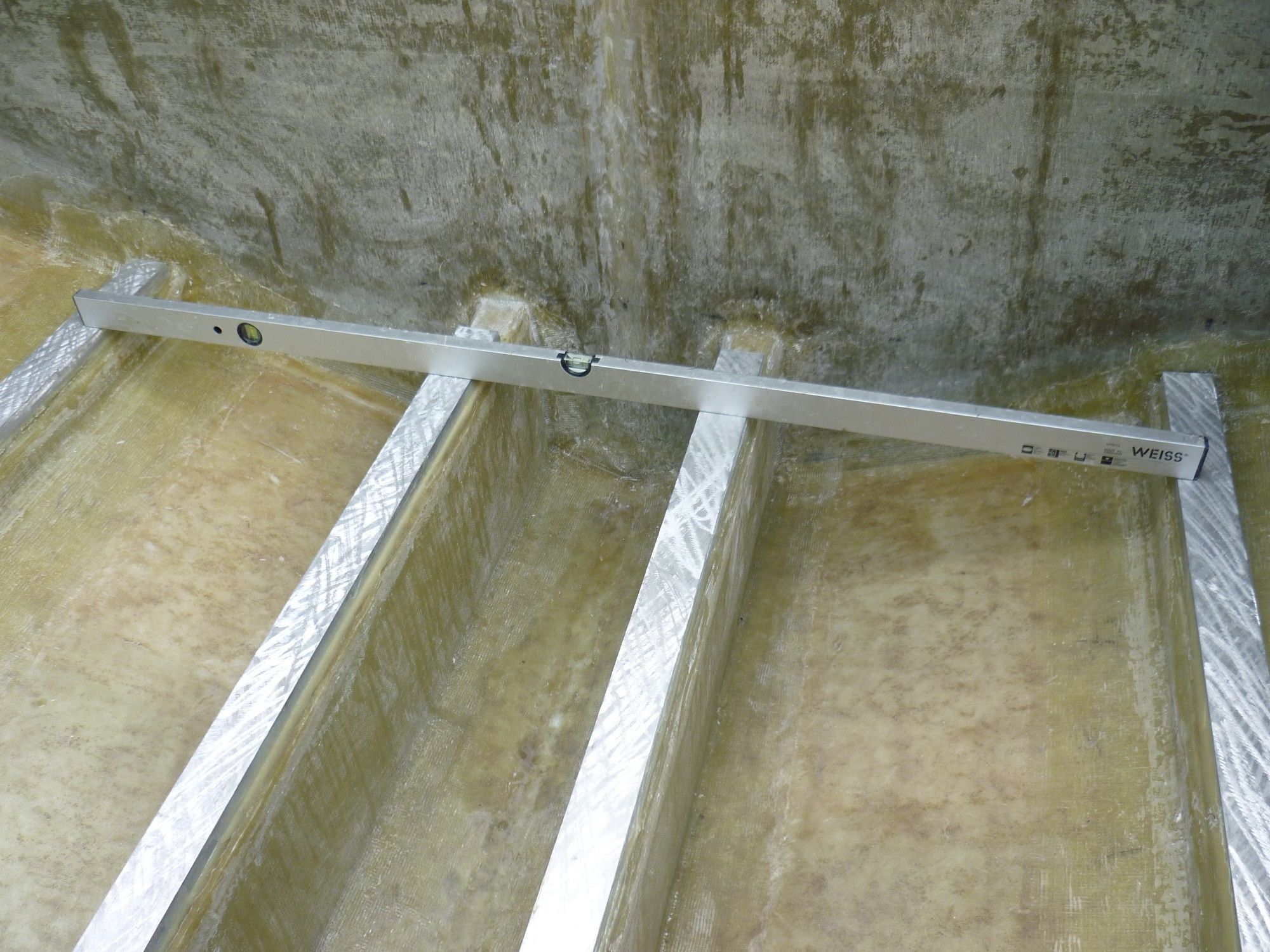

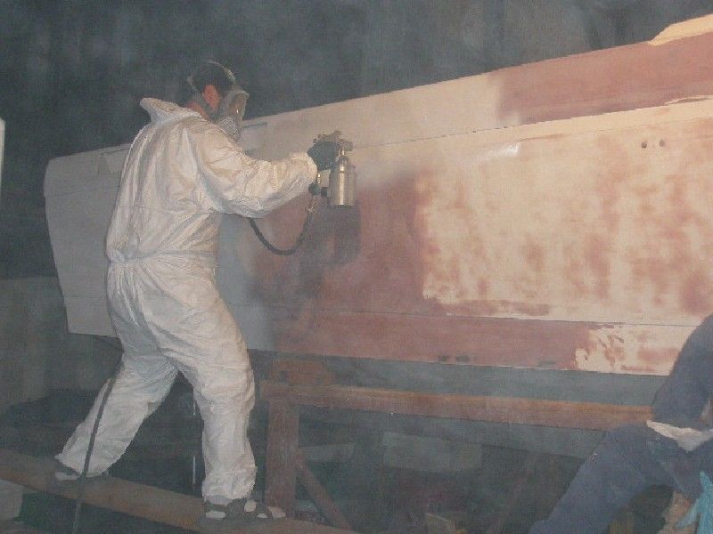

    Conversion of Outboard to Inboard Deisel
    I converted an Intrepid 339 twin outboard to diesel inboard with surface drive. Its a pretty straight forward build, just need to be accurate on geometry and use resilient construction methods (i.e. Epoxy, Biax, vacuum bagging).
    It went from: 33.9' to 38.5'
    Twin 200's to twin Yanmar 6LY2 tuned and dyno'd to 454 hp.
    Two speed gear and surface drive with Rolla Props
    44 Knots first gear, 52 Knots WOT second gear
    https://www.youtube.com/watch?v=E4l4ATbv-Eg

    Interesting, .....bet that wasn't a cheap conversion !
    I have a friend with a boat with a similar power train.

    that design has lots of advantages and there are other engines out there under development as well
