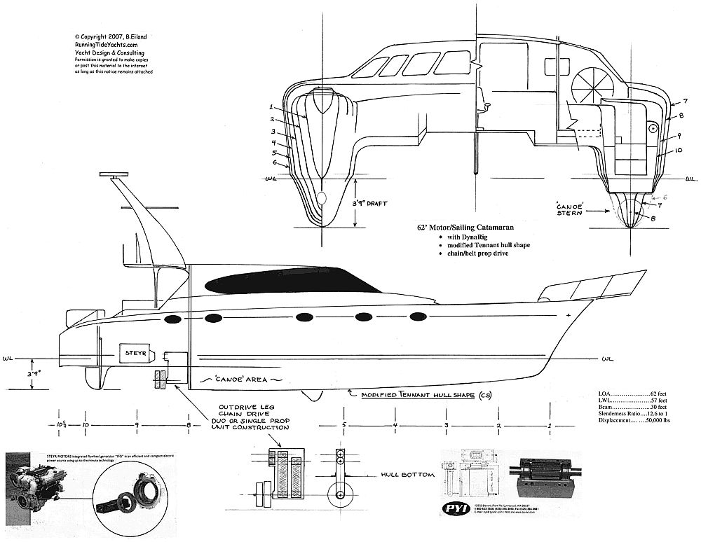

    brian eiland Senior Member
    Chain Belt Drive
    My guess is they will end up using a 'silent chain' arrangement. This is a subject that has interested me for years. If you googled my name & belt drive, or chain drive, you would likely come up with a good number of hits. Regrettably there was a nice long subject thread on this subject over on Yacht forums, but when they made some recent software changes it got omitted.
  14. brian eiland
    Joined: Jun 2002
    Posts: 5,288
    .....from that same discussion on this forum
    http://www.boatdesign.net/forums/newreply.php?do=newreply&p=453139
    Couple of more postings of interest
    http://www.boatdesign.net/forums/inboards/belt-drive-37290-3.html#post453264...with photos of PYI's system
    Slient Chain FAQ's
